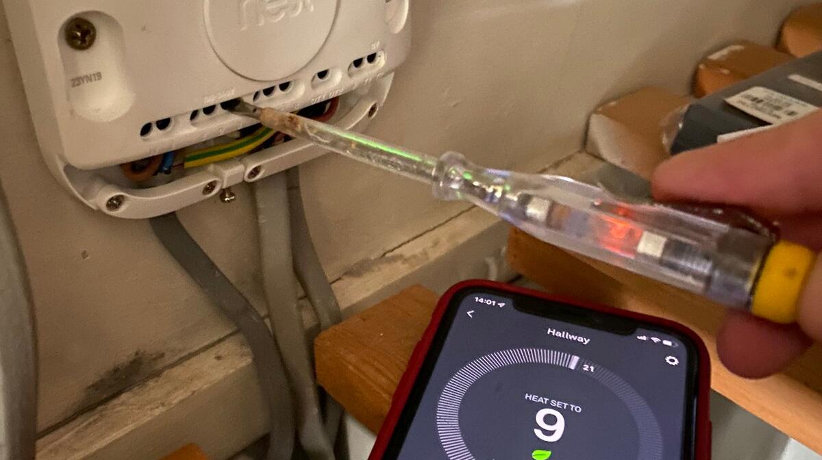

Unless I've missed something, as I understand it:
The problem the OP has is that whenever he turns the power on the heating comes on regardless of the Nest heating control settings. ie if the heating is required or not, it comes on, and the CH On from terminal 3 of the Heat link remains permanently live, even if he manually turns the heating off at the Heat link button.
As far as I can tell the hot water is working as it should when the heating is running, which in this case because of the fault is permanently.
Removing the wire from HL 3 simply removes the live from the MV white wire which stops the heating coming on, as would the HL if it actually turned terminal 3 off.
Not sure I explained that very well :confused:

Sorry, I’m still learning electrics side of my job too, so it seems that the heat link is faulty?
Yes, terminal 3 of the Heat link should only be live when the Nest switches the central heating on. It moves the motorised valve to the heating position via its white wire.
In this case terminal 3 is permanently live, so the valve remains in the heating position and is permanently 'on'. Removing the wire from 3 simulates the Heat link switching terminal 3 'off' and the heating goes 'off'.
Unusual fault, I've not come across it on a Heat link before. I have found it on other programmers where a short circuit has occurred and has welded the heating contact together inside the programmer so the heating is permanently 'on' but the OP says that hasn't happened.
  • Thanks
Reactions: CBW
The problem is we don't know if line. This upload_2021-10-25_15-22-59.png shows there is a potential difference between his thumb and the terminal, but we don't know if the relay is open or closed.

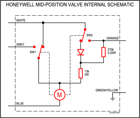

If we look at the wiring of a mid position motorised valve mid-position-valve.jpg we see there are numerous paths current can take, and only showing one make of motorised valve. Using a meter and reference to neutral we can seen if volt drop across resistor or diode and we have a chance. But a neon screwdriver is a great tool to identify when we have borrowed neutrals, or any other reason why power returns while working on some thing, but useless as a test meter.
I remember working on daughters Y plan, and I was really scratching my head, at that point I did not have internal plan of the valve, and it turned out one of those micro switches had stuck, also had problems with Nest Gen 3 with boiler firing up when no heat called for, which was simply the anti legionnaires software kicking in.
So you have 3, 4, and 6 output from heat link, 3 connects to white on motorised valve, 4 connects to grey hot water off, and 6 to orange boiler run. Colours are wires of the motorised valve, no other colours can be trusted as correct.
So Grey does nothing unless white is powered, if white is powered then it makes the valve go all the way over so no DHW, and Orange is an output. For DHW only the motorised valve is at rest, and the orange is made line direct from the tank thermostat.
White (3 on heat link) is connected with a resistor and diode to orange (6 on heat link) so if the boiler is running due to DHW being on, the white will still likely have enough power to light a neon, however it is likely less than mains voltage how much less depends on the ohms per volt of the meter being used.
So remove the wire in 3 of heat link and put in a connector block to keep safe, and then test output of heat link. Even a table lamps with tungsten bulb is better than a neon screwdriver, the neon screwdriver uses so little power.
The Nest Bacterial Prevention function switches on the hot water, not the central heating. An Icon on the thermostat display shows when it's operating.
I agree about the mains tester screwdriver being a poor tool. A multimeter would be my weapon of choice. However as the motorised valve synchronous motor requires AC mains voltage to operate and wind it across to the heating position I think we can be fairly confident that's what is present on terminal 3.
