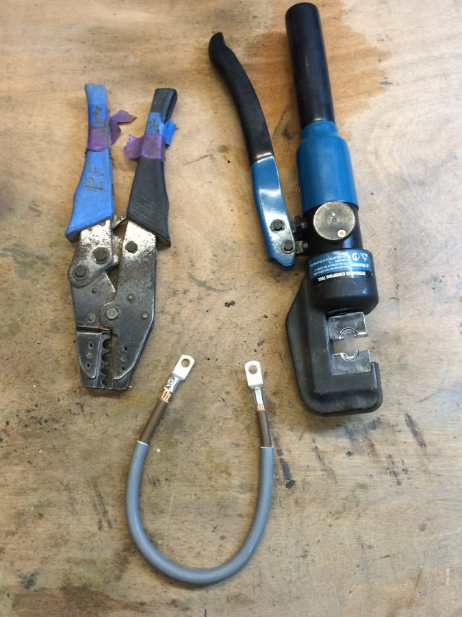

They are the type we are issued with in work for the electricians and they work just fine.
I use them myself for insulated lugs on the motor terminals and I've never had a lead pull free.
I'm sure you do use them at work. I once used the sole of my shoe to put in a screw. Doesn't mean either of them is the right tool for the job.
If you zoom in, the crimpers them selves tell you they are not the correct tool for the job.

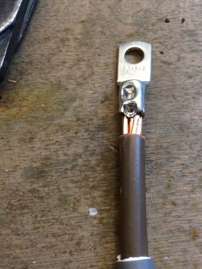

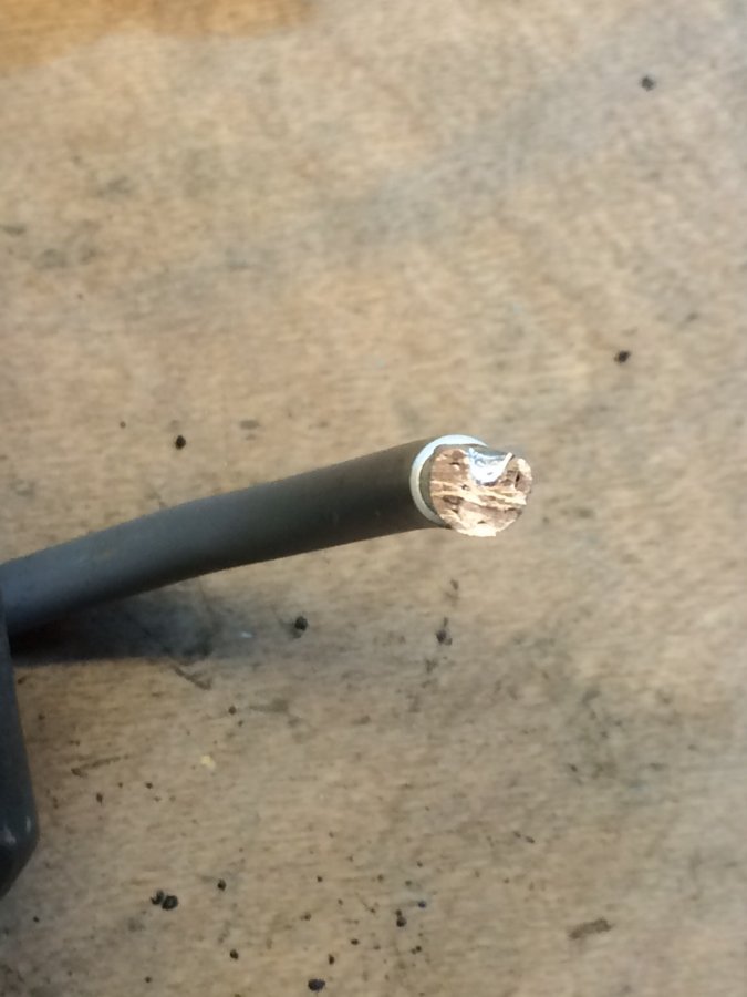

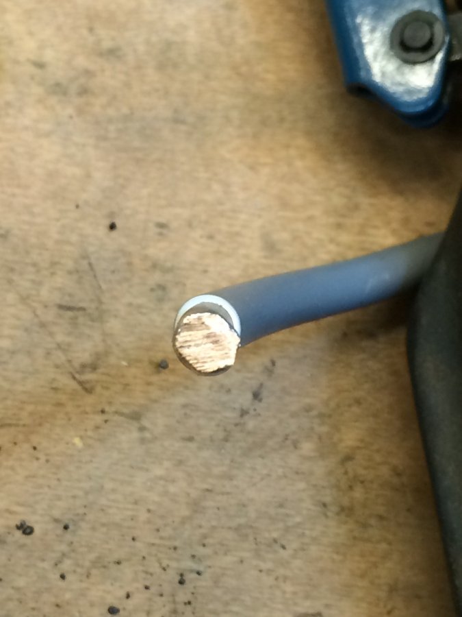

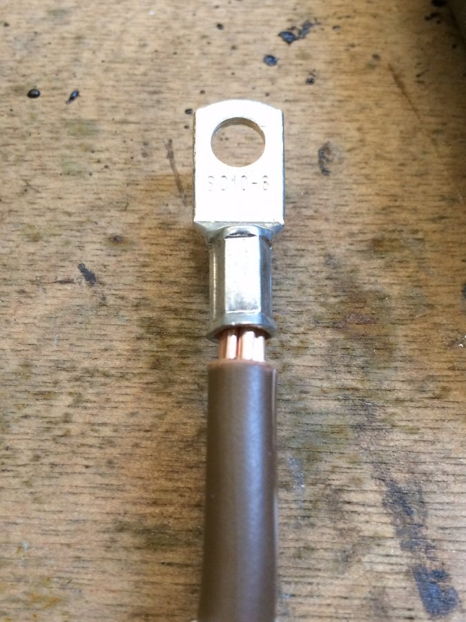

Just tried this using my hand ratchet crimpers and my hydraulic crimpers.
Ratchet crimp:
Hydraulic crimp:
Hydraulic crimp:
Ratchet Crimp:
