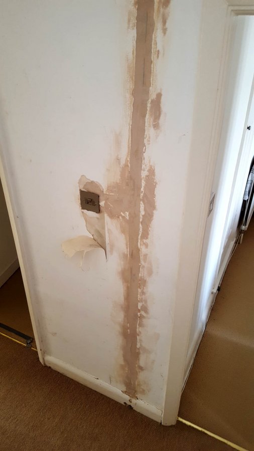

are these electrics compliant with part P?
PS - if the block is anything like the brick in our 60's ex-council house then I can understand the sparky not wanting to chase it. It's almost unchasable it's that 'kin hard. If not careful, the brick will just move in the mortar and push the plaster off the other side of the wall - with barely a scratch on the brick. Takes me hours to chase out a backbox, working carefully-but-purposefully with a scutch.
Yes, but no excuse to leave the cables proud of the finished plaster, he should have found an alternative route if that was the case.
And it doesn't alter the fact it's not in a safe zone.
If he HAD to chase the cables in that particular spot, he could perhaps have fitted a socket here, to create a cable zone, as it seems the socket circuit runs through here.
All in all clearly the work of someone who doesn't know what he's doing/doesn't care.

Strictly speaking that would not be compliant; accessories do not create a safe zone for cables not connected to them.

thanks for you replies folks. The internal brick walls are extremely hard but it didn't take him long to chase in and like others have said it should've been put in a cable safe zone. There is also easily enough room to chase it in 1 cm deeper. I have put a review of their work on Central London Lofts Facebook page. Its true we have to be very careful what we say online etc.

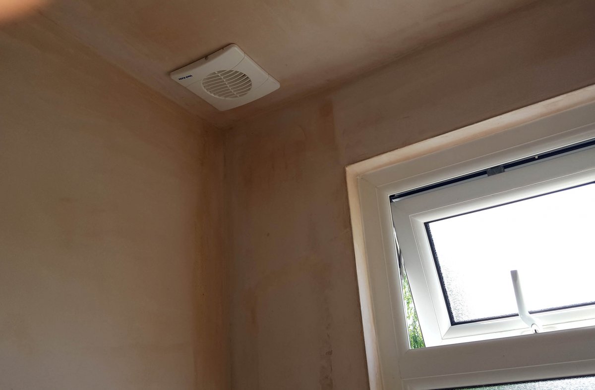

This extractor fan didn't have any ducting, it just goes straight to the ceiling joists, is that within regulation?
The electrician says that meets regulation because it is close to soffit and moist air will escape. (its about 33 cm from soffit)
I read that moist air should not go direct in to ceiling joists as it will cause condensation.

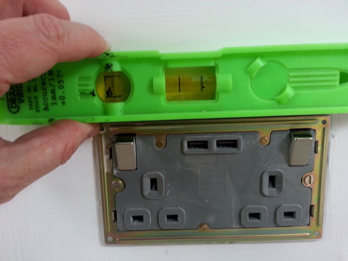

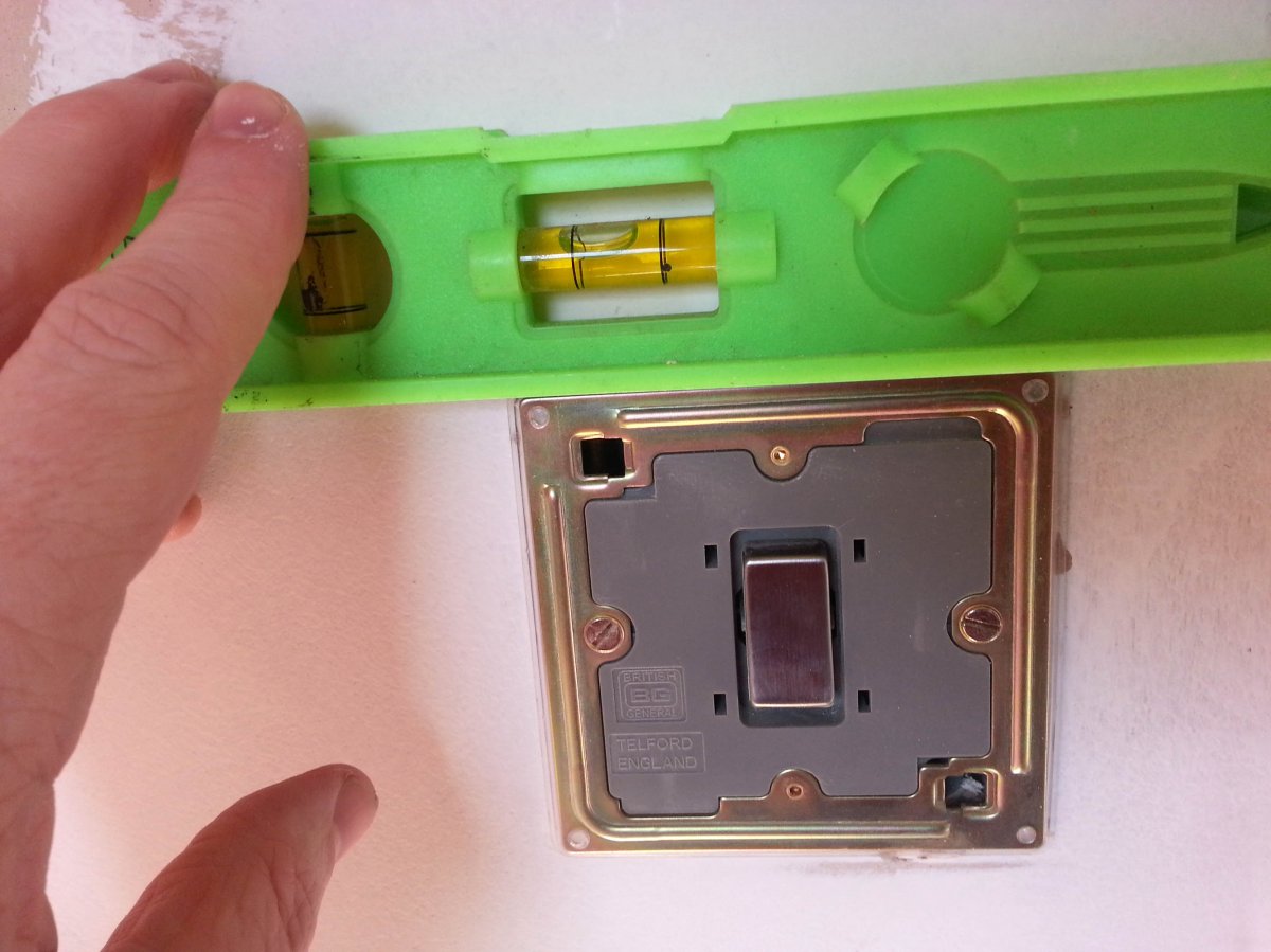

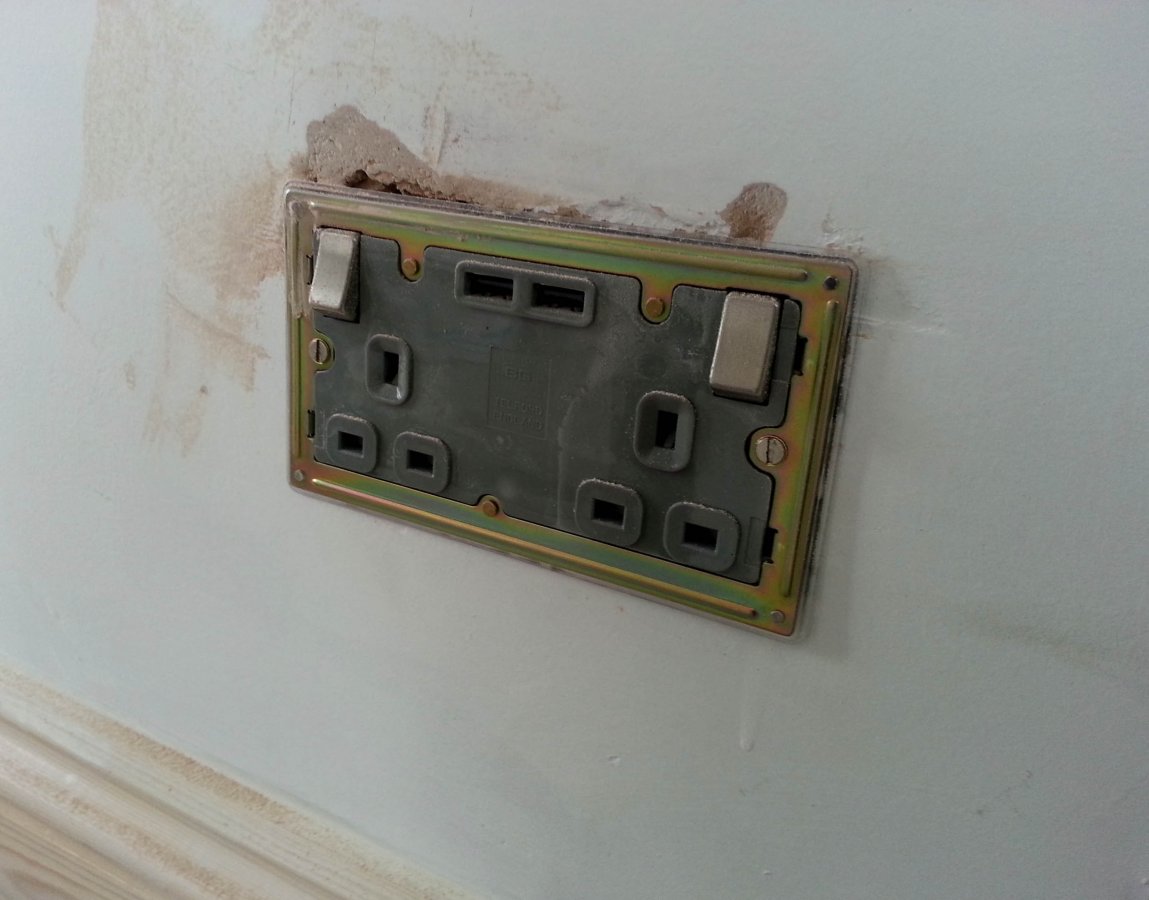

I've also included more examples of the socket work
He knows damn well that's a load of *******s and he just doesn't care and CBA to do the job properly.
Correct, you'll have the loft dripping with water. It will start with white mould, and before you know it the timbers will start rotting.

522.03.01 A wiring system shall be selected and erected so that no damage is caused by condensation or ingess of water during installation, use and maintenance. This is clearly not the cause with an un-vented Fan.
One could also refer to Section 8(iii) of the on site guide, i'd hazard a guess this chap doesn't own one though.

I didn't ask for the switch to be moved Nozzle. The switch was already there and he chased in to the right of the switch and created a spur of the existing socket
