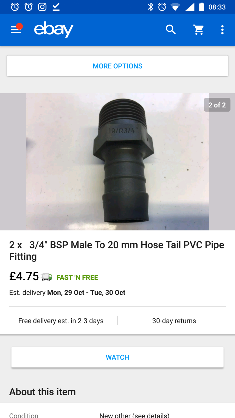

Could it be a BSP thread? It would be a lot cheaper for them to bulk buy ready made water butt connectors than have 'made to order' M20 threaded barbed connectors manufactured...
https://www.ebay.co.uk/itm/Water-Bu...r-Fitting-With-Seal-And-Back-Nut/222598726069

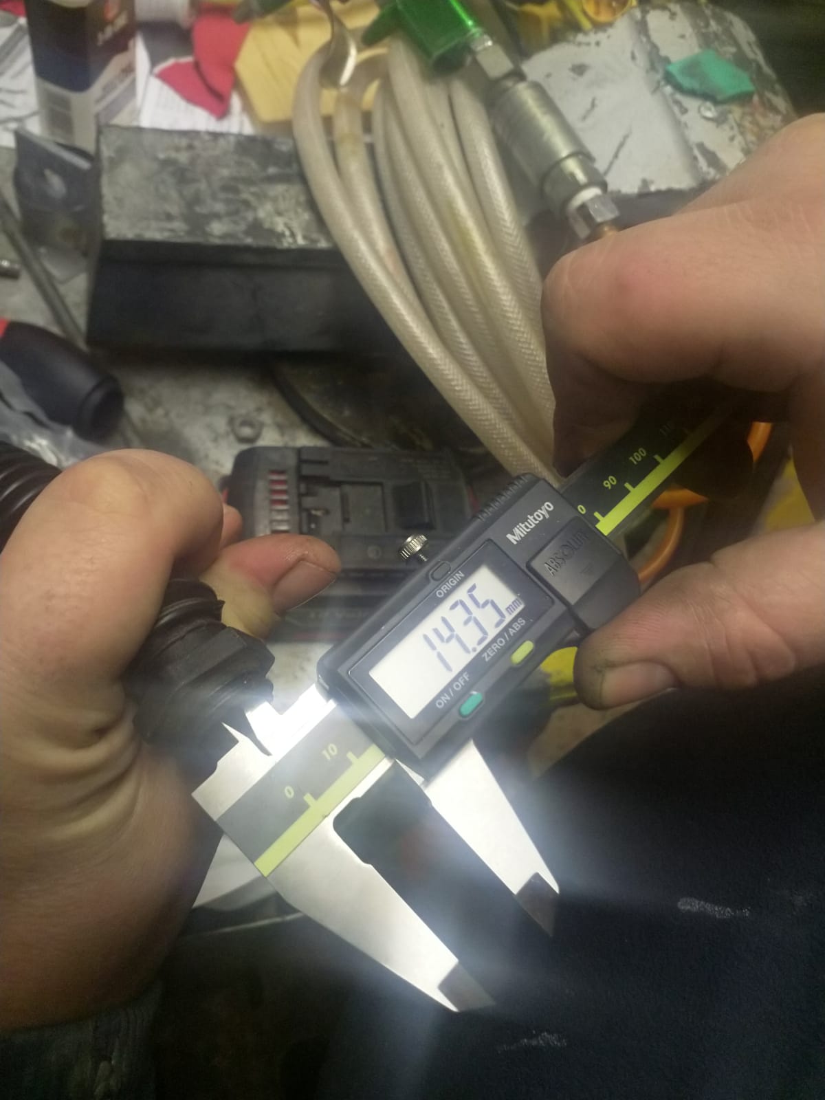

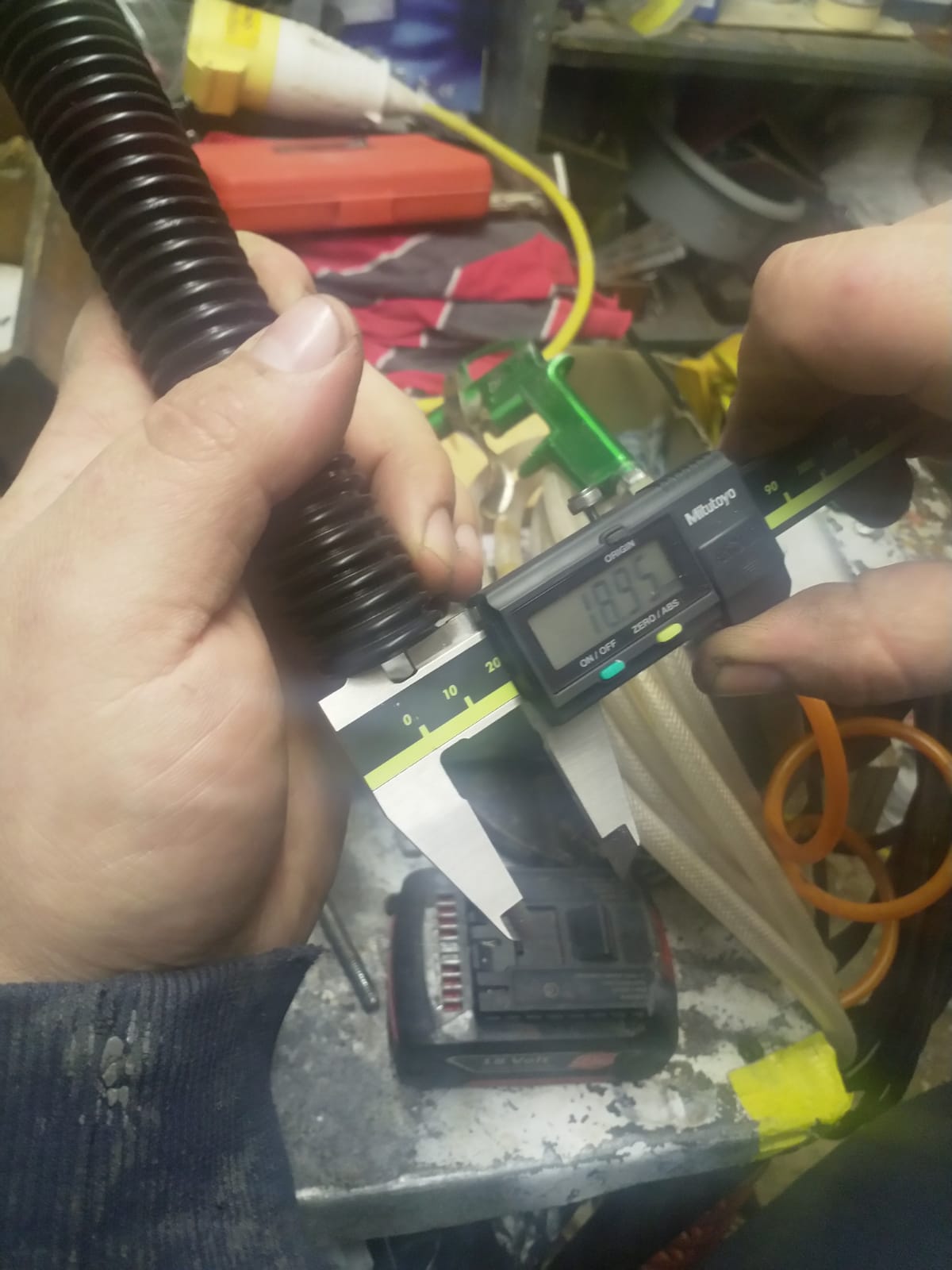

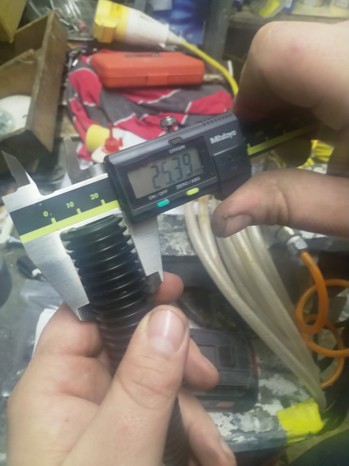

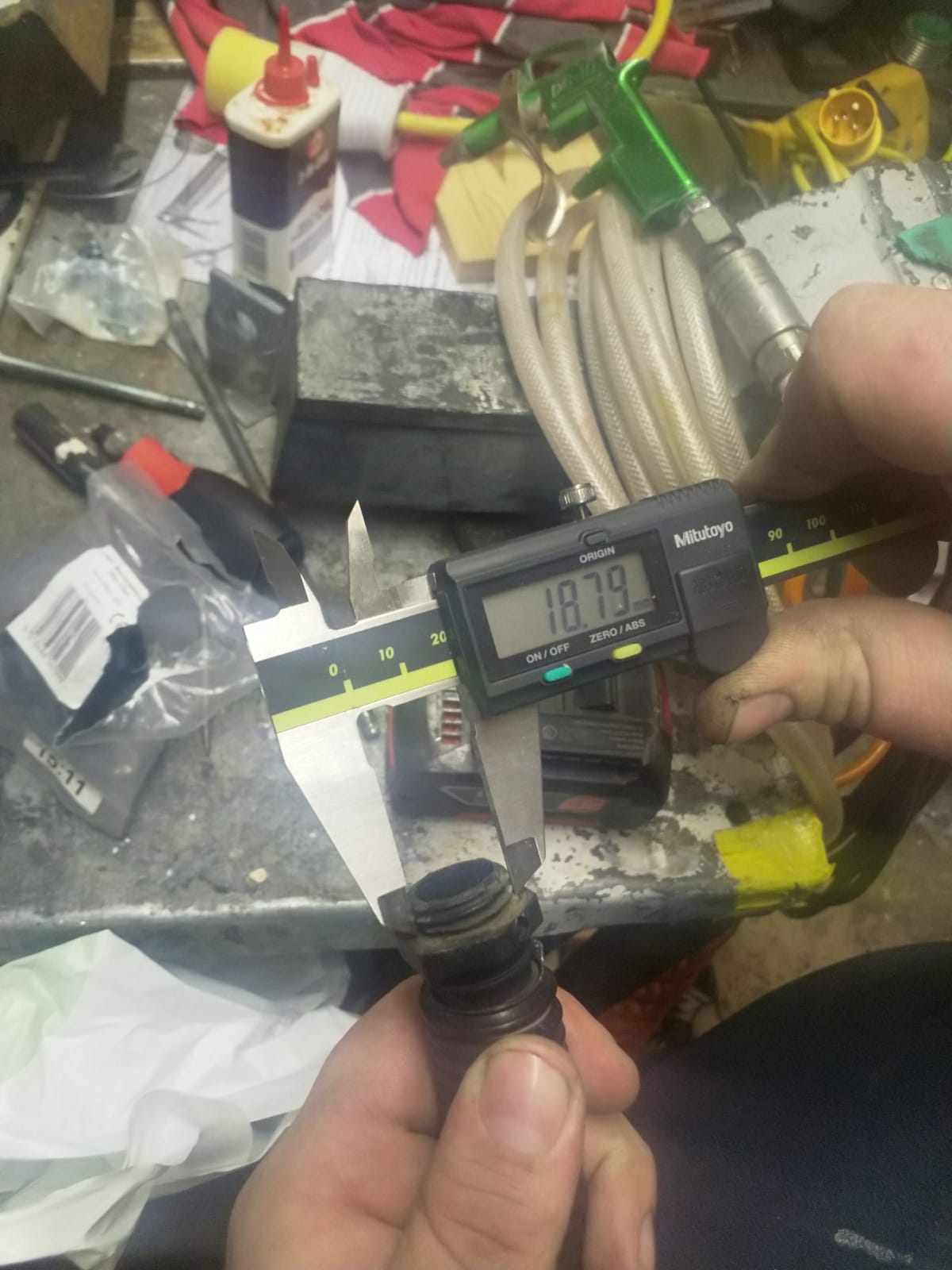

I've checked one of the good ones. Not sure if they're 20mm fittings but the thread doesn't look like something from a standard electrical conduit part.
Any advice?

A friend sent a link to these this morning so I've ordered a pair.
