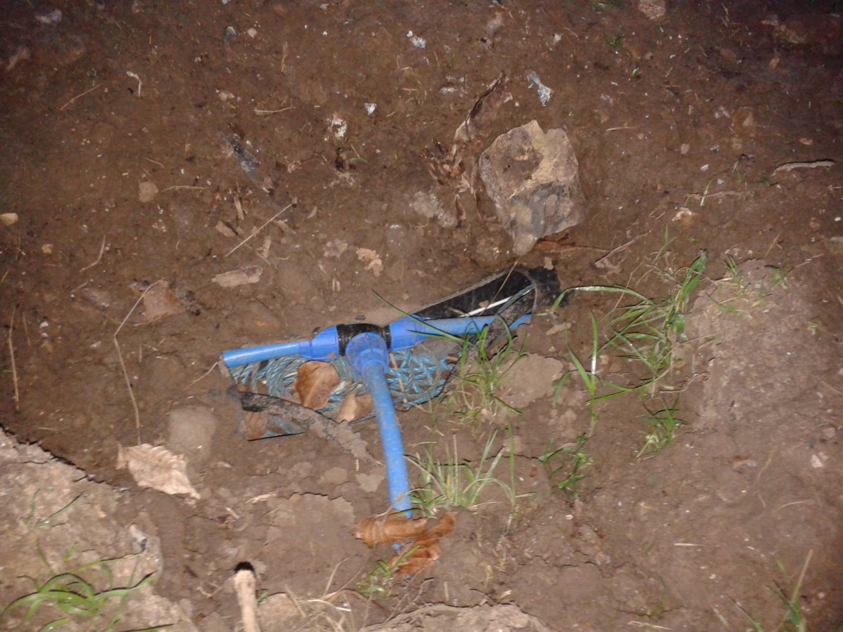

Could do what I've had to do in a similar situation;
  • Buy yourself the biggest plastic adaptable box you can find (Toolstation do a tolerable one 67255, probably get something better from your local electrical wholesaler)
  • Using your AB as a guide, dig a hole (where your junction is), put a couple of courses of bricks in as the sides/support for the cover
  • Cut holes in the sides of your AB to match the duct sizes, insert them, seal with silicon
  • Do whatever you need to do in the box then screw the lid on. Stick a WARNING ELECTRICAL CABLES label on the lid
  • Put a paving slab over the top (resting on the bricks)
Ironside - this advice is flawed. You should use ducting and chambers meant for electrical cables, so that nobody ever mistakes them for drainage.
What like this one?
