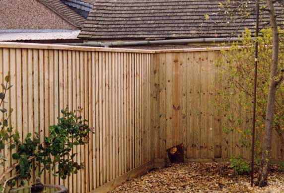

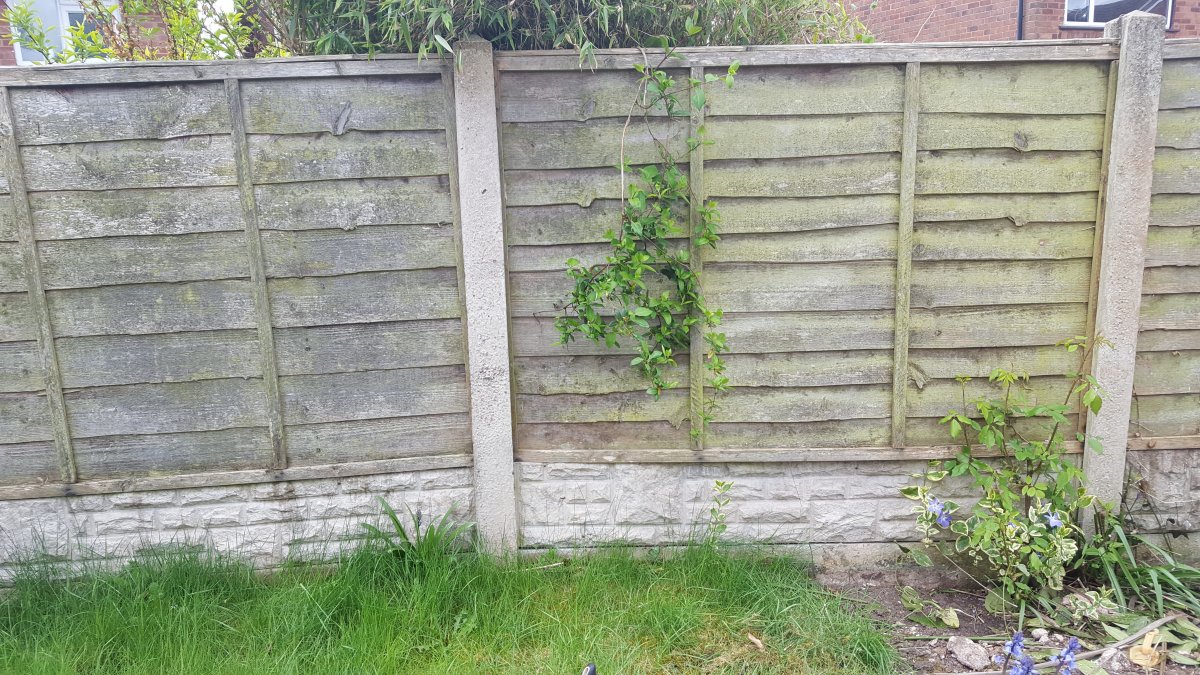

Top pic is what im aiming for ie completely seamless, bottom pic shows what ive basically got, i know it seems weird but i was going to just put the new panels attached infront if the existing with perhaps a wooden bottom board.
there should be holes in the slotted posts so you can affix a timber baton either side and bolt through then fix you rails 2 this is your best option for a seamless look (on your side)
those posts will be really hard to drill so id avoid that. other option is to drop posts inbetween the others - i.e middle of the pannel then your not digging them up .
other option - you can get clips that will hold a batton the the front of post, but your far better using option a if you want an easy quicker fix .
just remove a panel and check you have a hole top and bottom on the inside of slot
