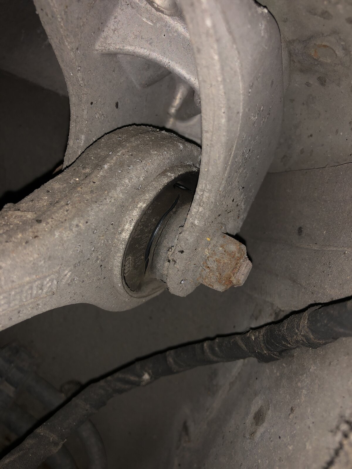

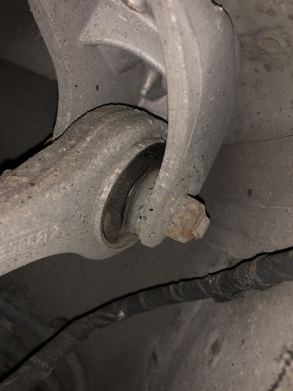

Took the car in for an MOT but was failed on :-
  • Nearside Front Upper Suspension arm pin or bush excessively worn (5.3.4 (a) (i))
  • Offside Front Upper Suspension arm pin or bush excessively worn (5.3.4 (a) (i))
Have looked at the arm bushes and Pin both sides but cannot understand the reason for the failure as both arms look good, the bushes are not cracked, split or perished! I ah attached photos. So am at a loss for the failure?
Garage just charges me £19 so am worried if they failed to get the repair job done by them? They quoted £305 to supply and fit new arms.
Any thoughts would be greatly appreciated. Tested both sides with full steering lock side to side. Arms and bushes performed as should be no popping out etc.

Some slight cracking but for something to be excessively worn, it has to be practically hanging out and about to fail. You could go down the appeal route but for the loss of £19, it might be worth taking it elsewhere for another test. Your local council run test station would be a good place if you have one as they don’t have a vested interest in finding work. (y)
Pry bar, and give it a wobble, if there's excessive movement, well any really, they're worn. But there will be much more competent, experienced views on here for you to consider.
There is some splitting on those bushes but I'd say that was an advisory rather than a fail.....
I don't know if you can rebush these but I'd have thought so.

Hello All and man thanks for your views. Checked both sides of the bushes all seems fine. Pry Bar absolutely no movement then designed and intended. Sad to say but this garage MOT Tester and owner were trying it on. Looked at prodded, pryed, no movement from these bushes!
Maybe best to try another more competent MOT Tester, any thoughts?
