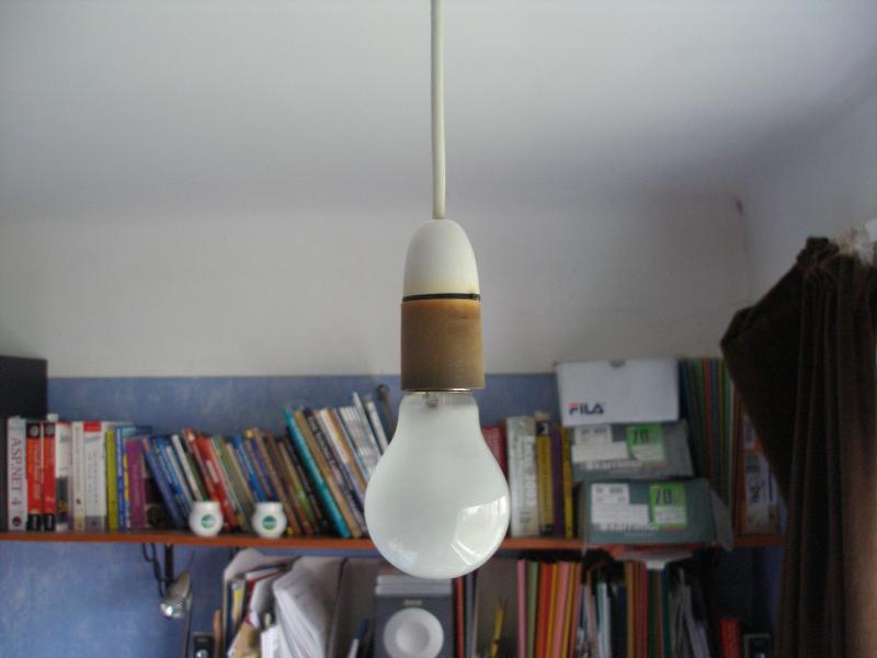

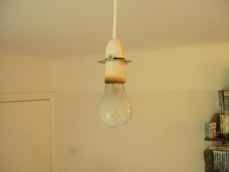

Baking lampholders
Just use MK plastic lampholders.
They have a metal bit to hold the bulb in place, and should last for a good few years.
A good few years? Brass ones will last a lifetime.
Several lifetimes actually.
Brass lampholders is madness.
Nonsense - it's an excellent material. Far more appropriate than plastic.
Ever had a plastic lampholder, which even if undamaged, just won't unscrew any more?
Ever had that happen to a brass one (in a normal domestic interior environment)?
They need earthing which is a PITA,
Pyro is more work to install than T/E as well. Why do you do it when you don't have to?
and they'd look awful too.
Unlike these of course, which look lovely.
I don't know what you mean by 'Pyro' or 'T/E'. Are you saying a brass lampholder doesn't need to be earthed? If it does need to be earthed I'm stuck with the plastic ones as my lighting circuits have no earth connections.
I checked the markings on the lampholders I have mentioned. They are all T2. I remembered another 100W bulb in the house. It's in the front room so on as much as any other bulb. The lampholder has been in place for at least a few years but doesn't show any sign of burning. So maybe it's all down to quality. I'm not buying unbranded fittings from discount shops any more.
