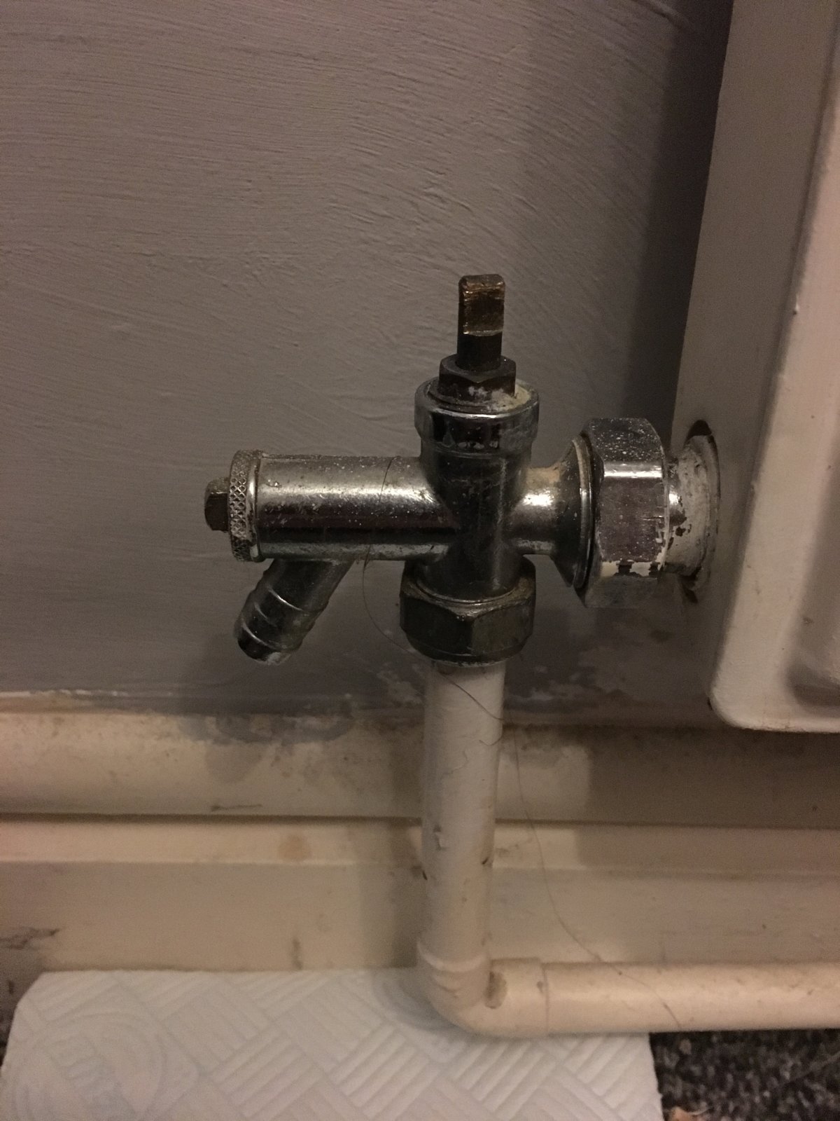

Hello
The radiator in my living room doesn’t get as hot as the rest of the radiators in the house.
I started to balance them last night, but when I turn the valve all the way to the end on the problem radiator, water starts leaking out.
This doesn’t happen on any of the others. Does this explain the problem I’m having? And is it normal?
no it just means that the gland is worn turn the spindle down a few turns and then tighten the little nut where the water comes out and it should stop leaking, wont make any difference to you rad heating up though

Half the lockshields out there are junk quality...breath on them and they'll leak. If there's no gland nut round the spindle replace the valve.

Sorry - I'm not familiar with terminology so just trying to describe what I see.
When I am turning the valve with the pliers, it is seeping out at the base of the part that I am turning (indicated by the red arrow on the attachment).

So you've never had a LS weep when you've been messing with them?
OP - when you say leak, do you mean a leak in the conventional sense, it won't stop or as I've suggested a weep caused by your adjustment?

Continuous or just a drop that stops after you've stopped moving it?

It starts to seep out slowly, but when I tighten it back up it stops. However, this doesn't happen on any of the other radiators in the house - I can turn them to the maximum in both directions without any water coming out.
My Dad suggested the problem with it not heating up properly could be that it is all sludged up (he isn't a plumber though) - so I wondered whether this is what is coming out?
Have you tried tightening down the valve gland nut? That's the brass nut located below the valve spindle. Try that to see if it cures the leak when moving the valve spindle between open and closed.

That is the gland seal nut that I told you how to sort get the proper tools you will not manage with pliers
Give us a pic of your valve......it may have a gland nut or maybe sealed with an O ring. The diagram you have posted is the O ringed type and isnt adjustable.
