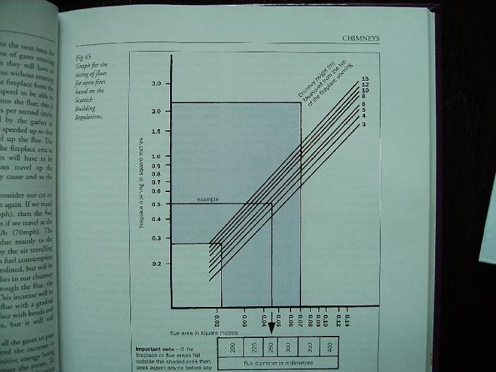

A short flue will usually give problems, but being outside isn't quite as bad as inside. Here's a graph showing the correct height of flues.
It's obviously not possible to build one that tall in the garden.

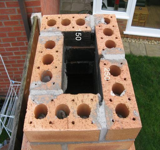

maybe you could add a tall chimneypot?
and/or make the chimney narrower by building a flue pipe in?
agree with what`s said - but chimney pots are sought after for garden planters :cry: Unless you find an unpopular one - Google " Marcone pot "and you`ll see one which is designed to increase draw - then find one on eBay - I did for £1 :eek:
