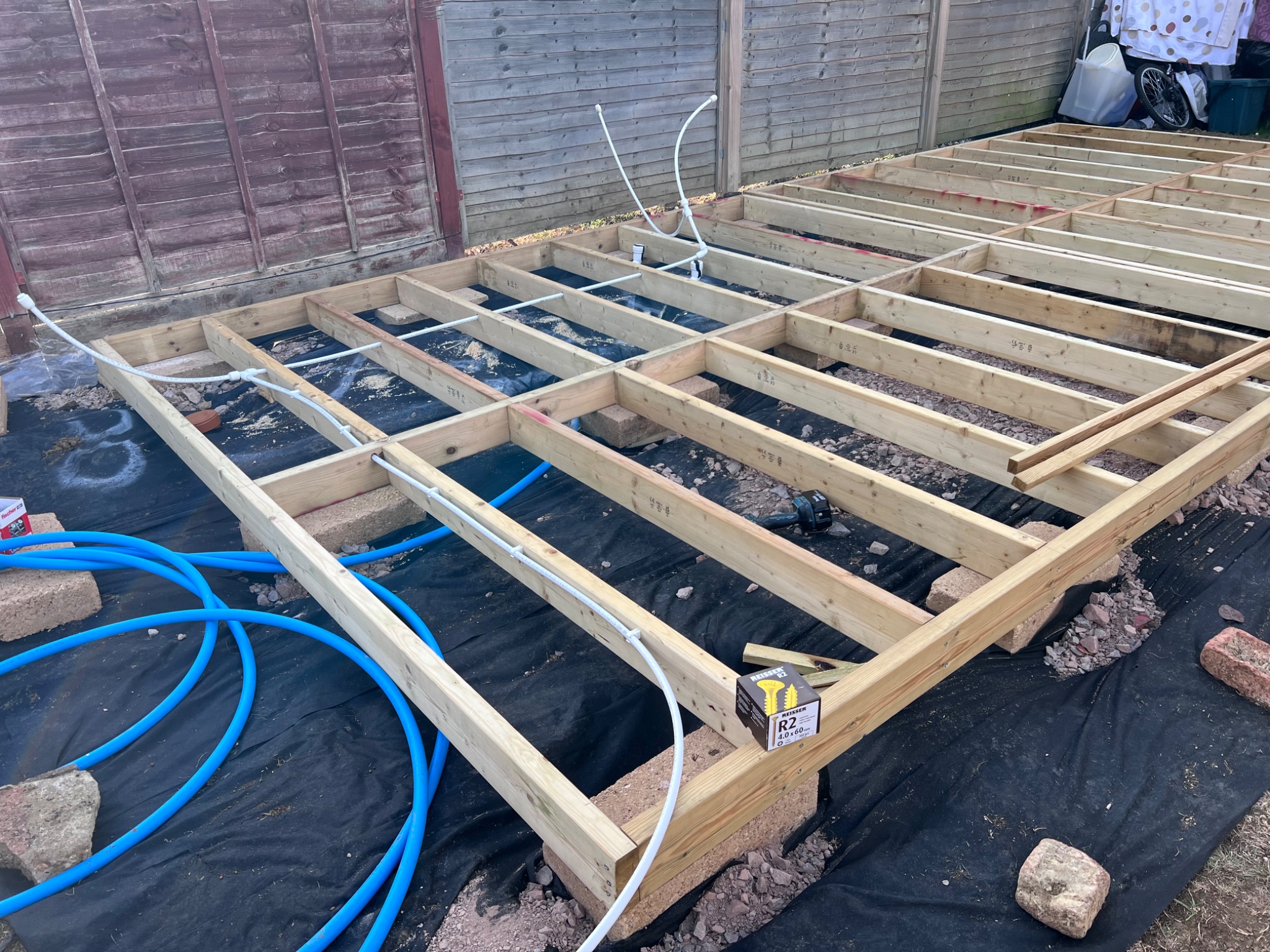

I built this base and measured everything diligently as I went along.
When I measure from corner to corner, there is a 1cm difference. I’ve tried kicking it in the corner but that knocks it out on the other end.
Is there a better way to do this?
Get two lengths of string the same length.
Put them both on the same corner to corner.
Mark both.
Move one so you have one on each corner to corner.
If you can get them both the same lining up to marks or just over or under under it will be squared up.

Normally the OSB floor would help to square it, but you're putting that in after walls i think? 10mm is fine over that distance, it wouldn't even be noticed, but you could set the walls a few mill in/out to get back to square.

But the string has some flex in it. Not sure I follow your suggestion.
Aha. I’m now putting the floor down first. I’ve brought a waterproof membrane. Will cover in that, build walls and roof. Then I will cut it off the floor.
I wanted to fix some brackets in the corner, between joist and concrete block. It’s also having floor insulation. I think I need to square before the osb flooring goes in unless there’s something I can do temporarily with the osb boards to get these brackets fitted?
Also the 1cm difference is across a section that is 3.3m x 3m.

I spy a box of 60mm screws. Are they the ones you have used to join the timbers? Seems a bit short to me.
LOL
God, have to be so careful with what is included in these pics. The 60mm screws are for the insulation battens. I used 100mm screws for joists.
Can I temporarily screw in one of my large OSB sheets along the 1200 side. I can then push/pull to screw in the longer side. At that point we are all square?
I can then fit the angle brackets in the 3 corners that are visible. At this point, I can remove the OSB board and fit the final bracket.
