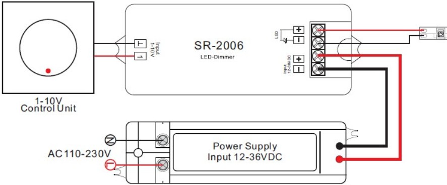

For some reason you keep conflating basic dimming, like this:
with full-blown automation.

Unless things have changed since I last looked into all this (which they could have done, of course), 1-10V dimmers work by providing their own control voltage for the controller, which could just be a simple variable resistor, to control. Not the same thing as 0-10V dimmers which rely entirely on an external device to supply the control voltage.
