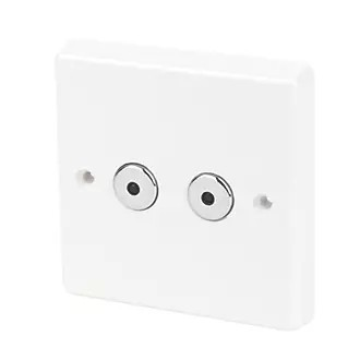

Bathroom being tiled next week. Wife would like dimmable low voltage led strips fitted in the niches, above the bath.
She'd also like to swap out the ceiling downlights with dimmable ones.
I've found these varilight touch dimmers but cannot find an IP rating for them.
Surely this isn't a unique problem (2 sets of dimmable lights in a bathroom). The hallway outside the door is a set of 3 doors with no space for a switch, so cannot put the dimmer there.
Suggestions please:
1. Is there an ip65? touch dimmer suitable for bathroom?
2. If not, how is this problem solved?
There's also the issue of the extractor fan, not suitable for a dimmer. Was considering leaving the pull cord for that.

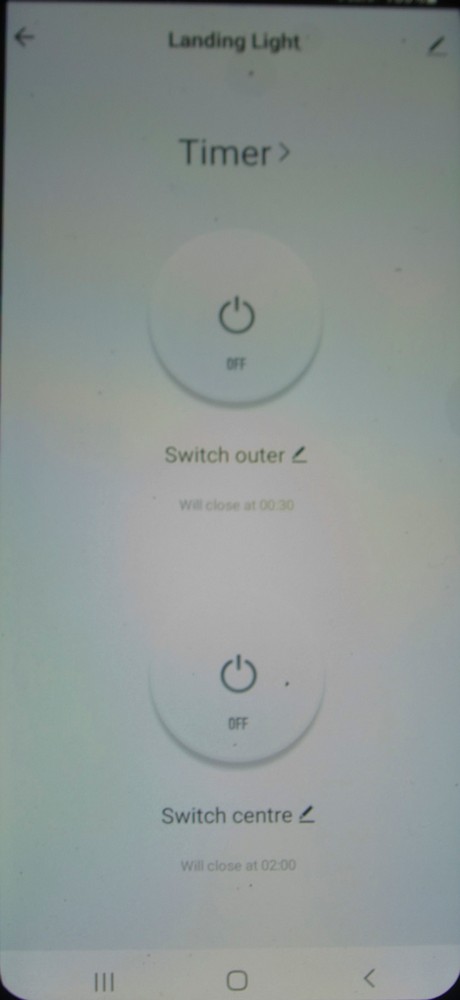

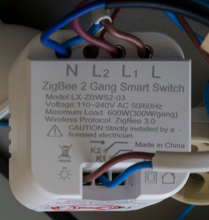

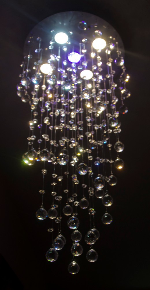

I to avoid waking each other at night have a 5 bulb landing lamp, centre bulb colour changing GU10 and outer ones simple on/off with a relay built into the lamp. DSC_6799.jpg There are many way to control lamps today, I am using a relay DSC_6061r.jpg as it allows use of switch as well, but since fitting the light switch is seldom used, I will use it so no sound late at night, but the switch is now extra low voltage so no problem in a bathroom.
I tend to set centre always dimmed, but I can alter it if I wish. With the phone I get DSC_6787.jpg so easy enough to switch on/off, to me the biggest challenge is where to get power from for the strip lights, I had it with kitchen, new strip lights needed a socket, and the question was how to mount a socket which would not be seen, so no one would try using it for some thing else.

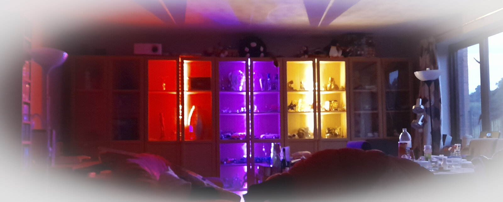

Your problem is socket not allowed in the bathroom, so likely looking at loft space? We want to hide the controls 20220704_220141_1.jpg I have soft toys in front of the sockets and control boxes to hide them, some day may built a pelmet. And yes the lights are not really required to light the room, and in the last house the cabinet lighting was never used, but using smart controls means it auto turns on in the evening and off when we go to bed, so actually now used.
Lights from Ikea outer and Lidi centre. Switching with an Energenie power strip, although centre lights could be controlled direct with zigbee if I wished. The room main light is not central and that area is darker than rest, so cabinet lights do light the dinning area of the room.
