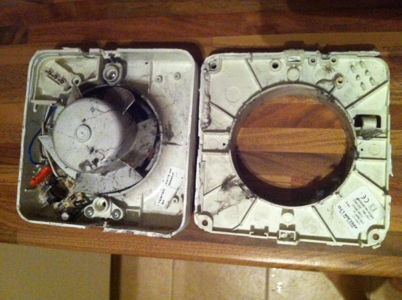

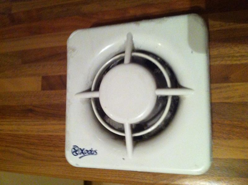

I am trying to replace a bathroom extractor fan in my girlfriends bathroom. We have just moved in and understand the previous owner never had the fan working. There is no switch so i can only assume it is cord activated. I have taken the old fan off the wall, expecting to have to disconnect from the mains but when i got the fan off there did not seem to be any obvious electrical connection! (I am no electrician!) There is random wiring in a socket a few inches away from the fan but i see no connection between the two?
I have posted some pictures in case this helps explain the problem.

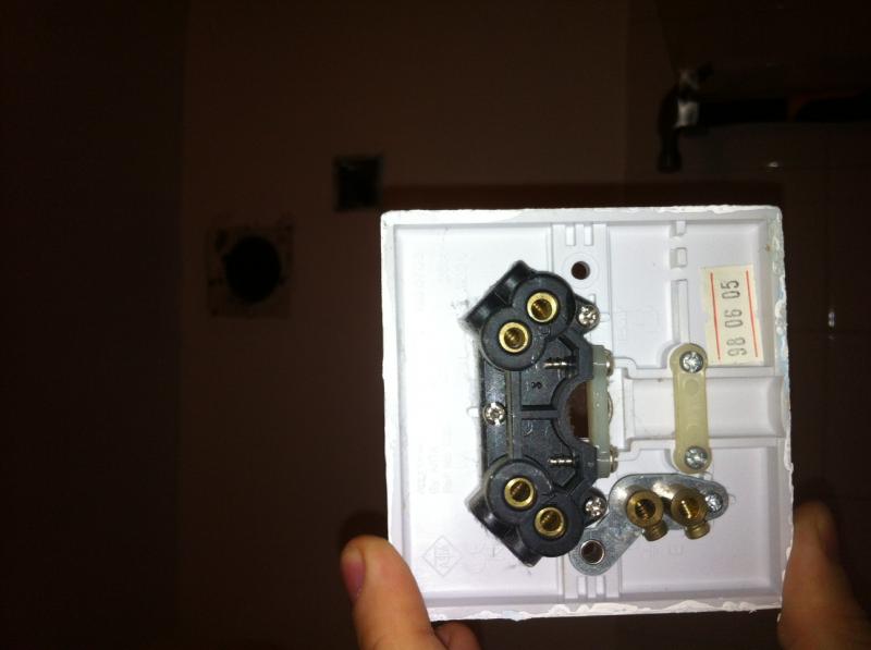

Looks to me as though at some time there was a length of flex exiting through the front of that plate and entering the fan through a knockout on the bottom.

The plate is a flex outlet, where the fixed wiring would be attached to the terminals along with a flex, which would come out of the middle and into the fan.
Looking at the fan, there seems to be a small notch where the flex went in.
You need to check if the fan still works and whether it is a timer model or not.
If it does not work, you'll need a new one. Again, is it near the bath or shower?

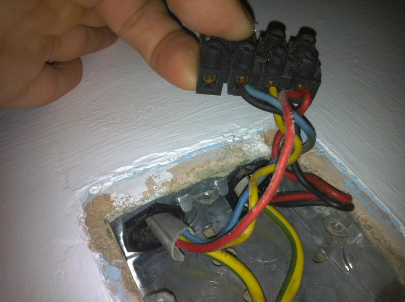

From what I can see, it looks like there's a T&E and a 3C&E in there.
The reds are together, the blue & black are together & the yellow is on its own.
The cpc's are connected to the back box terminal.
That might be wrong, though, because that's not logical, Jim.
I was wondering if there was a little bridge cable hiding behind the web.
I bet someone in the past has gone in there inebriated, staggered, grabbed the cable to steady themselves and pulled the cable out.

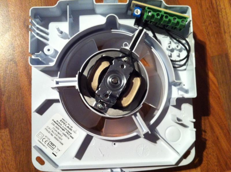

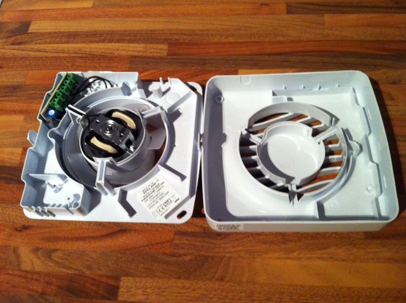

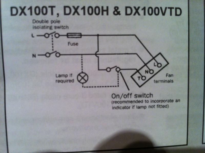

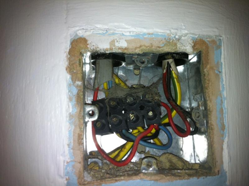

Hi. Sorry for the delay with the pictures. I have been out and bought myself a DX100T Xpelair with a timer. The instructions/manual talk about using 3 core flex to wire the fan. I think I understand how to mount the fan and where the wire runs in general......the problem is what wires go into which connectors?! I tried to look for 4 core flex but Screwfix didnt have any!

Have you got a multimeter?
I can guess, but you need to be sure.
The reds could be the live, the yellow the switched live and the black/blue the neutral.
As I said before, you'll need a short length of 4 core flex to link the fan to the flex outlet.
Connect the earth wire inside the metal box but don't connect it inside the fan. Put a connector block on the end to make sure it's not touching anything.
Is that back box 16mm?
That's a bit stingy: take care you don't trap any wires when everything goes back, especially behind the fixing screws.
In fact, use the terminals on the flex outlet to minimise the number of terminal blocks you need then there'll be more room in the back box.
