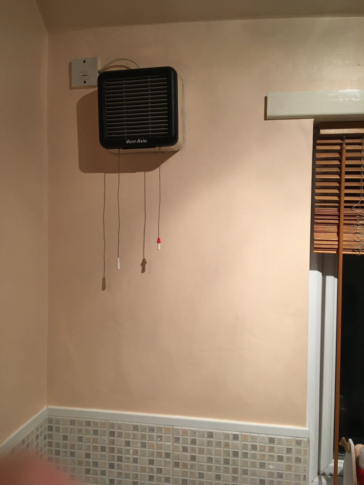

Hi looking at changing an ugly non working 9 inch fan that is wired above fan to fcu
Just wondered what’s peoples ideas about this regarding type of fan and regs, wanting something not so bulky but guess I’ll need to go into the hole already there ideas please
if the case is 9" square, the duct is probably 6" diameter and it will be called a 150mm fan. Can you check that?
Does it go straight through the wall?
is it above a bath or shower tray?
what is its height above the floor?
do you know why it doesn't work? Is the fuse removed?

it goes straight through wall
above bath
will need to measure approx 1-5 to 1.8m from floor
not worked since moved in could be fuse, although I couldn’t open fan originally but have managed to open it on the string earlier so will check fuse also, although I will want to change it for something a bit more newer
as it's above the bath, and less than 2250mm above the floor, it will need to be either Safe Extra-Low Voltage, or rated as water resitant to IPX5 (protected against water jets from all directions, e.g. a shower.

Would it be possible to get a 6 inch fan wire to the fuse and have a pir fitted, or fit a 1p4 fan with pull cord ?

So can I please clarify, if I fit the German bauberg calm 150 fan with pull cord and timer, am I ok fitting as it’s ip45 and suitable for zone 1 , is like for like installation into 3a fuse and also on a trip. I’m all ok with regs I believe?
IP45 is more than adequate for Zone 1 (the regs only require a minimum of IPX4). However, the regs also require that it is "suitable for installation in zone 1 according to the manufacturer’s instructions" - so, if you wanted to be compliant with the regs, you would have to check that.
If, as I understand it, you would be replacing an existing extractor fan, then I don't think this would count as an "addition or alteration to an existing circuit" but, if it did, this work in Zone 1 would be 'notifiable work', which would require you to pay £££ to your local authority or else employ a 'self-certifying' (really 'self-notifying') electrician to do the work.
