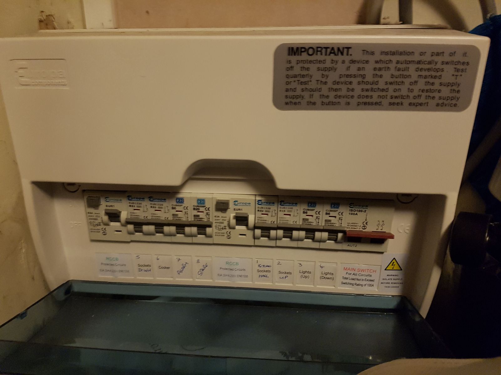

Thanks flameport, its above the sink but guess the zone 2/600mm still applies. Is the distance to the edge of the mirror or where the wire enters the mirror (or somewhere else) that matters?
I had a new consumer unit put in a couple of years ago and I think it's got an RCD, any way I can check for sure?
Cheers,
Bert
No zones above sinks / basins. It's only the distance from the bath or shower which matters.
A consumer unit from 2 years ago should have RCDs for everything, but post a picture of it here to be sure.
Sure, photo attached. Looking at it there are 2 protected circuit things on it so fingers crossed.

That has RCDs for everything, so no problem there.
