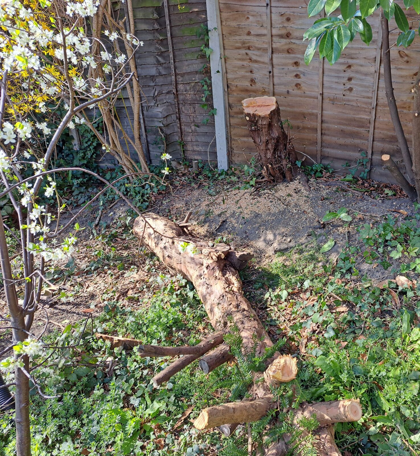

I have a Stihl petrol chainsaw but it was a bit of a faff getting it out when I only wanted to make one or two cuts. So when Lidl had a battery powered one I bought it, I already had a number of compatible batteries. Now it is the one that I mainly use.
It is definitely less powerful and somewhat slower but is lighter and easier to handle.
During the week I finished dealing with a yew tree, see here
that is c. 9" in diameter at the base.
No-one can give you a realistic idea of how long (in hours / days) a battery will last. It all depends on how many cuts you you make, how thick the wood is, how hard the wood is, etc. I started that day with a 4Ah battery that was not fully charged, did a number (15? 20?) of cuts to remove branches and then cut the wedge near the base before that battery gave out.
It is lighter than my petrol one but it is not really light, about 4kg - just under with a 2Ah battery, just over with a 4Ah one. So that may drag if carrying it a long way back to where the fallen wood is and then home again, and it will take up one hand making it harder to carry the wood home.
