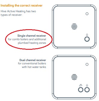

Anyone know what Hive kit I would require to fit to a Baxi 105he?
I do have a standard wall room stat with a 3 core to it from the boiler but a lot of the Hive wiring diagram examples I’ve seem to be based on replacing a full time clock.
Any advice on kit and install much appreciated.
I believe that the Baxi 105he is a combi boiler, so doesn't have a separate hot water cylinder attached to it. If that's the case you require the single channel Hive.

That’s great, thank you.
It is indeed a combi. Will this receiver work with any Hive wall stat do you know or is there a particular stat that it needs to par with?
The Hive thermostat will come with its own receiver and Hub as a complete kit.
Ah, ok. I’m with you. I just looked and this is the case.
It comes with 4 AA batteries, just wondered what they’re for as it doesn’t mention anything being wireless. Looks like your advice has lead me to the right one anyway, very much appreciated.
The receiver is mains powered and is connected to the wiring that controls the boiler. For a new installation it would normally mounted adjacent to the boiler for ease of wiring.
The thermostat itself is battery operated and can be located in the correct place to provide the best control of the heating without having to run wires from the boiler out to it. The thermostat then communicates with the receiver wirelessly.
