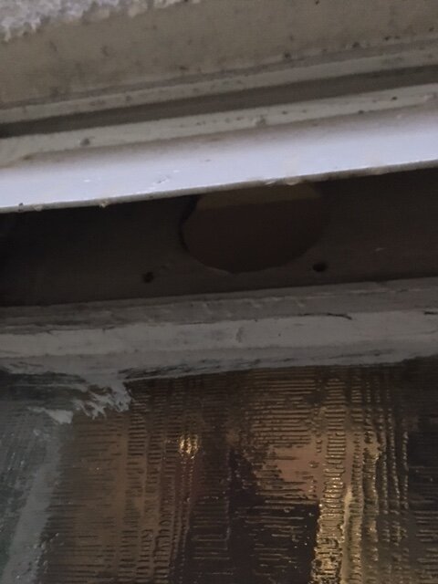

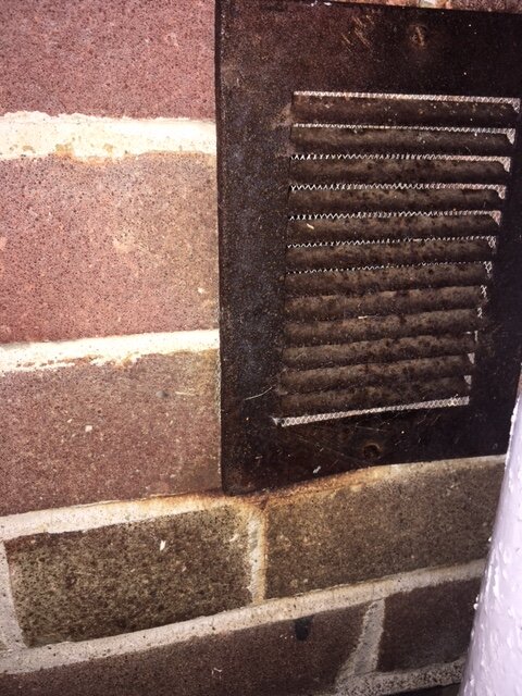

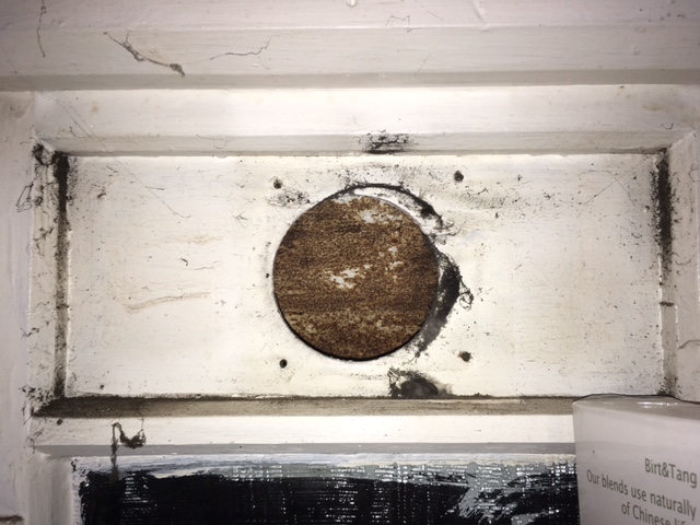

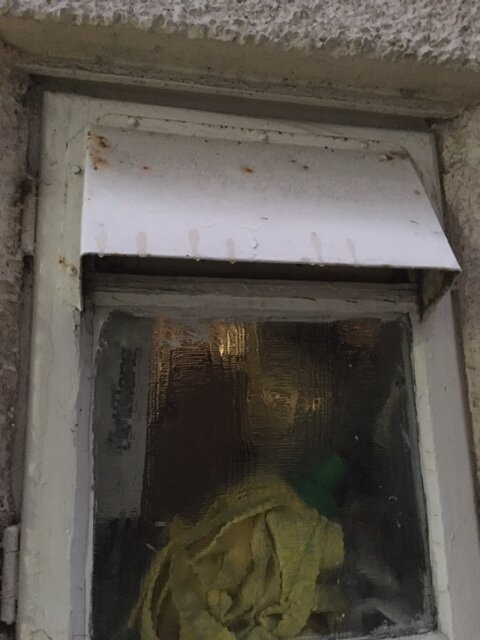

With regard to the vents: technically, the combustion air vent should not be in the kitchen. I, honestly, do not 100% know why, I have always assumed that it is to avoid transmission of odours (although it is obviously irrelevant of open plan). However, I would not create an issue if I came across an existing situation. The problem MAY be that the vents are not of sufficient size or type. They must be permanently open (not the sliding Hit & Miss type, eg) and definitely no insect mesh.

my vent cover on the wall is the wrong type as I inserted mesh on the outside below the cover and the inside can also slide closed. I’d always thought that the unobstructed hole in my kitchen was used instead, or to compensate, it’s where a tumble drier vent was used so a clear breeze blows through. I will get some new covers for inside and outside of the wall vent just in case before booking a service. I could sign up for British Gas service plan but I’d prefer an independent person, I might be wrong but I just expect a big company to put more pressure on me to have a whole new system installed.
