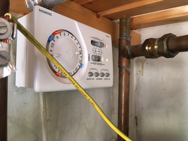

You have been completely ripped off, dont use this clown again, where in the country are you , possible a decent lad from here can help you out, great boilers and simple to those who know how they work, post some pics of controls motorised valves thermostats , anything that you have

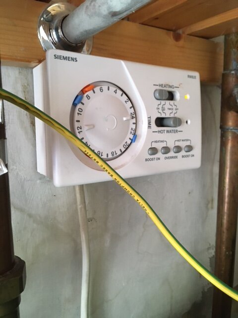

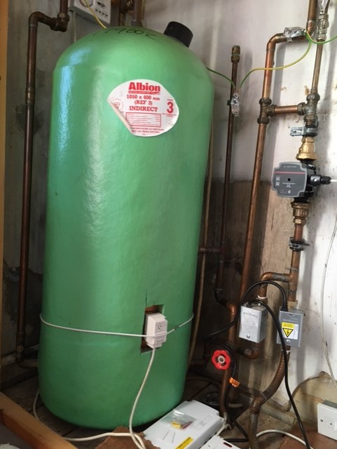

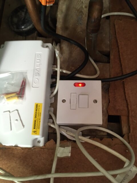

Hi Ian
I'm outer london/Kent borders.
The boiler is downstairs and controls in bedroom above next to HW cylinder. The spur socket is lit. The lights come on for both HW and CH at the timer, the LEDs light on the pump (previously CH only - but now since the rewire - HW only). It can't be the motorised valves as the CH (left) was working and the replacement HW valve lever (right) moves when turned on. As the old wiring box had never been touched I think its unlikley I've created an almost identical fault in the new one. I'm thinking I might try swapping out the timer because if it isn't that I think it must surely need somebody who can properly test the electrics in the boiler.

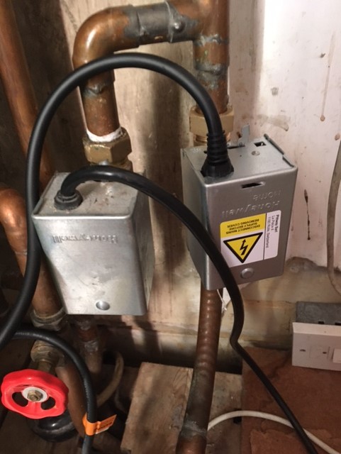

Would love to know what motorised valves he was going to fit that are better than Honeywell, he is talking absolute drivel, if you have a multimeter, remove the cover on the wiring centre and switch CH and HW both to on and test for 240V AC between the orange wires and Neutral , be carefull lots of live wires in there

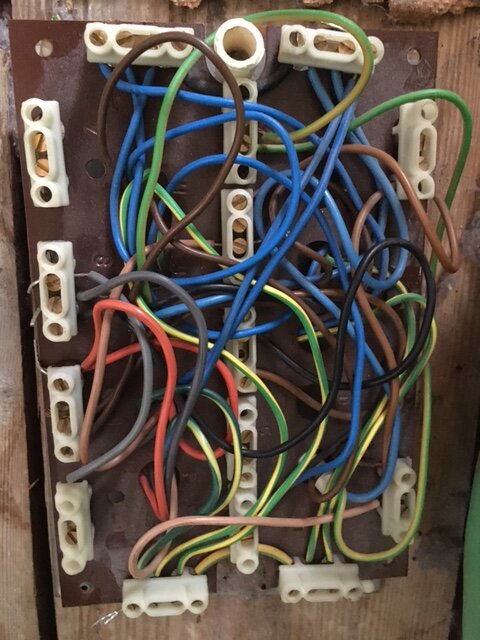

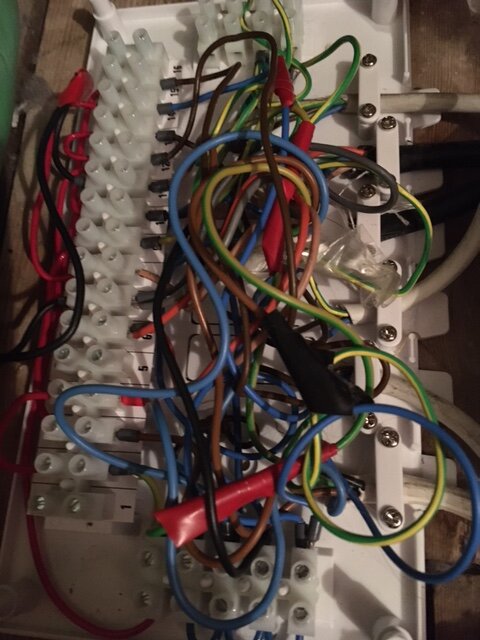

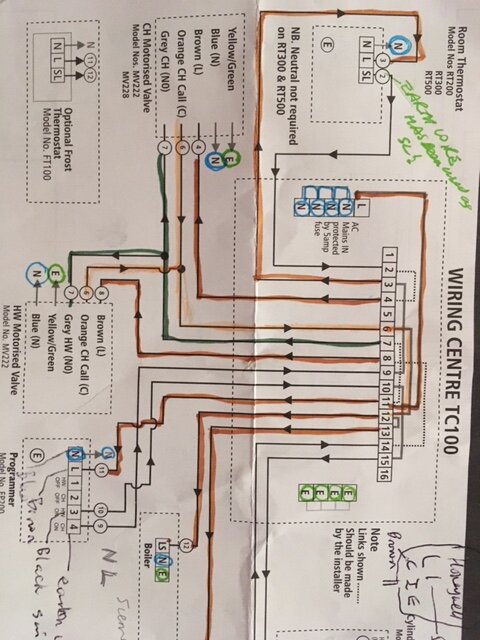

Hi Ian I’ve uploaded the pics of the old wiring, brown board on back, and the new wiring and the diagram that I used, I’ve written over it, but you can see that I’ve got both orange wires sharing the same slot, when you say test with neutral do you mean any of the neutral wires? Will a multimeter help when both are slotted together? I may need to take some brave pills before considering the multimeter as I’m sure some wires are switched lives that haven’t had brown sleeves added, I’ve stuck bits of red electrical tape over those but I can’t be 100% sure this thing is wired properly. It’s very odd that despite wiring the box from scratch it has an almost identical fault to before. Gas is on to the boiler, it was only turned off to the fire front with no labels and like I say he wouldn’t have said anything if I hadn’t wanted to double check the fire was okay to use

yes the orange wires should both be in the same terminal, that is the switched lived from the zone valves asking the boiler and pump to come on, if you have 240 there then external controls are all OK and the fault is at the boiler end, if you dont get 240v then it is an external control issue

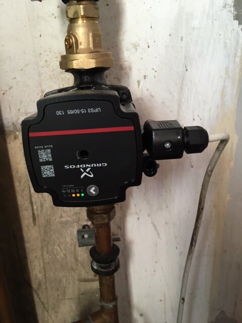

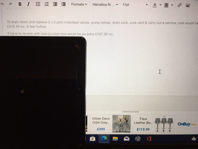

It’s a shame I don’t know more about the initial diagnosis, attached. The leaking drain valve is a red herring as I explained it had a tub under it to catch any drips as I hadn’t tightened it as fully as I could after fitting the pump. It was the pump valves he said weren’t the best, the lower one did isolate but I replaced the upper one with what I thought was like for like as that seemed seized, the lower screw isolates by a small turn, the upper screw does seem to keep turning without meeting any resistance, anyhow water goes through the pump so I don’t think that is the issue, I left the screw vertical as I presume that’s open.
I’ve been brave and had the multimeter out. Hw on 240v between orange and neutral and pump only starts not boiler. ch turned on alone at programmer and thermostat calling for heat 0v and no pump start and both on 240v. Does this help to narrow it down? Obviously I may have introduced a fresh fault by rewiring the box but essentially nothing has changed.

I took up floorboards and boiler cable is the one I thought it was. With no call for hw 12 is 240v and 13 is zero, when hw called both are 240v. I really appreciate the help on this as I only just grasped the wiring without any testing. One video I saw said for a 2 port system it is the grey wires and not the browns from the motorised valve that are the permanent lives, my wiring diagram labels brown as live so that’s what I followed.
