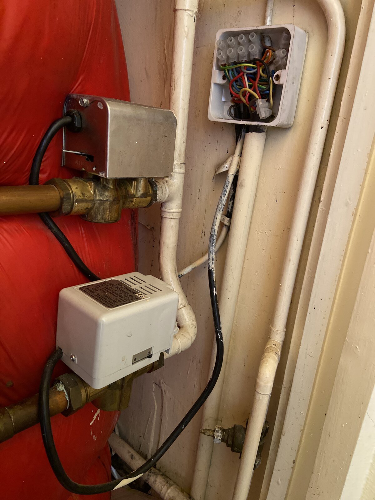

The cables from your motorised valves must go to some kind of wiring centre, can you post a pic of that ?
The cables from the two valves go into there and there’s a cable out of the top of that box that goes to the pump..
Only other cabling is an immersion heater which is switched on separately

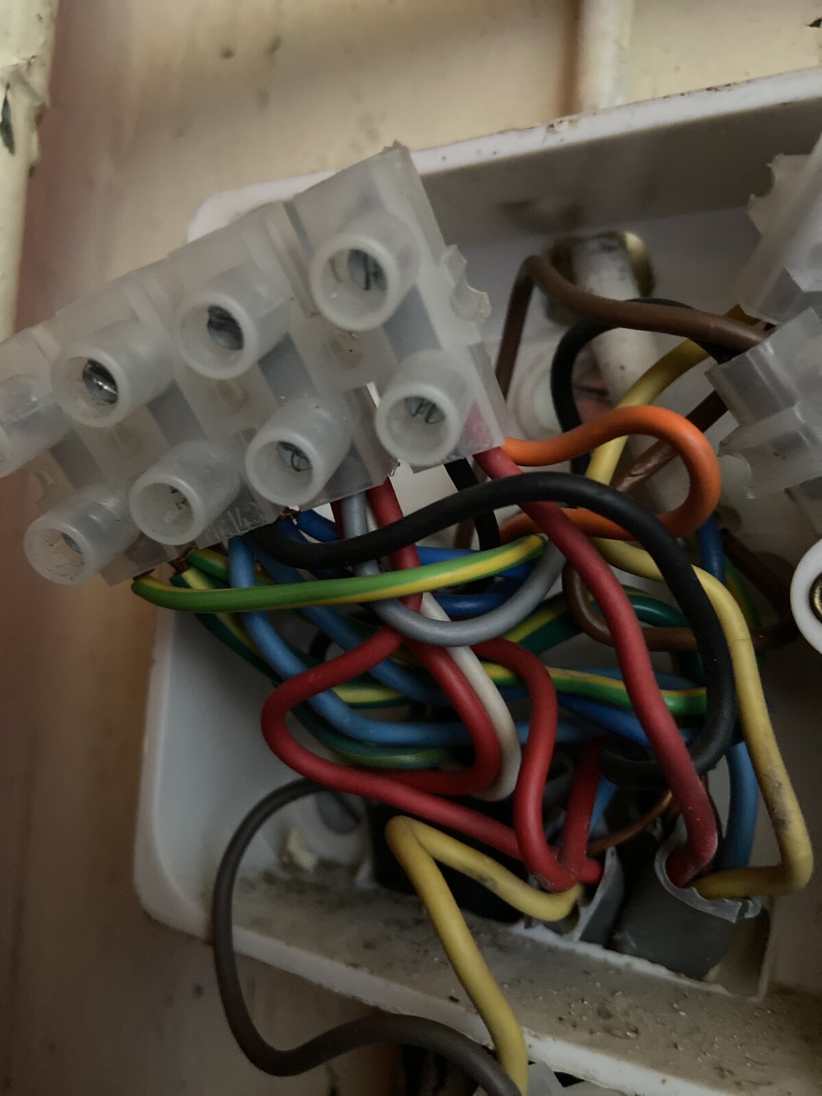

what a mess, isolate the power, you have 2x grey wires and 2x orange wires, put one of the orange wires into the same terminal as the grey wires, then manually latch the motorised valves to the open position,, turn the power back on and the boiler should come on, you will have heating and HW till you can get someone out , you have to latch the valves into Man though
Everything on the tank is still running…the valves and pump are vibrating and the pump power increases if I turn it up. It’s like it’s just waiting for the boiler to kick in?
Sorry overlapped you’re reply. Will give this a go now thanks and report back
Ok, power is off. There’s only one orange and one grey that I can see. Shall I put them in the same terminal?
The orange is with red and black.
The grey is with reds and white.
Yes join the orange and grey, your system is completely wired like a dogs dinner, needs to be sorted
Ok, sorry to be dense but I don’t want to blow anything up, does it matter if I add the grey to the orange, red & black or the orange to the grey, red & white?
Try to trace the wiring from the pump, one will be connected in the connector strip, which will be in the same as the Orange or Grey, whichever is connected, this will be the one’s to join together.
