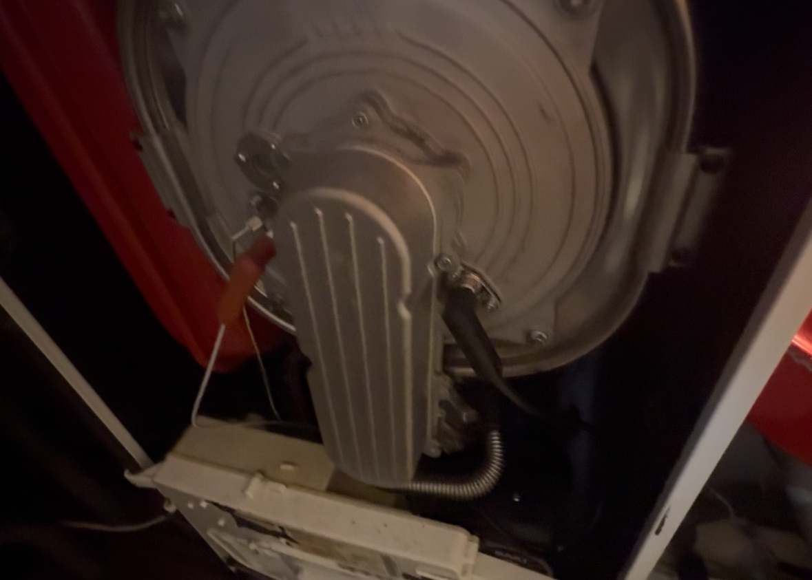

Hi, I have a Baxi Megalfo Compact which has been locking up with an E133 code. Each time the engineer comes over (about 8x visits now) he takes the cover off and we both stand looking at the thing firing up. Every time I point out the sparks jumping across from the black insulation jacket of the flame sensing electrode to the metal mounting point and suggest "that's weird" should you call Baxi tech support to see if they've seen that before.
But the engineer has another approach, just keep replacing parts. So far we've had new: spark ignition electrode, gas valve, flame sensing (electrode and cable) flame chamber earthing cable. Nothing's changed.
Has anyone seen this before? Any ideas? It feels like there's a huge voltage going down the flame sensing cable the spark is jumping a 4mm gap.

This is the current setup - took a pic on the last visit. The lead cap colours look ass-backwards to every Baxi I've seen online. I don't have a pic of where the leads are connected.

I think you’re correct. As I recall the red lead is usually on the right and the spark electrode is on left.you need to be gas registered to take off the combustion door remember
I thought this, but not 100%. If you search that boiler, there’s a photo where both sides are red/orange.
Thanks for the heads up, I'll get him back in next week and gently cough "could the cables be plugged in the wrong way round!!"
