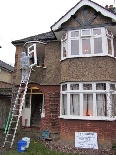

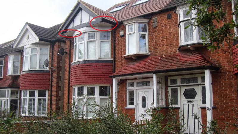

Onto my question though :) I have bay windows and my questions is regards the soffit around the bedroom bay window. They are the old wood soffits and they are rotting on one side and need replacing before this winter. I have taken this image from somewhere on the Internet to show why it looks like, as mine look pretty much the same...
The wooden soffits around the bay, are there any special requirements or considerations to getting them out or will they for example just slide out?
Also, regards putting new ones back in, how good would I have to be at cutting the shape? I don't have a jigsaw for example so would I need to buy one and get some practice in?[/img]
Are you serious? You live in a terraced house but it looks like a semi with an Oriel bay?
I am serious, my bay looks like that. That is not a picture of my house though, I took it from the Internet to demo what the bay looks like.
Technically, my bay is more rounded, but it does look mostly like that picture.
There is no way you'll be able to remove those tongue and groove soffits from under the bay overhang. They have to be carefully cut out around the window. If the window wasn't there they run all the way across the inside of the window and form part of the ceiling in the room.
