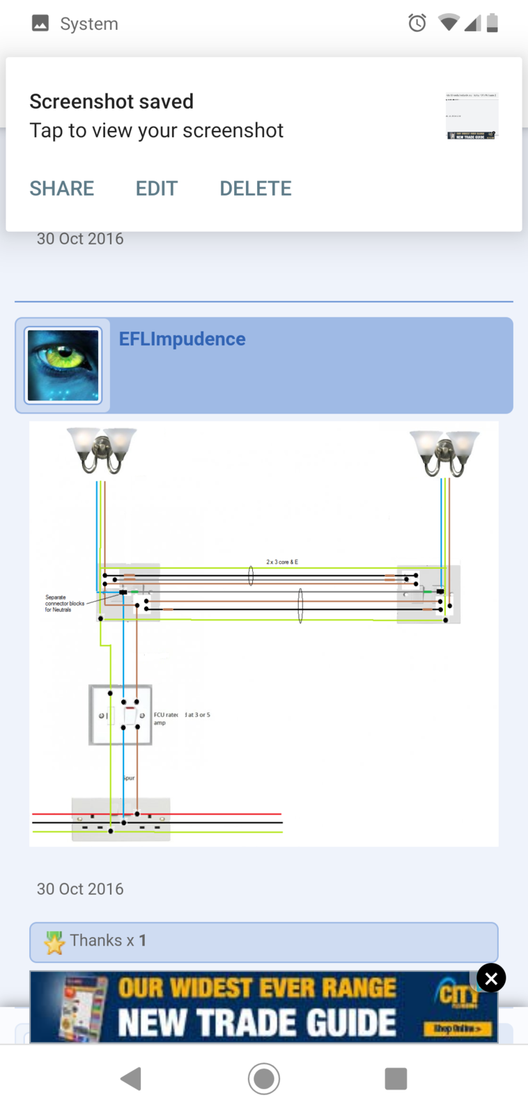

Morning, have had a fused spur fitted from new upstairs ring main for bed side lights.
Wanting to have two gang both sides of bed so that both lights can be controlled from each side.
Found this wiring diagram on this forum and just wanna check this is best way of wiring up as was never quite finalised.....
cheers muchly

do you want each light to be turned on independently ?
and 2 switches either side of the bed?
look up 2 way switch in the FAQ at the top.
If I could see that picture, it could well be correct!

Does it not open when you click on it? It is correct.
As for it being the best way to do it.
It does what is wanted, so - yes? :)
Apologies for any confusion, phone wasn't making it easy to post earlier....
Switch and light either side of the bed, both 2gang to operate each light independently from both sides. Hope that makes sense.....
Found the post with your diagram but can't remember there being a conclusion on the 'best way'

I'm not sure what would make anything the best way. It usually depends on what you have and the amount of work you want to do.
Morning, just one more quick check.
1.5mm from spur to switches (switch to switch also) or is 1mm ok?
1mm from switches to lights or can I get away with using some 0.75mm fabric lighting cable (purely for aesthetics)
Cheers muchly again :)
1.0mm is more than enough from the FCU to the switches. 0.75mm OK for the lights if the FCU is fused at 3 amps.

just to chuck in my tuppence worth. it might be easier to put the switches centrally just above the level of the headboard(its what i did for our two sidelights, main light and ensuite light) then there is no real need for two way switching as all switches can be reached by both bed occupants. the lights themselves can then be fitted with a 2A plug and fed from a socket at the bed side
