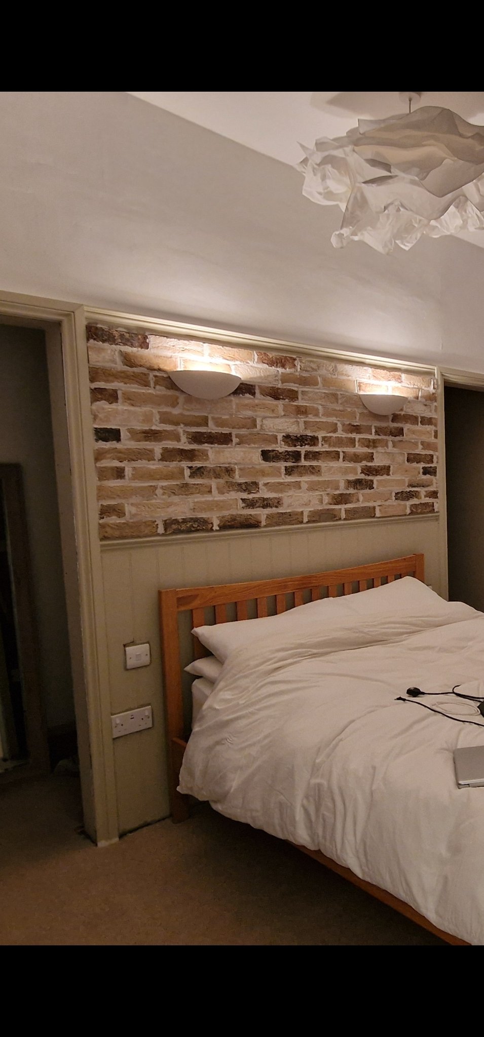

I've just realised there is an issue which is quite bizarre (at least to me).
I've been predominantly using the same switch on the left when using the lights, but just noticed, whichever switch is used to turn the lights from on to off becomes the main light switch.
If I turn on and off only from the left its fine. If I turn on with the left but off with the right, the left switch no longer functions but the right does.
To use the left switch again I need to turn the lights back on with the right switch and off with the left.
Whichever switch turns the lights off becomes the working switch.
Clearly I've wired it wrong. Has anyone came across this before?

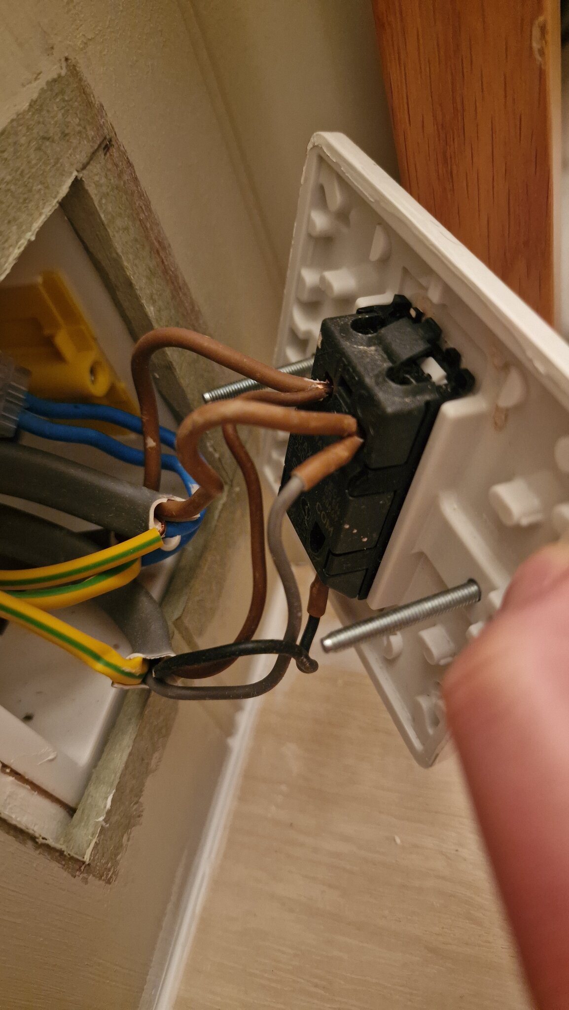

Yup.
This is the switch on the left:
and this is the one on the right:
Looks good to me, maybe a screw is catching the insulation and not the copper on one termainal? Or a faulty switch?
I feel like that cant be it, because it works systematically wrong (and ive wiggled all the wires).

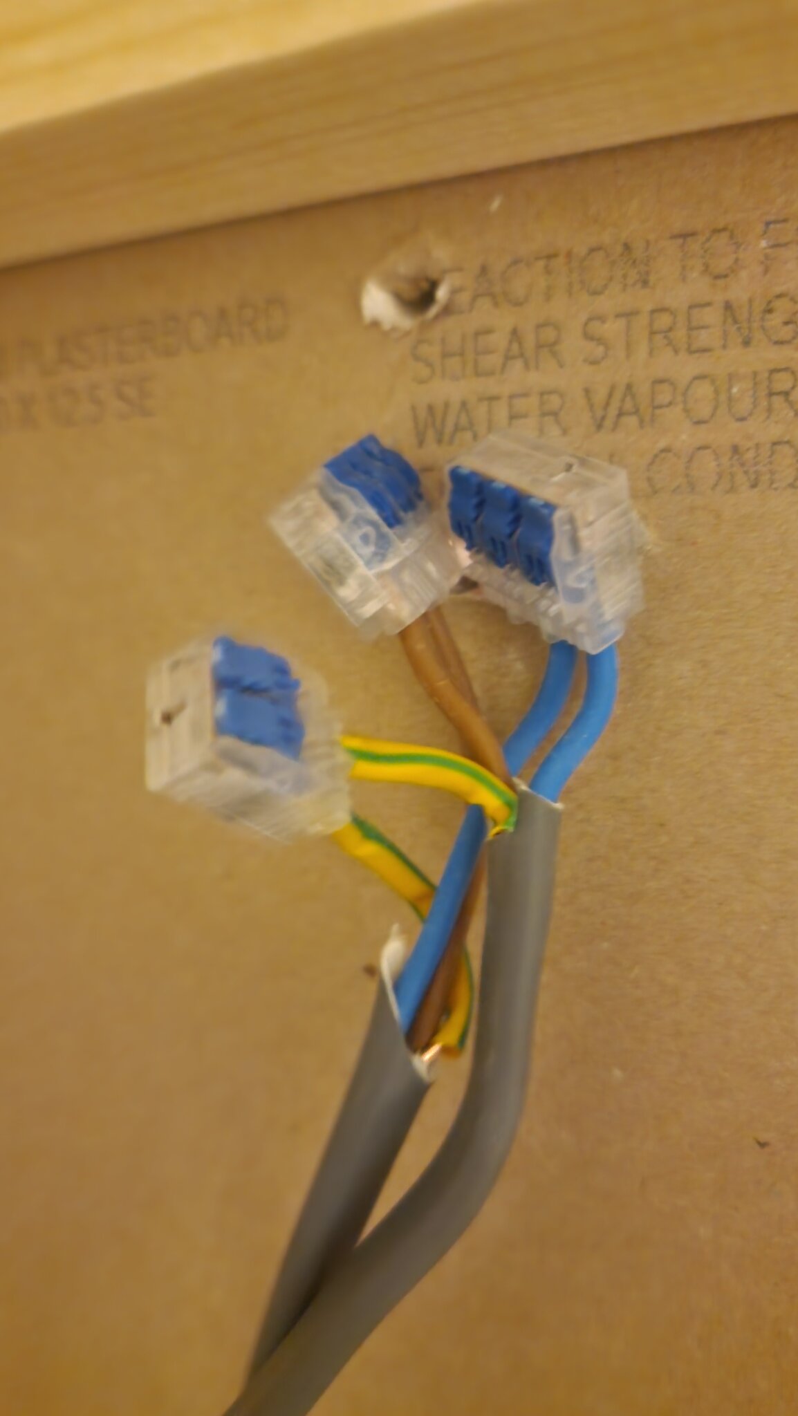

Would it have something to do with the lights themselves? They are 2 individual lights that I literally joined together with them snappy wire clip things.
Re-check all your connections, because you've connected the switches correctly

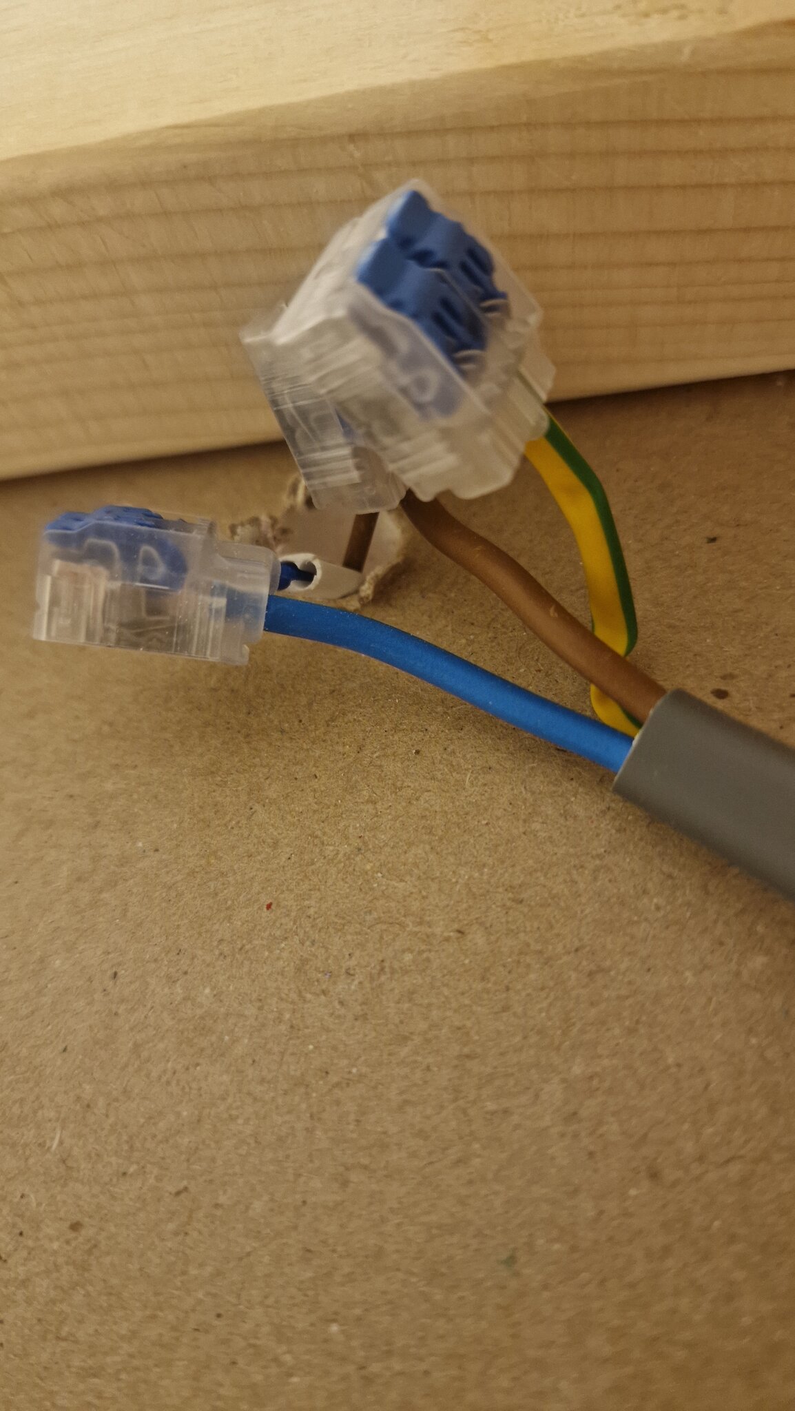

The only other thing could be the connector blocks... ill take pics of those
Left light connecting to right:
Right light connecting to left
