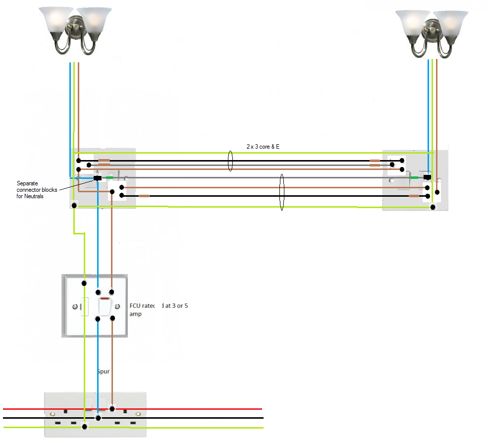

Hi, 2x 3 core is enough between switches.
1 live ... 2 Neutral ... 3 1x L1 ... 4 1x L2 ... 5 1x L1 ... 6 1x L2
Indeed, but I think that would require use of the 'old fashioned' method of 2-way switching. That's why I said that (if one wanted to use the 'modern' method, which would probably be less confusing to anyone who had to work on it in the future) one would possibly (I wrote 'probably', but perhaps that was wrong!) need a third cable.
Kind Regards, John
Why complicate ?
I think one could ask that question in relation to either approach. As I said in my last post, to have a situation in which one cable had L, N and one strapper, and the other had three strappers (or one had L + 2 strappers and the other had N + two strappers) could well confuse a good few people who subsequently found themselves working on the wiring.
However, either approach would obviously work, and your method would be 'simpler', even if potentially more confusing. It's therefore down to the installer's choice.
Kind Regards, John
<a wiring diagram>[/ATTACH]
Indeed, that's what DS is suggesting.
However, see my exchange with DS. I would be slightly uncomfortable with that 3-core cable containing two stappers plus N. If someone disconnected one of the switches and was then trying to reconnect it, if they did not fully understand what was going on (which I presume you would agree is not very conventional), there would be the potential for a 'bang' if they got it wrong - something which is never normally possibly with mis-wiring of 2-way switches.
Kind Regards, John
If people tamper with electrics without understanding what they are doing, then damage and destruction is inevitable regardless of how the circuit was installed.
I certainly agree that one does not need to design with possible future idiocy or ignorance in mind, but I also personally feel that one should consider whether one's design increases the risk of mistakes being made (perhaps by a DIYer) in the future (even though I accept that mistakes are entirely the fault of the perpetrator).
With standard 2-way switch wiring, there is one 3-core cable per switch, and if those three cores are incorrectly wired to the switch, the worst that can happen is that the switching will not work as intended [which is one reason why (contrary to the wishes of our previous 'policeman') suggesting to people "which wire should be connected to which terminal of the switch" is generally 'safe']. However, if one of the cores of the 3-core cable is a neutral, then the scope for worse things happening as a result of mistakes increases.
However, as I've said, it's just a matter of person choice, simply something that I probably wouldn't want done in my home.
Kind Regards, John
