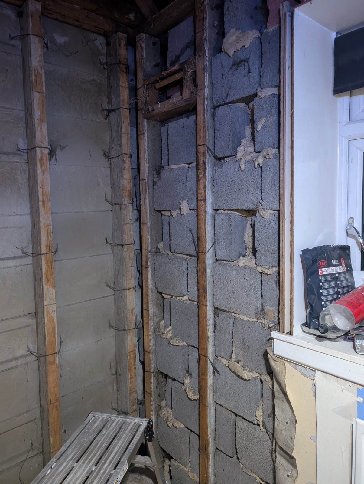

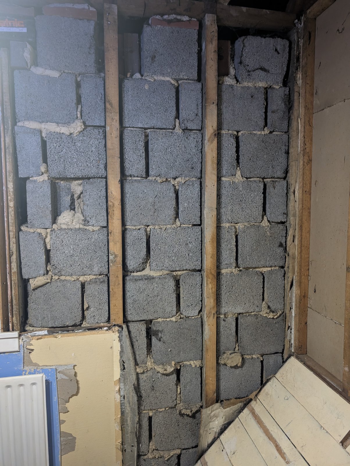

Hi all,
This is a block - cavity - brick wall that's facing outside (photos attached).
The depth of the studs is inconsistent, 80% of it is 35-40mm, closer to the ceiling there are a few spots of 15-25mm.
1. What would be the best option to insulate it?
PIR and just shave of the back to make it fit or something else?
2. If I have space, could I combine the PIR between the studs with an insulated plasterboard on top?
3. Also, can I fill the gaps between blocks with expanding foam for better insulation or should I put some mineral wool in there?

If space, to make a noticeable gain I’d deffo go with more like 50-100mm PiR, framed/trapped to existing battens/masonry with battens then normal plasterboard rather than bothering with insulated board.
Edit: just zoomed in on the photos, what the hells going on with that blockwork !
So increase the depth of the studs by adding battens to the existing ones and just plasterboard on top of it?
What about the existing gaps between blocks? Should I use expanding foam or put some mineral wool in there?
Yeah, that block work is crazy...
Assume that’s a timber frame with block infill?
There’s loads of ways you could do it, could start again with a 2x2 frame with say 50mm PIR behind it and screwed through into the existing studs. Then another 50mm layer between the new battens. That’d be pretty easy but lose you at least 100mm. Or you could put PIR between the existing studs and go from there. Or several other combos along similar lines. And dependent on how plumb the existing studs are

That's correct, it's a timber frame with block infill.
Because of how bad that blockwork is, the depts of the frame is smaller in certain places, can I shave off the back of PIR so that it fits flat?
What about the existing gaps between blocks? Should I use expanding foam or put some mineral wool in there? Some of the gaps are huge.
Foam gaps - yes
Shave PIR - I wouldn’t, as I said above, just do it in such a way as that’s not needed
Foam gaps - yes
