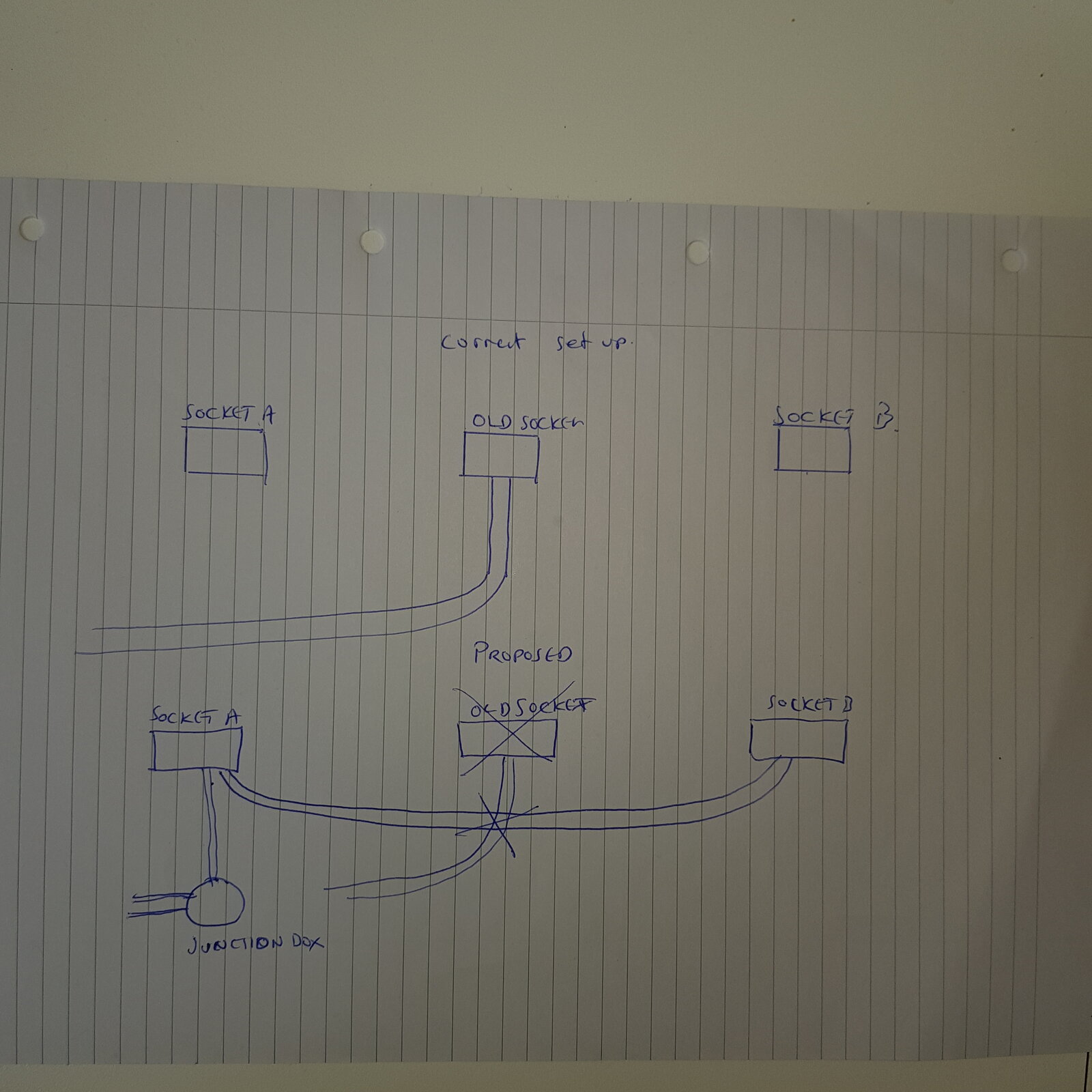

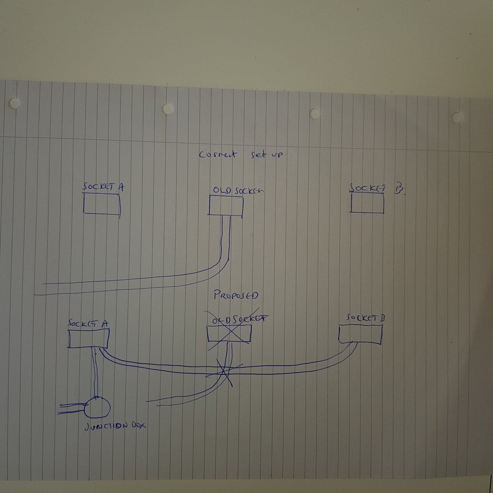

Here is a cave man drawing if that helps

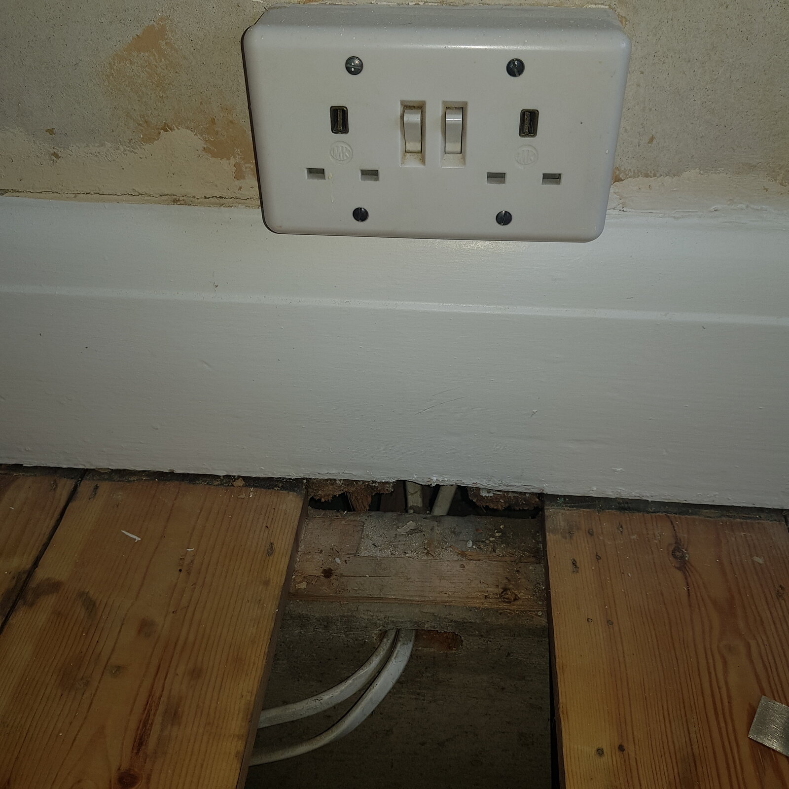

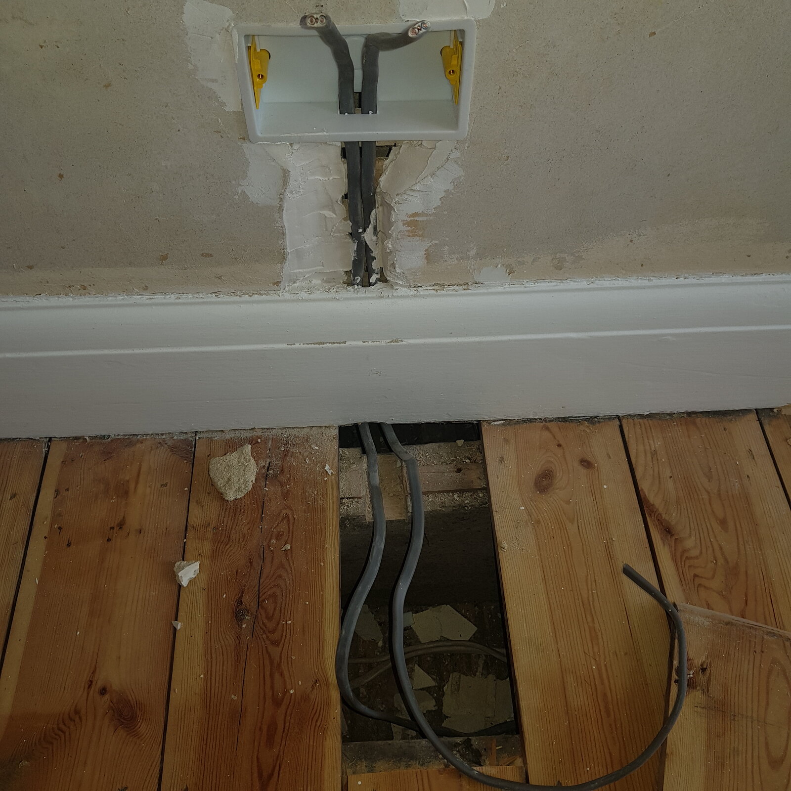

Puc of old socket and socket A

1. Well the most complaint (ish) option is to fit a blank plate over the existing socket and use it as a junction to join all 4 cables. But that's ugly.
2. your proposal. I think the regs say you shouldn't spur from a spur. But IRL its not going to be an issue in a bedroom.
3a. you could take 2 new cables down (one from each socket - even if B passes thru A untouched.) And then join the 4 in a junction under floor
3b. As 3a, but add another cable between the new sockets so that are within a ring. Have 2 junctions under the floor and maintain the ring thru the new sockets. More complient with the regs, but for me 2 junctions under the floor on a ring is asking for reliability problems in the future.
Are the existing cables stranded? stranded bits of cooper or one solid core as modern 2.5mm
Can you not split the cables to old socket, put one to socket A and one to socket B and then a new cable between the two to complete the ring or just put both cables to socket A and then a single cable to socket B as a spur? * I’m not an electrician!
Having seen the pics, I would solder the existing wires (as a temp joint) to one of the new cables, tape over it slightly and use that as a draw to pull the old cables into the new box A.
Then have B a spur from A with one cable
Here is a cave man drawing if that helpsView attachment 204540
In your drawing you only show one cable going to the old socket. Is that really true? On a ring, and usually on a radial, there will be two cables.
If the cable route you show is accurate, it will reach new socket "A" without needing a junction box, if you pull it down into the floor and reroute it.
@AndyPRK I am 99 % sure that existing cables are solid. I haven't removed them yet though. Soldering and bringing up cables through the wall is not an option because access is tight. I would have preferred yo have done that but going up into the skirt rather is going to be harder then coming down. So now I'm left with spuring off a spur from a junction box for two bedside wall sockets...
@Mottie I'm not sure I can do that again pushing the old cables back up the skirt would be a difficult thing...
ah, and they both come from the left :(
So you could put them both into socket A, maintaining the ring, and run a new spur to socket B in new cable.
Junction boxes are undesirable, and junction boxes hidden in the floor are very undesirable.
@JohnD that's what I wanted to do Originally.
Two cables from old socket to socket A then spur from socket B into socket A.
Bu then I realised that the access would be so tight that I would end up taking the skirting board off which I didn't want to do.
So i went for plan b which was to terminate ring into a junction box, then spur of to socket A then connect A and B via spur as well....
