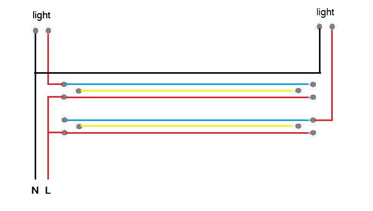

I'm having various thoughts about whether to go down this route or just control the side you are on with the switch on that side.
If I were to contemplate this could any one point me in the right direction please?
I'm not mounting the lights directly on the wall (as I don't want to run the cabling inside the studded wall and have big holes in the plasterboard if we decide to move the bedroom around) so I have 2 x 2gang sockets on either side of the bed that my thoughts were to use a plug to provide power to the lights either side. Lights are going to have LEDs in or low wattage bulbs and I'm going to install switch's to turn the lights on and off.
Can be on separate plugs or split from one, either way.
It would be handy to be able to turn her light off from my side if needs be but I'm confusing myself and need abit of clarity how it could be done.
Many thanks
If you wanted two way switching you'd need to run a three core and earth between the switches. You'd be best off using 5amp lighting plugs to fed the lamps
This is what you will need:
CPCs(earths) not shown.

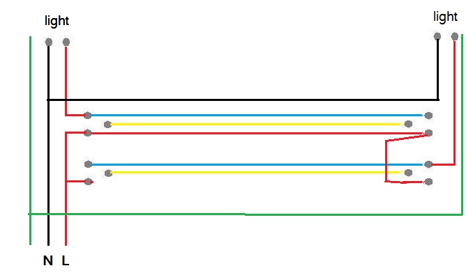

You could do that on just the lower cable in my diagram which would leave the same number of wires.
What is the point of doing it as well on the upper cable?
Having the same circuit arrangement on both lamps would make it a bit eaier to understand when any work is needed in the future.
Could reduce by one core ( and thus get the neutral into one of the triple and earths ) by combining the two permanent Live strappers into one.
That's why I didn't do it.
Ooooh, never thought of that.
That would confuse someone in the future.

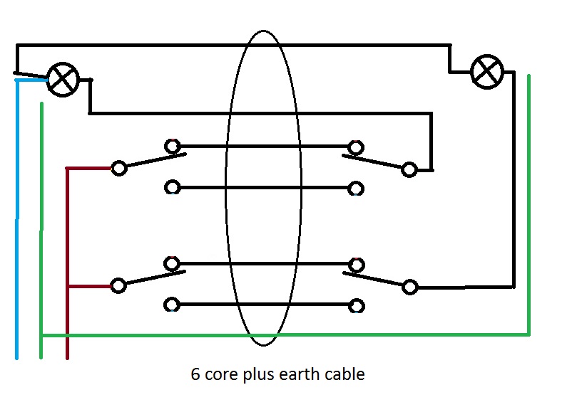

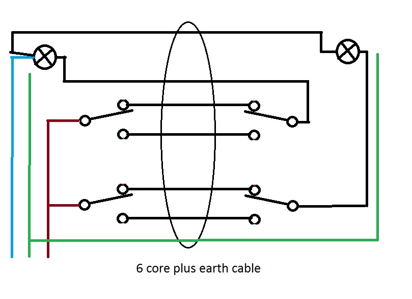

An alternative using a single cable is
using 6 core plus earth cable https://www.tlc-direct.co.uk/Products/CA0dot75F7.html
The cable has 6 black cores numbered 1 to 6.
The five cores connected to the switches should be sleeved with Brown as they are Live or Switched Live
The core connecteing Neutral to the lamps shopuld be sleeved Blue
Good solution! Although having said that unfortunately unless the OP is going to ensure the cable is fully accessible for inspection they can't use flex for permanent wiring. However there's nothing wrong with two 3core as long as all conductors are clearly identified at both ends. The discussion about confusing people in future illustrates that we need adequate labelling of conductors and probably a diagram.
