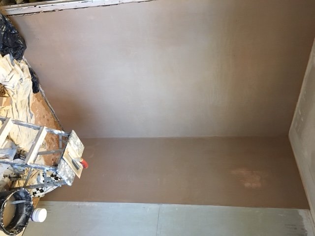

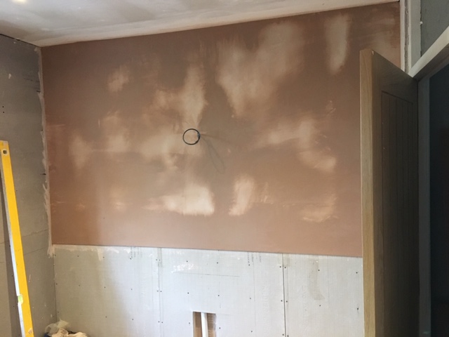

I used Hardibacker and then used a stopbead to plaster to. Then I have a nice clean edge to tile to and put the trim against.
You have to make sure that you get it 100% level before you plaster though so that the tiling is all level.
And the hardiebacker sucks like you wouldn't believe, so plenty of SBR or whatever suction control you decide on.
I'm only DIY so I may be wrong, but seems to have come out well and is well adhered.
