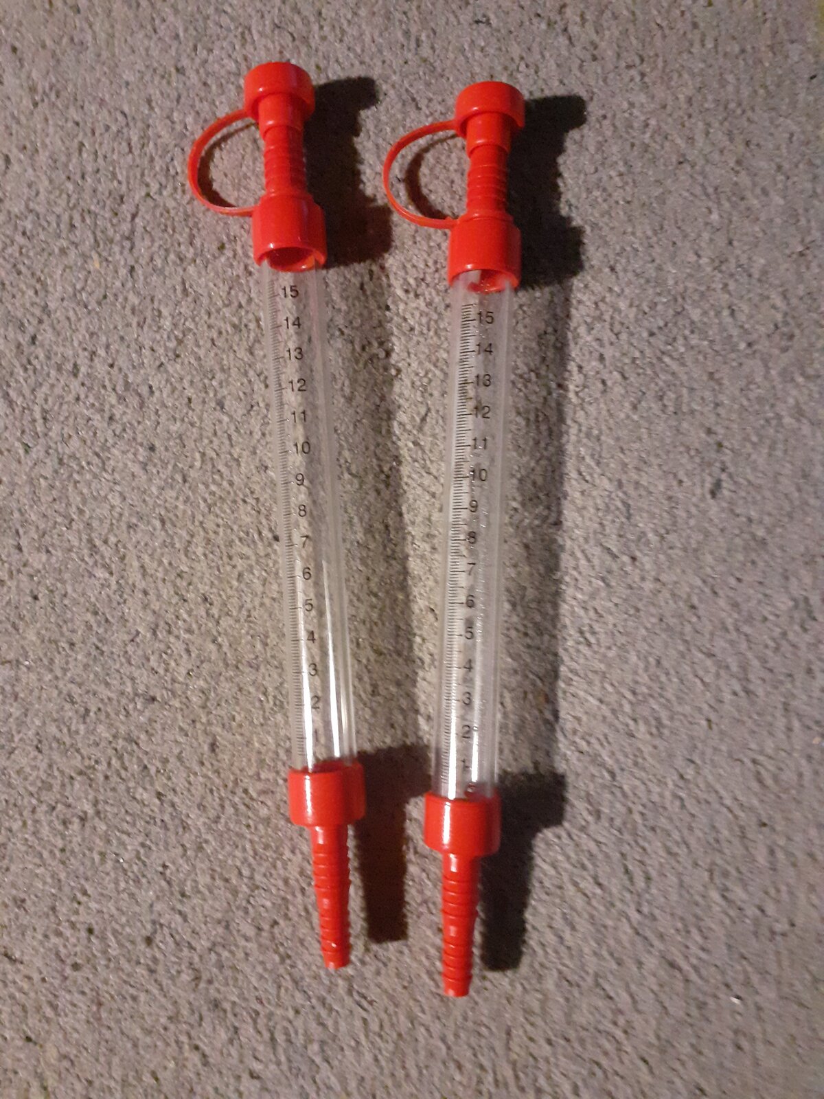

Fix both vials on the hose with valves open and fill the hose with water until water is about half way up the vials when both are held together. Close the valves/fix the tops. Fix the apprentice's vial to the wall (or wherever your datum is) so that the water meniscus lines up with the datum. Feed the hose out to where you want the datum to be transferred to. Lift the vial to where you think the datum should be and get the apprentice to open the valve at his end. Slowly open the valve at your end and watch if the water drops or rises in the vial. If the water drops lower your vial, if it rises lift your vial - adjust the position of your vial until the meniscus is at the middle of the vial. Get the apprentice to read off the difference between the datum and the menuscus (the water level I have is graduated in 1mm increments) and let you know so you can mark the actual datum correctly. If his meniscus is, say, 8mm below the datum then you need to mark the datum at your end at 8mm above the menuscus as well
Bear in mind that I haven't done this for a while, but basically that's how it works - sort of
Both Stanley and Stabila still make the vials, but they no longer do the fancier type with proper valves, but the graduated vials make transferring differences a lot faster
