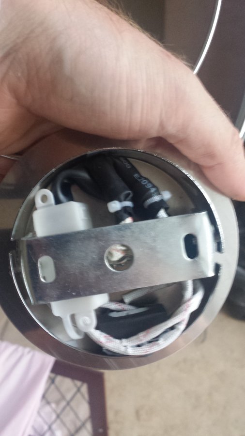

Here's a photo of the back of the fitting.
Oh no that looks like an awful 'Class 2' metal fitting, almost impossible to install unless you have only 1 0.75mm 2 core flex poking out of the wall.
Can you throw the fittings away and get some lights that have been designed to be installed?
Are you technically allowed non-sheathed single core wires and un-enclosed wagos within a metal class 2 fitting?
May look terrible, but one way to accomodate the wiring may be to fit a round pattress or besa box behind the fitting.
No you are not, which makes trying to fit this sort of light very difficult. All the single insulation must be contained inside the pathetic little plastic enclosure supplied with the light.
The suggestion of a back box is a good one, a plastic lid over the connections will conceal the single insulation.

Quick update. I've managed to use a Wago lighting box, 2 cables in and 2 out with a terminal block inside rather than push fit. Can just about get it in/out of the wall behind one of the new wall lights, with about 5mm to spare!
