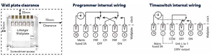

The controller/programmer's data sheet (https://www.draytoncontrols.co.uk/sites/default/files/2812_D41-11_LP & LPSi Data Sheet.pdf) has the following wiring schematics, which I'll admit to knowing very little about -

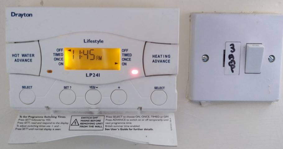

There's a wall switch with the 3A fuse, next to the heating and hot water controller. Turning this off turns off all power to both the controller and the gas boiler (at least the boiler's LCD display goes off).
I don't think there's a problem with that switch's 3A fuse; It's still working, otherwise the controller and boiler's display would be off, right?

A replacement room thermostat is £16, so I went and bought a new one (same model) and put it on the same wall mount plate. Then, with the programmer/controller enabling central heating, I noticed that this thermostat now did have a demand click, only the boiler still wouldn't fire up, yet it still fires up when the controller enables hot water.
However, a day later, still with the new thermostat fitted, I again turn the central heating on and go to waggle the thermostat dial and notice it now has no click in any position, which is a bit puzzling. I take it off and still measure 241V across live-neutral (when the controller sets C.H. on; 13V when off). Should I be able to test if the new thermostat has inexplicably broken within a day or is still working by (carefully) connecting it to a normal mains power socket and checking that it clicks?

I'm wondering if there could be a problem with the thermostat's connections to the terminals on the back plate: Can I bypass a problematic thermostat or wiring and simply wire the thermostat's 'live' to 'call/3' terminals to just always signal demand?
Then, even with the thermostat circuit always signalling demand, if the central heating still doesn't fire up, where would that leave a problem?
Could I, for example, hard wire the room thermostat demand signal right on the programmer/controller's back-plate terminals, eliminating/reducing a wiring problem somewhere on the way to the room thermostat circuit?

S30 is a status code, which means it’s waiting for the room thermostat for demand, however the thermostat won’t likely be wired up directly to the boiler. When testing, you need to test the switch live, so between neutral and 3, but if your new one isn’t firing the boiler, then it’s likely to be the Honeywell 2 port. If you remove the head, or latch the metal lever into the manual position, you can have a little heat when requesting hot water.

Once the CH is programmed on then there will allways be 240V between L &N, but ony 240V between terminal 3 and N when the stat is calling for heat or you turn it up and it clicks.
"The roomstat should make a click every time you change the setting up and down around the room temperature, is it doing this?": No it isn't. The only time I've had the room thermostat give me a click since investigating this problem was when I bought a brand new replacement and fitted it. Then, when putting the central heating on at the programmer, I twiddled the thermostat dial and got consistent clicks around the expected temperature marking, but still no boiler fire-up. I retried this all again the following day and no clicks any more.
"When testing, you need to test the switch live, so between neutral and 3": Oh, I wasn't aware that this would be relevant; I thought the thermostat's wiring schematic shows it just completes the connection between L and 3 (when above the set temp.), across which I should expect around 230V.
I have again multi-metered the room thermostat terminals and read 240V across L-N and 215V across L-3/call (only when the programmer's C.H. is set to on).
My meter reads 15V across N-3 with the programmer's central heating on.
