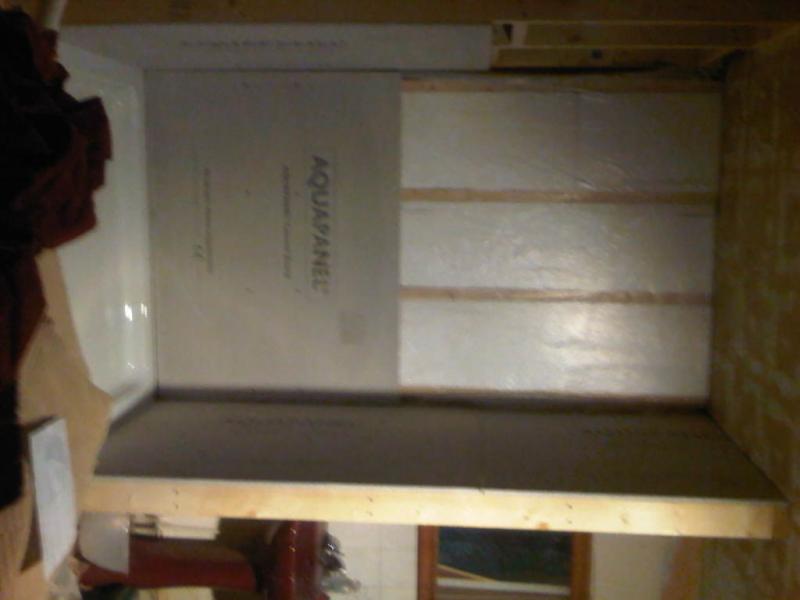

Thanks for the comments. Here's a picture of the cubicle under construction - please forgive the poor phone-camera quality and the fact it's rotated, but hopefully enough to give an idea!
The bevel on the tiles is quite wide as they are the "subway/underground" style. Sounds like I'm best off edging the sides, and having a full tile along tray and at the top then, cheers.

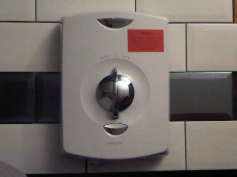

...and here a picture of what I'm trying to achieve with the tiles...
One more question - if I tile down to the tray, how much of a gap should I leave for final sealing?
Not sure how you are putting the tray in but you should apply clear mastic to all edges of the tray that meet the Aquaboard, smoothing off around the top of the tray then start full tile from the tray and work up. I just go full tile on and my mastic man seals around the tiles. In effect you would have 2 layers of mastic making the tray watertight.
If you want to go for a tanking system there are many on the market
I have fitted the tray by just placing it on the floor within the studwork enclosure (it stands on its own adjustable legs), and then I have butted the panels down to the top of the tray. There is a 2 or 3mm gap between the top of the tray and the bottom of the boards.
So I'll fill that small gap with the sealant, then tile from the top of the tray, then seal again.
