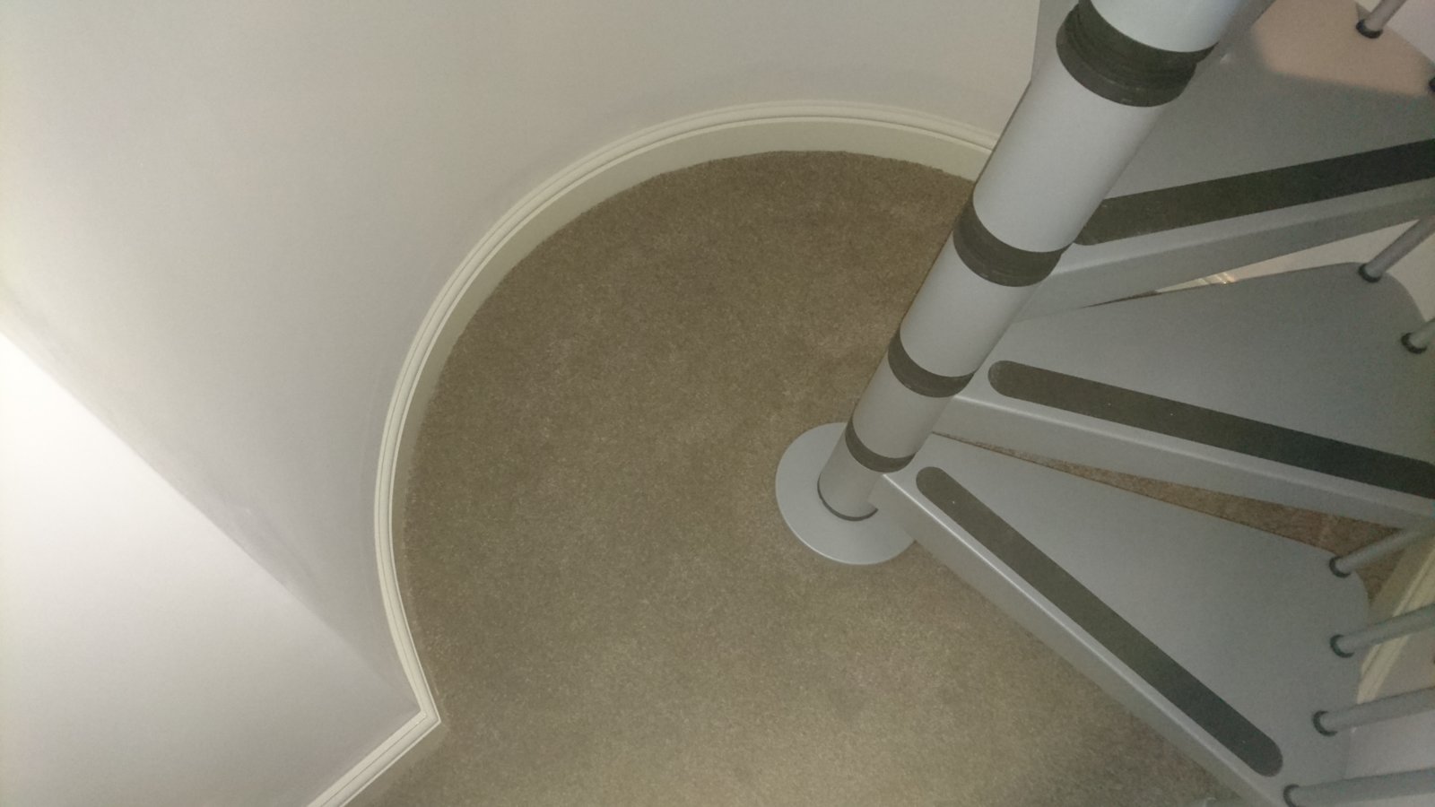

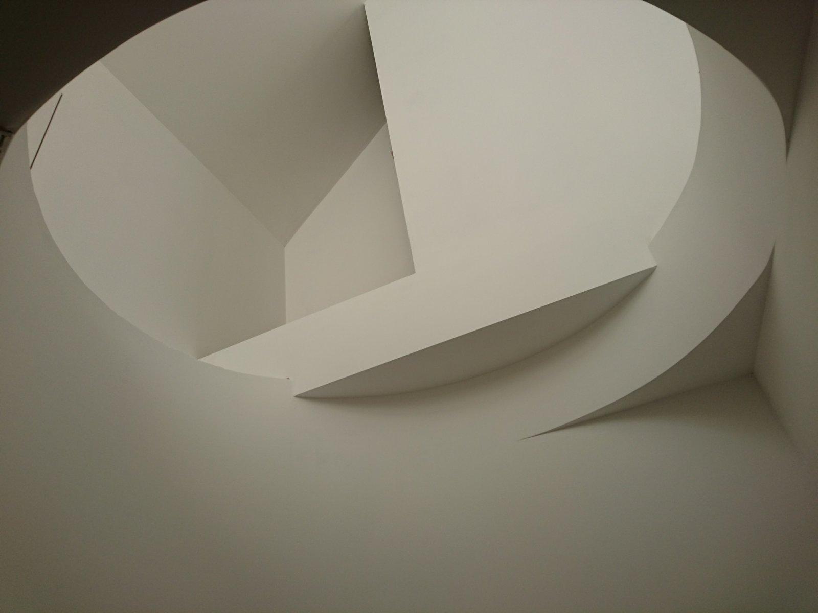

get yourself a sheet of ply or an area to create the bend mark the shape of the bay on to it and start bending graduly wipe the back with a damp cloth after each bend and leave for a few hour and so on
its how i done the skirting and plasterboard to this
Very impressive bob, nice and tidy!
