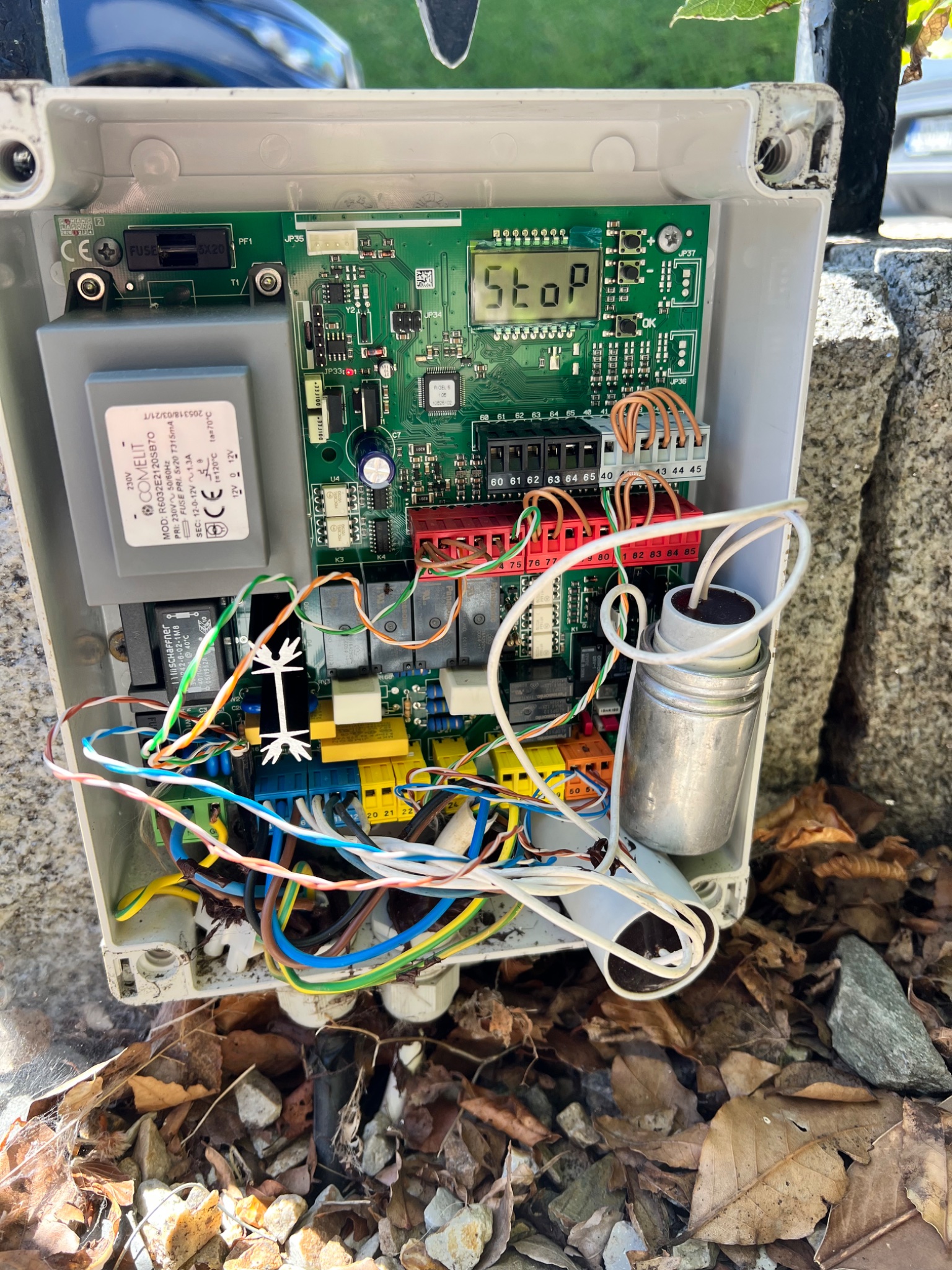

Hi there, I've inherited BFT electric gates on my house and this morning they wouldn't open. Hasn't rained, fob seems ok (lights up as usual) but when I opened up the control unit I can see it says STOP. Any ideas? Attached is a photos. Really can't afford to be calling someone out so hoping I can fix. Thanks!

Turn it off and back on again....failing that have the the sensors been knocked out of line somehow?
Im no gate expert just thinking of the basics.
Thanks. I tried that. Switched it off and back again. Sensors look ok and don't think anything hit them, etc. As far as I know nothing has changed since they last worked.

Bottom right may be a battery, and may need unplugging to reset, but likely you will need to revert to manual operation. The problem is both opening and closing there are often trap points, so there has to be a manual release, which means the gates are not secure.

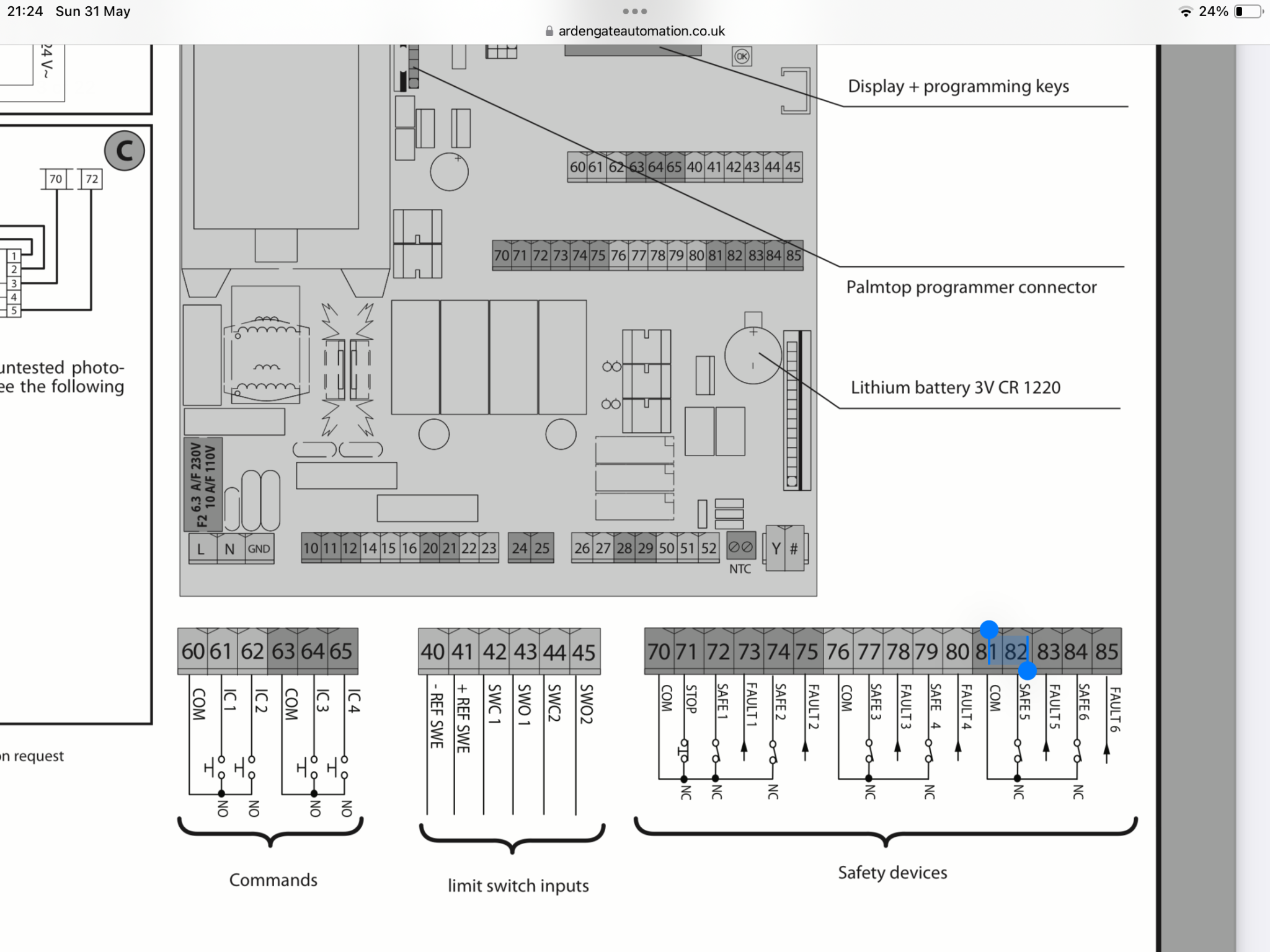

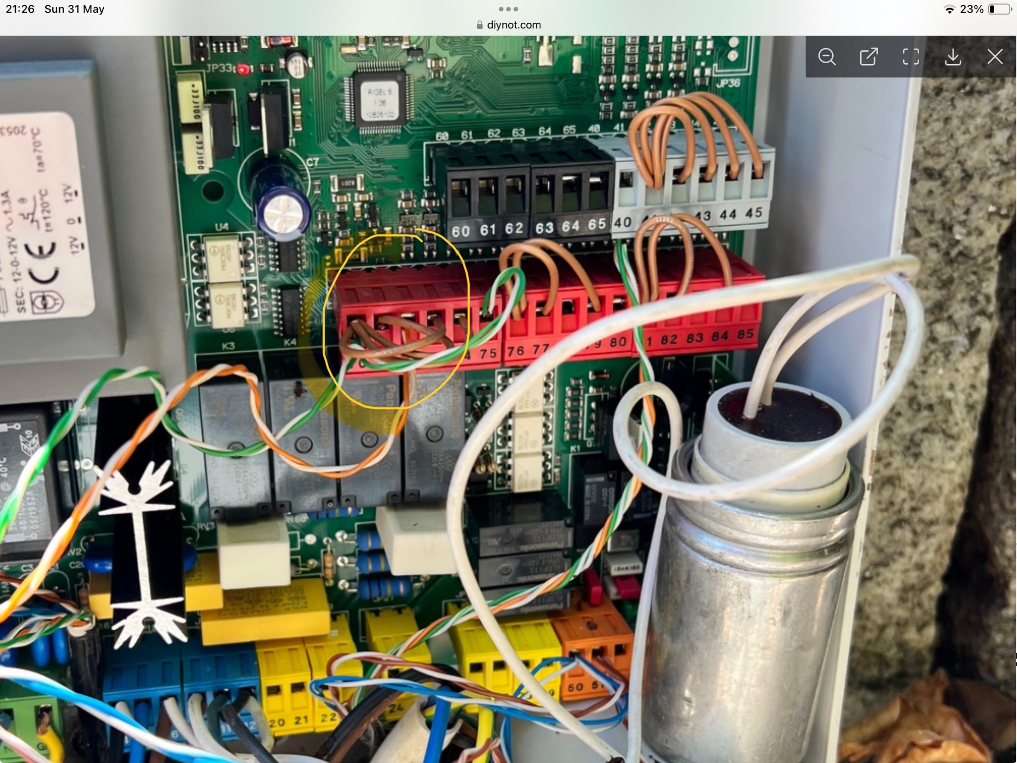

What ever is wired into 71 the stop input ….or the wire to bypass the stop is loose

Hi, you were right about 71. The wire was loose! That's all it was and now all is good. Thanks a lot for everyone's help!
