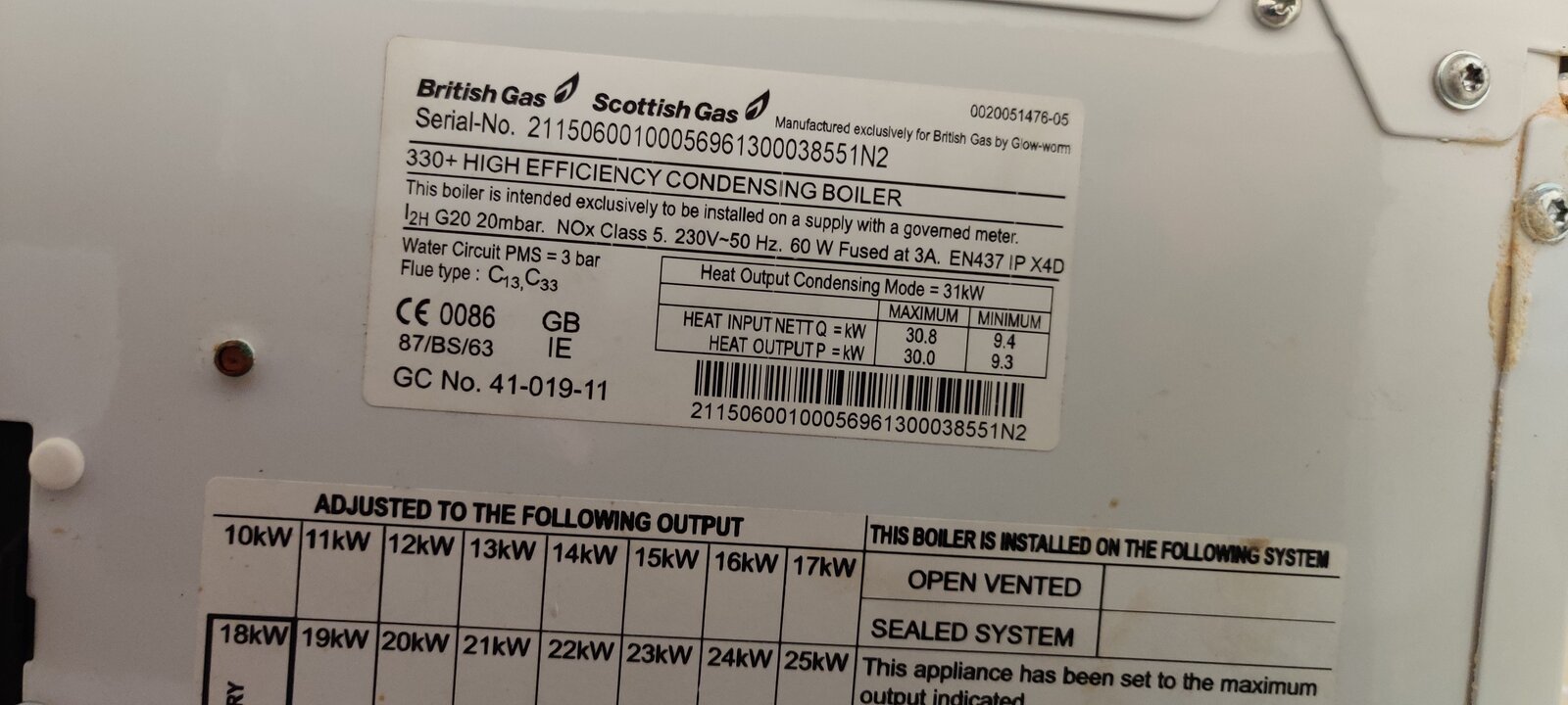

5 years old? What is the boiler serial number? Don’t think these have been manufactured for about 10 years
Installed 20/3/15. Here's a photo of the serial number if it helps.

Going by serial number if same as Vaillant, you’d be correct.
Yes that serial is 2015. Noise from them is often the gas valve at fault. It is a Glowworm ultracom 2. Badged as BG
