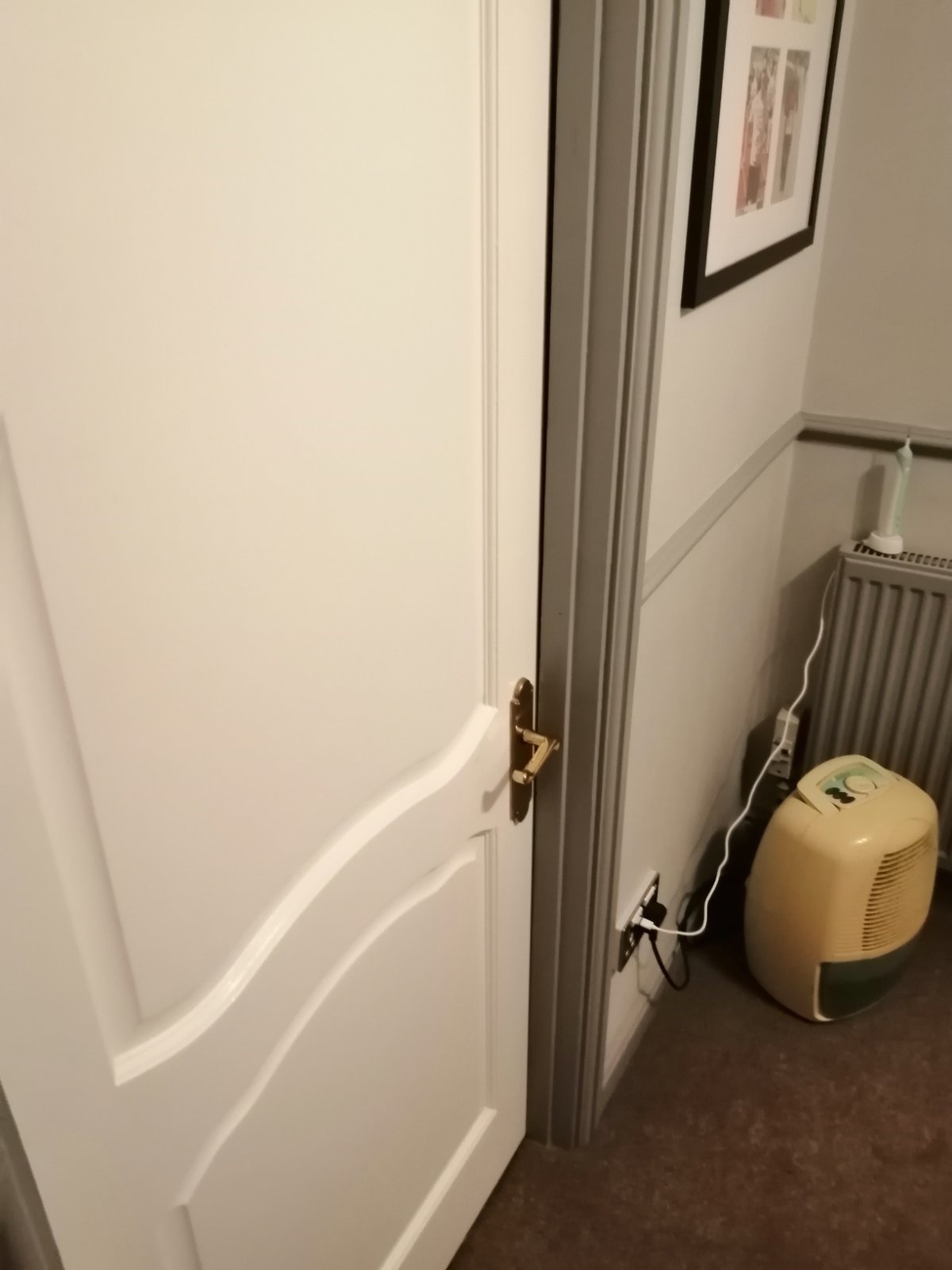

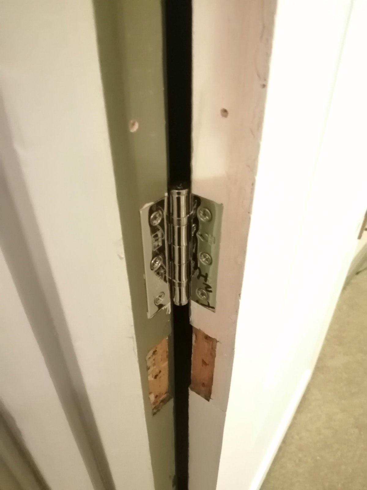

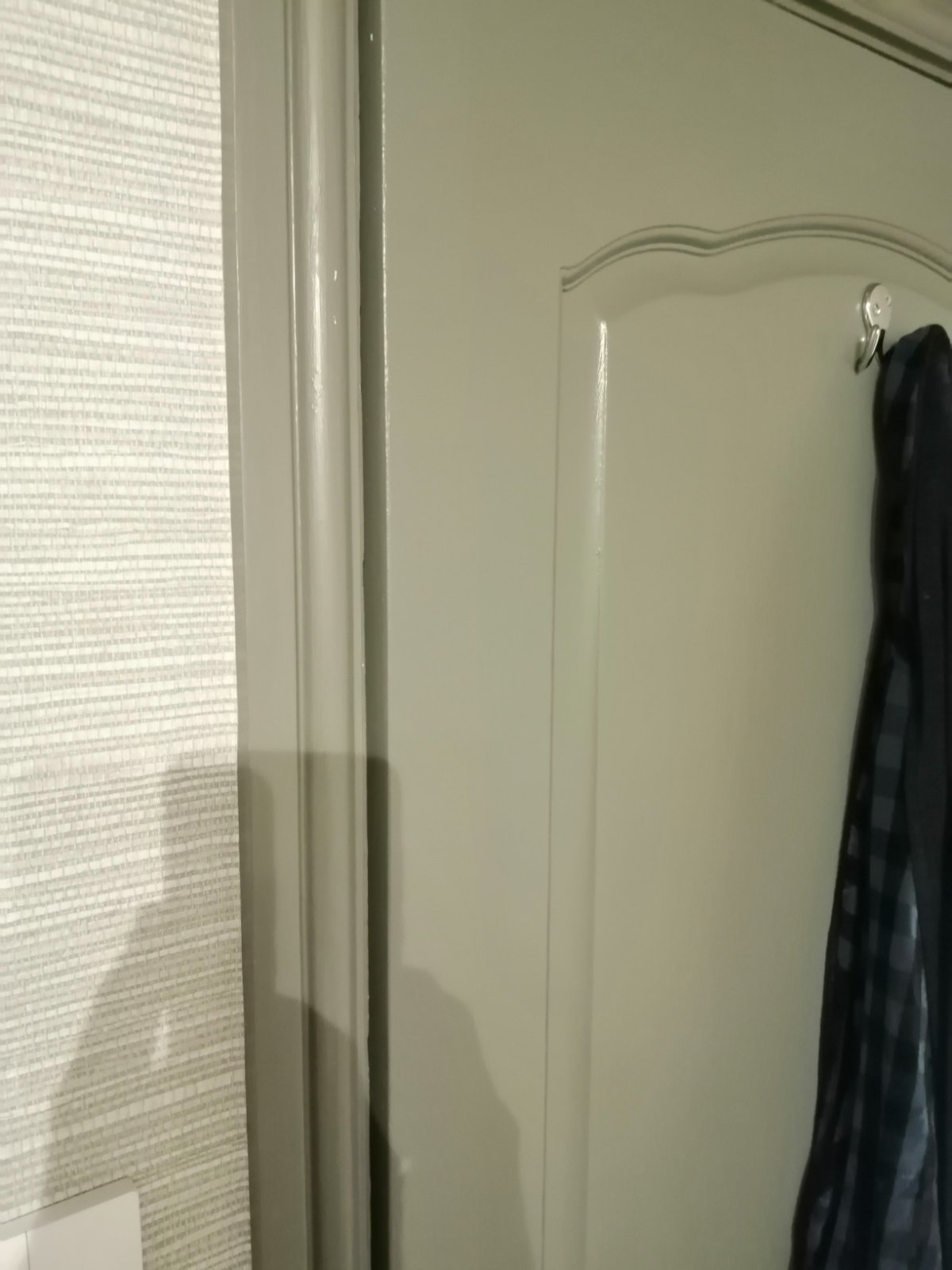

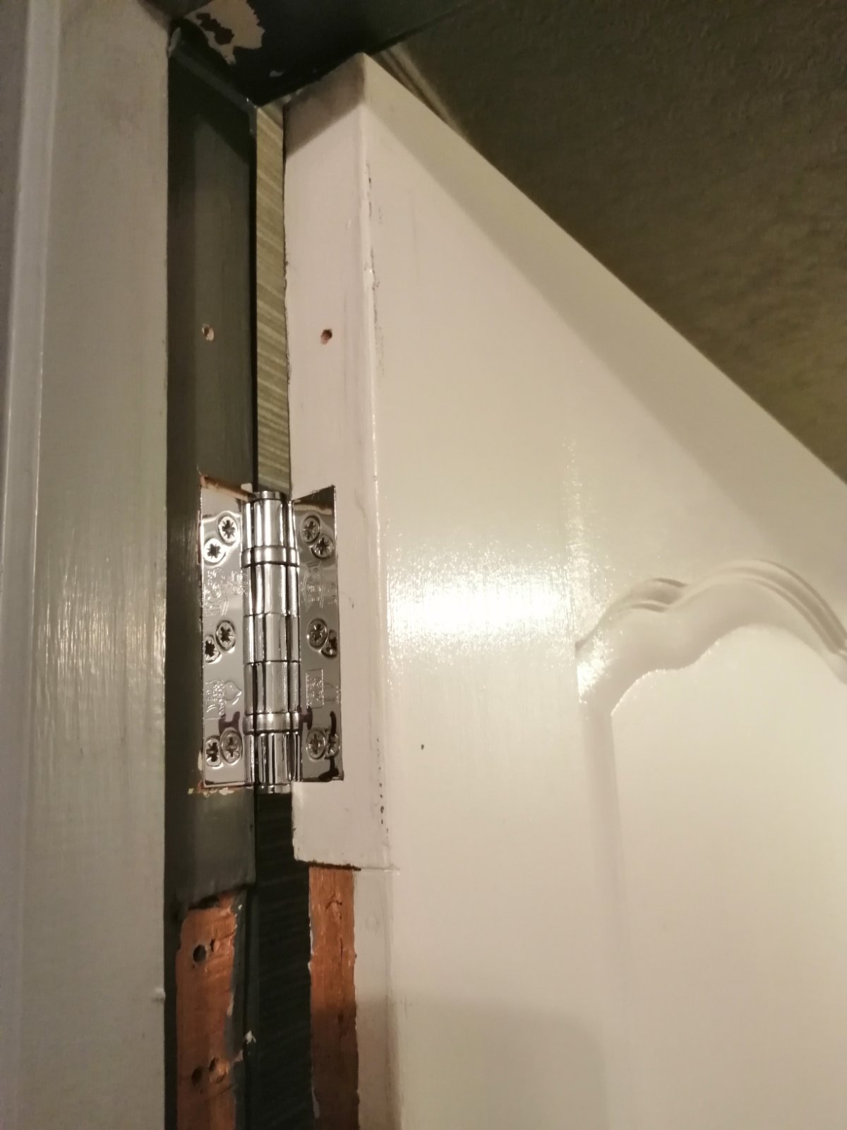

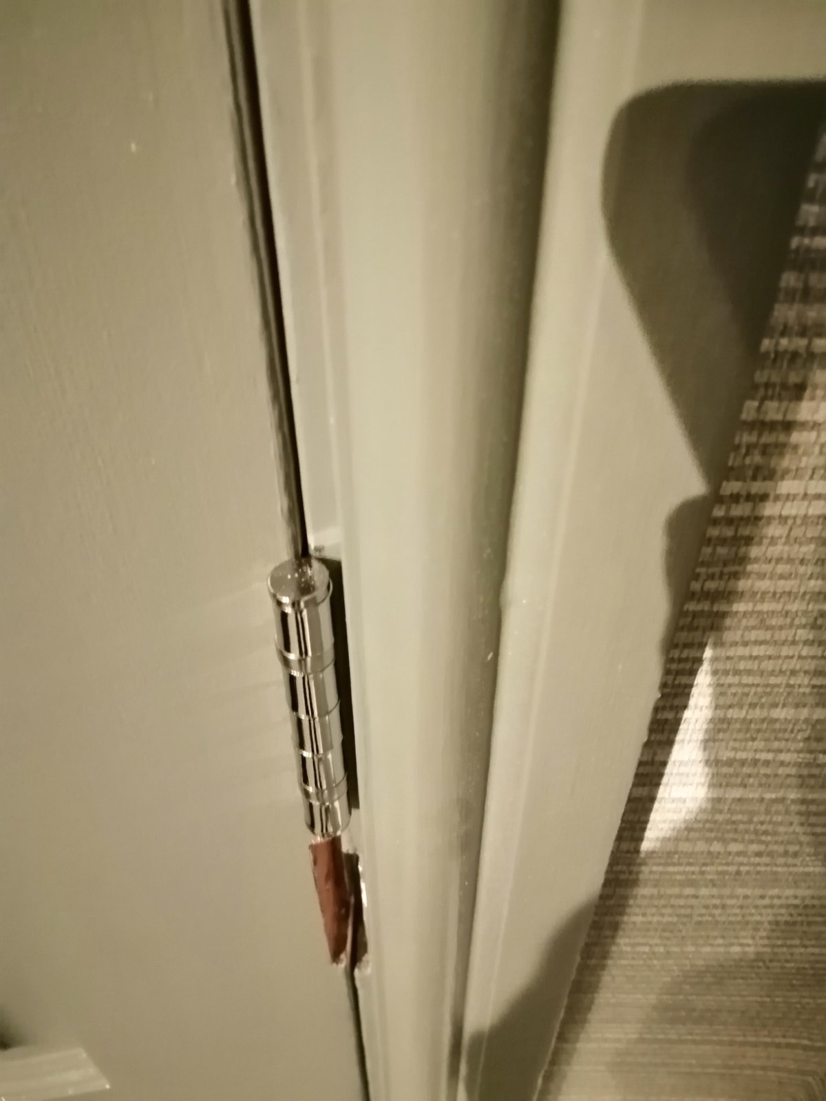

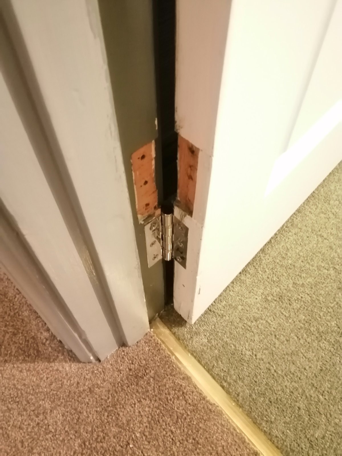

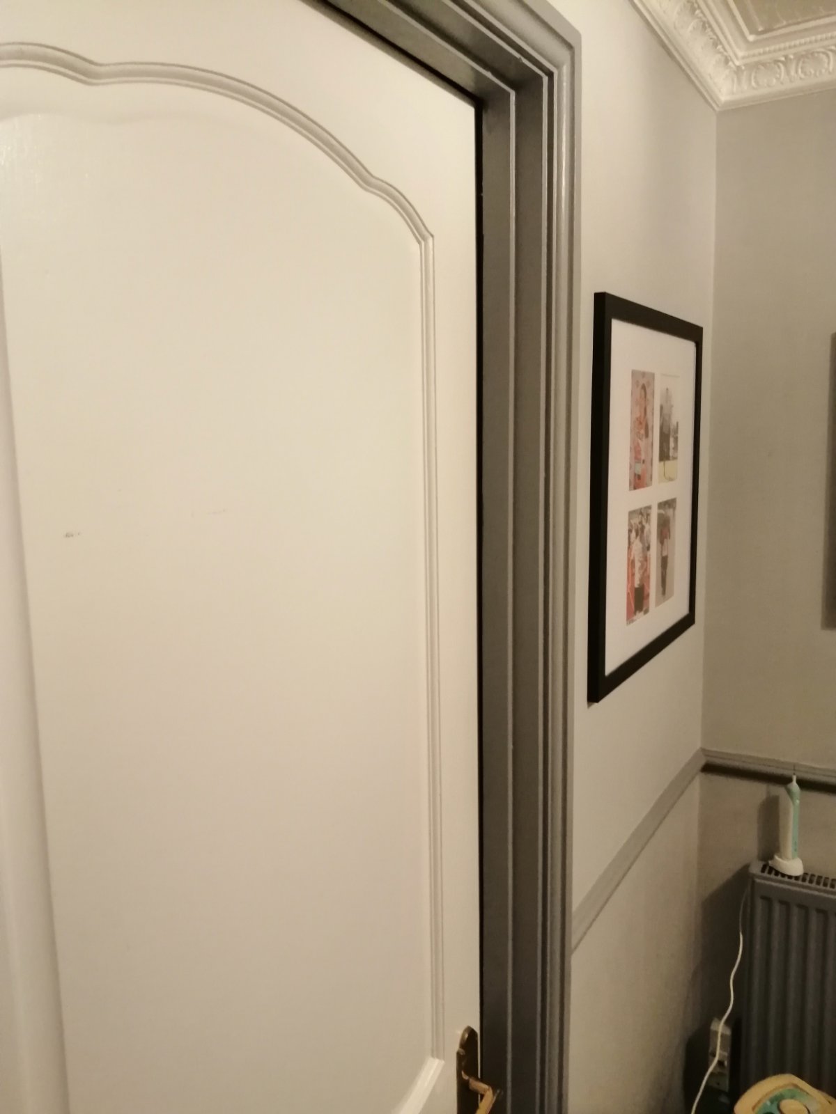

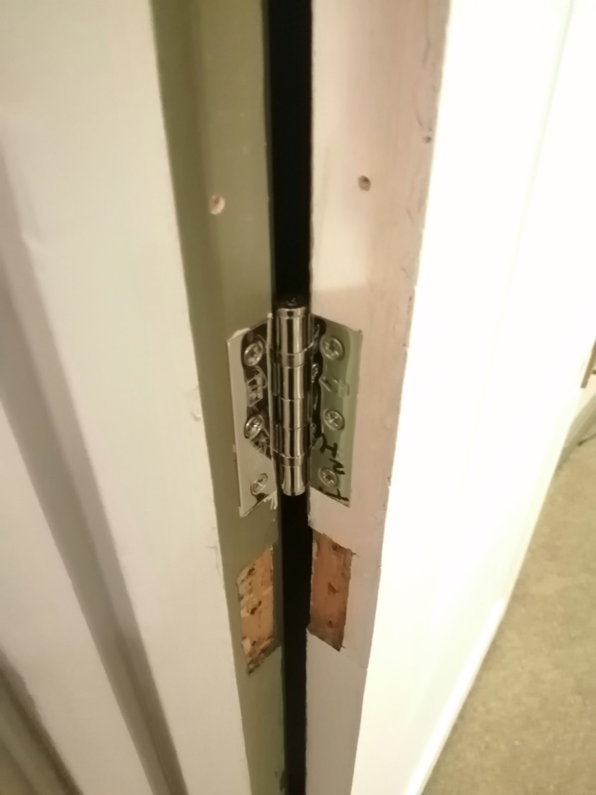

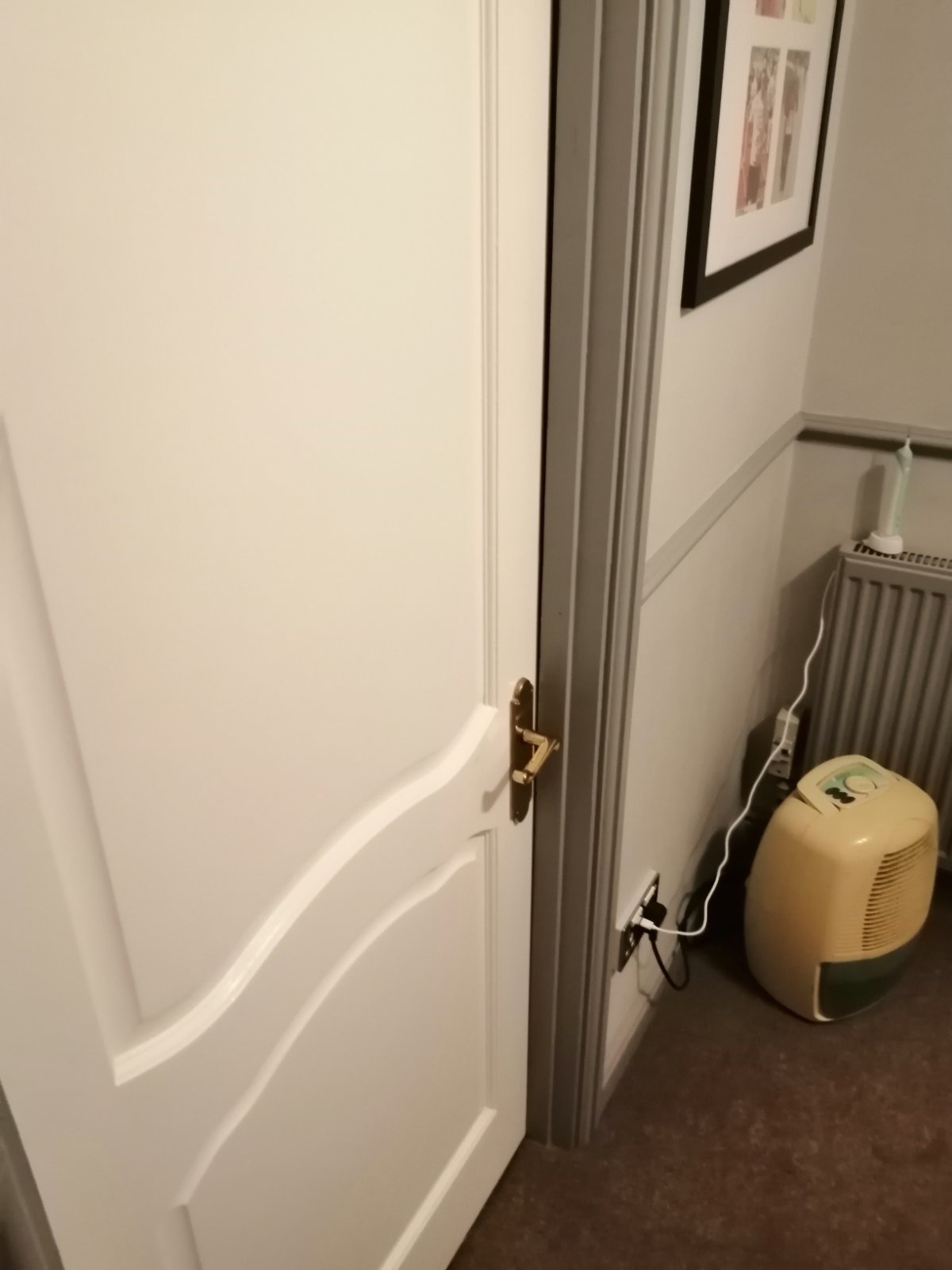

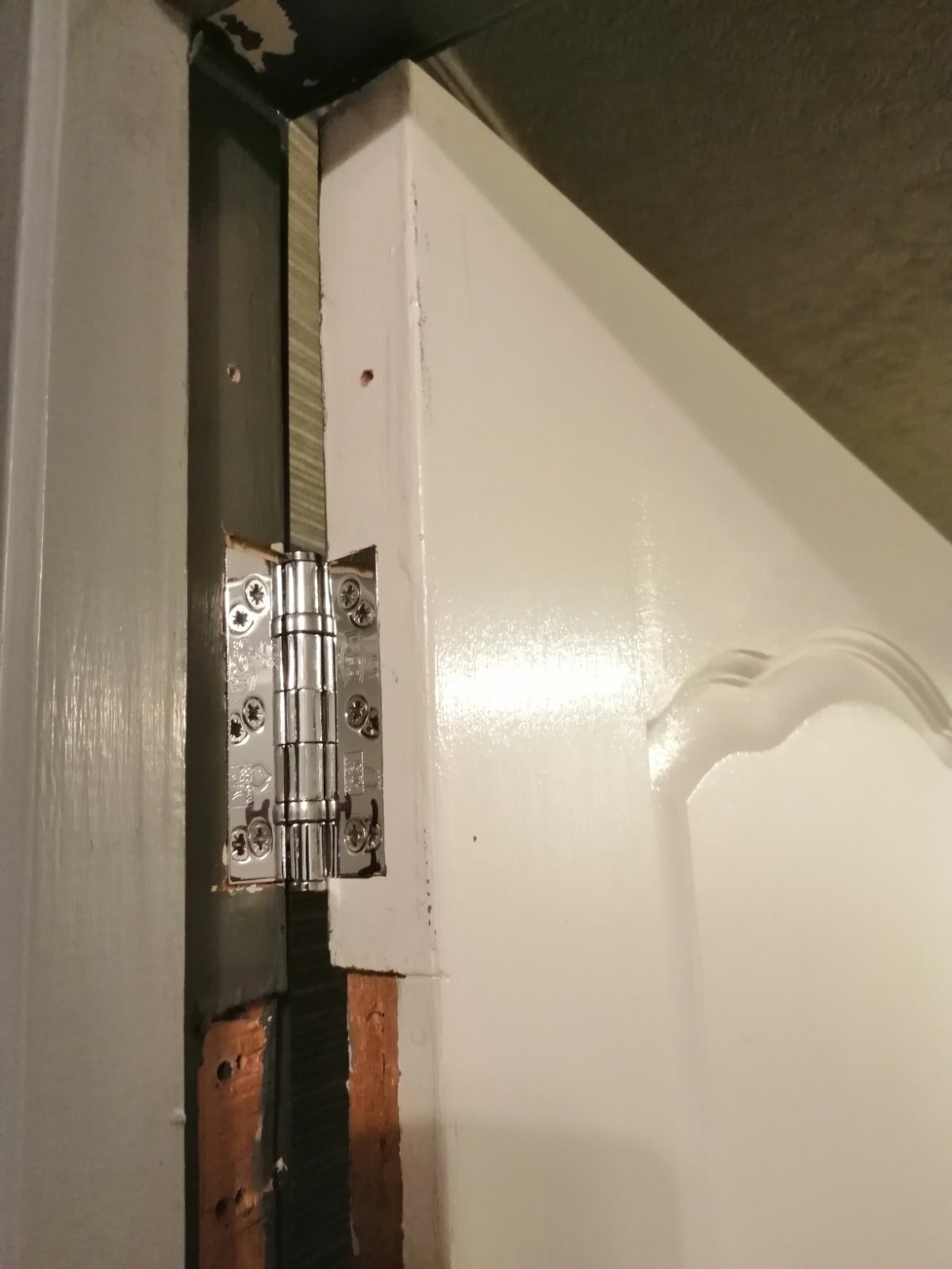

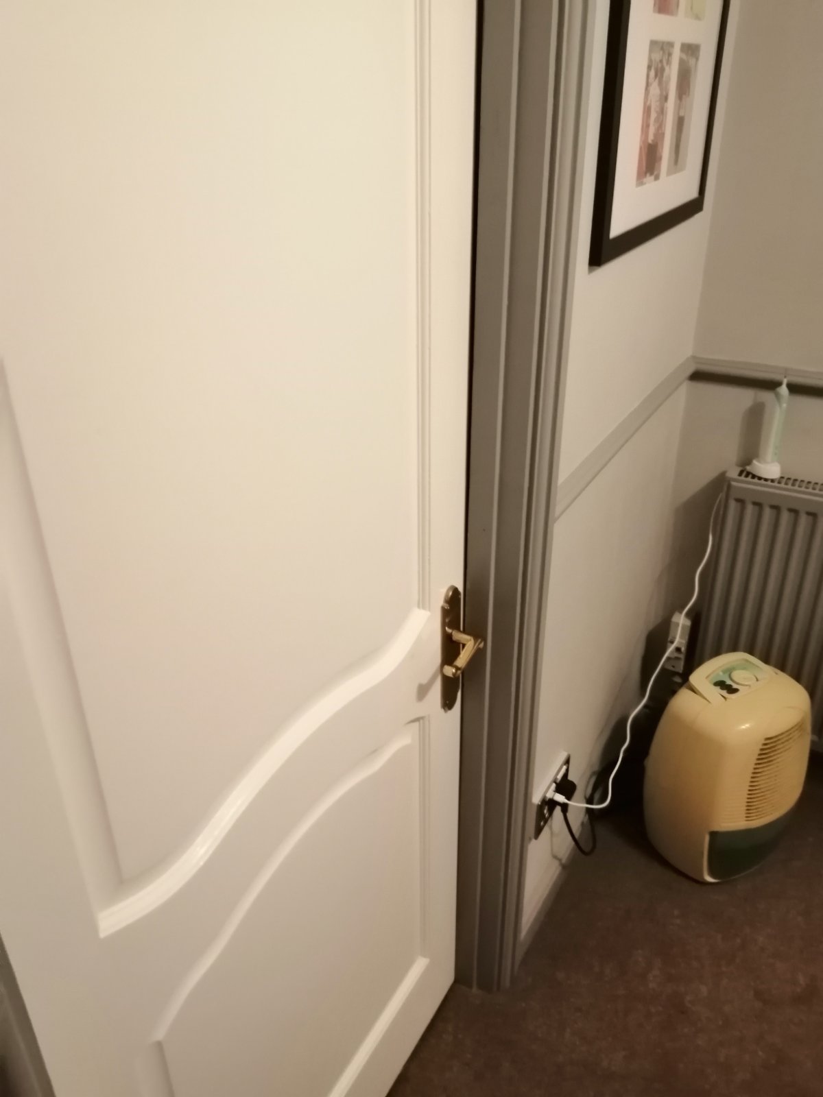

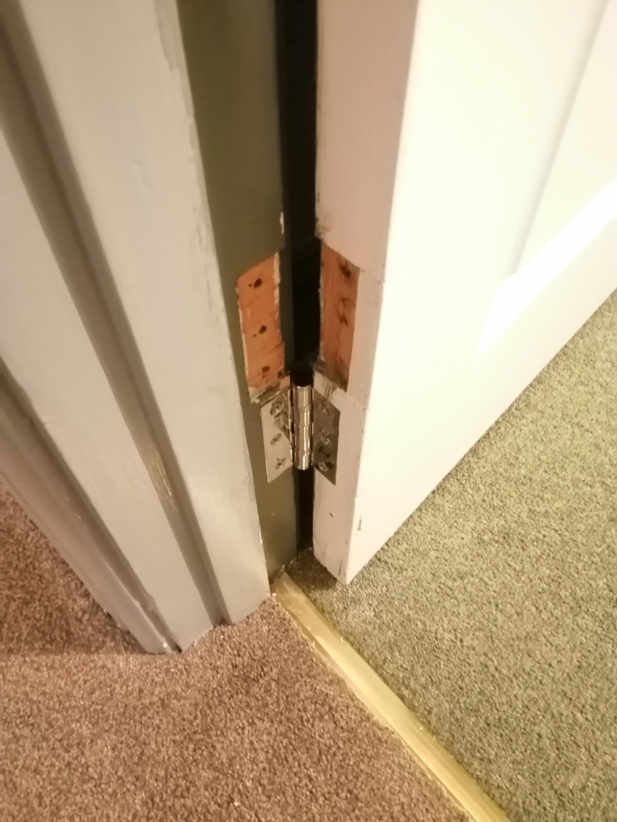

Hi all, I hope someone can assist with the following issue.
Due to having a new carpet fitted etc, I decided to remove a door for trimming, and at the same time fit new hinges etc as the door has never fitted well and always blinded at the hinge side and sprung open. I did pack out the old hinges to improve matters, but decided to fit new ones and recut the hinges on both the door and hinge on the frame. I cut btoth sets off hinge rebates dso the hinges were flush with the surface on both the frame and dc door in new positions. But the door is still binding. The door sits out of square with a larger gap at the top of the door srtop than at the bottom. The hinge leafs are 20mm and are on a bb hinge.
If anyone can assist I would be very grateful.

Frame or door are not squared.
You'll need to play with hinges position as moving the frame would be a much bigger job.
Hi johnny2007, thanks for your reply. I've checked the frame and door and it appears square to me.

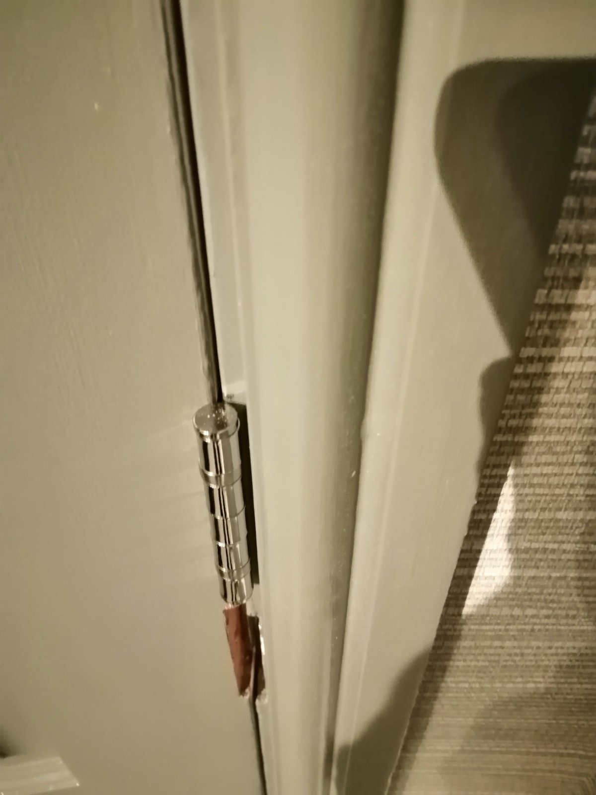

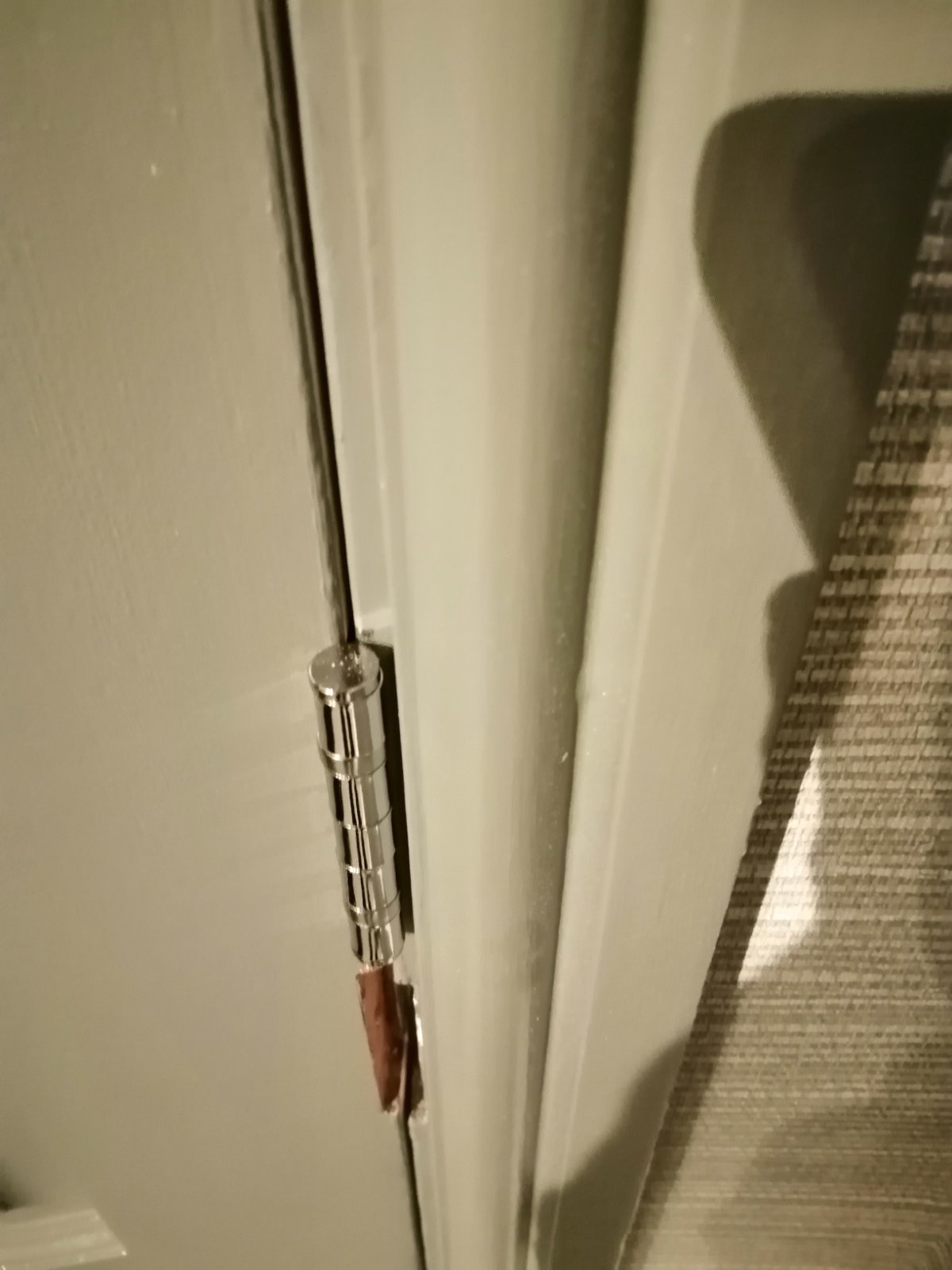

I think the top hinge maybe set too far forwards.
My concern is that the knuckle on the hinge is quite large. If I move the hinge back into the frame, will it cause issues with the door closing as it will force the door towards the latch side of the frame.
Is there a simple way to check if it is the hinge placement that's the issue.
Many thanks for your assistance it's very much appreciated
Best regards Glenn
Top hinge doesn’t look straight or flush or inline with lower hinge .Lower hinge looks too high .Both hinges should be in there original location .

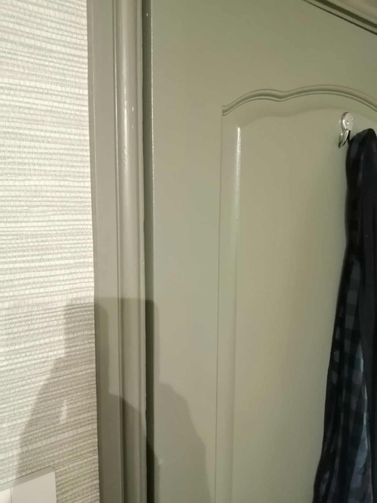

I can see a gap at the top in the picture where the door is closed.
Surely something is out of square.
Thanks Gents for your replies it is appreciated. I have checked the door frame and stops for plumb with a spirit level and they are all OK. The door isn't twisted either. The frame was checked with a framing square and is within tolerances.
Foxhole
I had to change the hinge positions for two reasons.
1. They were cut far too deep and the door was binding hinge side already
2. The door was 20mm out of square at the top running down from the hinge side, and as I had to trim the bottom to accommodate the new carpet, rather than leaving the top miles out, I squared it up and lifted the door up, so the door hinges were cut too high for the frame rebates anyways.
The top hinge is flush I routered it to get it flush.
I have lasered the hinges and confusingly the top hinge appears to be 10mm further into the frame than the middle and bottom hinges. So I am loathe to recess it any further into the frame, and are still concerned about the hinge knuckle size causing an issue if it's rebated deeper into the frame
I'm going to remove the top hinge and see whether that cures the issue. If it does then I know its the issue.
Do either of you have any suggestions what to do if the top hinge needs rebating further into the frame reference the hinge knuckle size.
Many thanks in advance for your assistance it's very much appreciated.
Best regards Glenn
