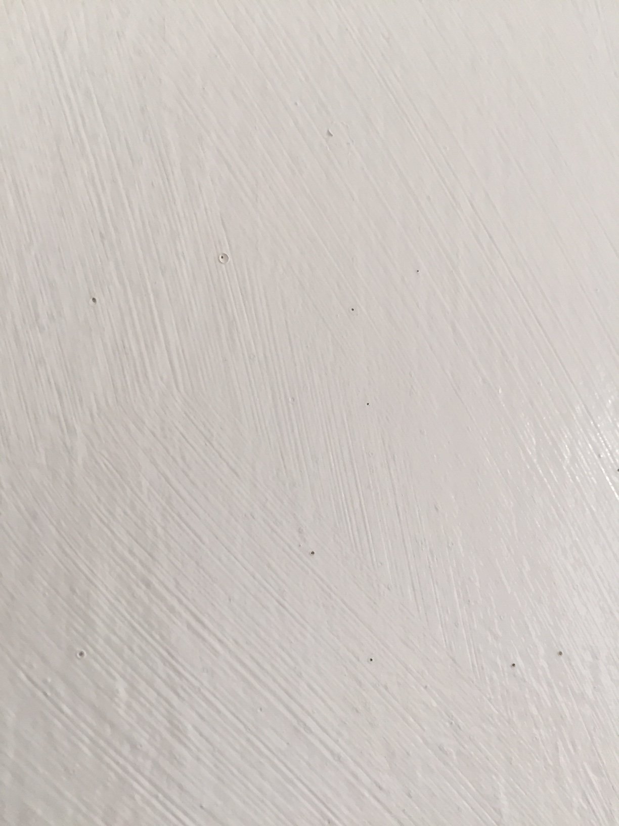

Here are some images taken today, each image is about a 4 inch section of wall to give you an idea:
This wall has a previous coat of what looks like magnolia matt emulsion (painted by previous owners). I washed the wall first with sugar soap and then rinsed, the new paint is Dulux one coat matt emulsion.
The treatment (Polycell 3 in 1 treatment for problem walls, looks like PVA) seems to have helped as it's not as bad but there are still tiny bubbles bursting through which will give a rubbish finish.
Does this look anything like your walls Cpplumber?
There are couple of obvious reasons for bubbling and cratering, which is what you seem to have.
It could be that not all of the sugar soap was removed as various surface contaminants, including sugar soap, can cause this kind of problem. This may not be the issue because, if you have sealed the wall with a product designed for such a purpose, you shouldn't still be getting the problem now.
I'm concerned that the actual paint you are using may be to blame - is it new or is it an old can that has been left laying around?
I can see that your image states you have used Dulux one coat emulsion, which has never been the best product on the market. It is really thick which leads me to ask whether you have diluted it and, if so, how did you mix the water in? Sometimes a mechanical mixer, or even just over-stirring can introduce too much air into the paint which will cause the bubbles - a little like mixing batter and cake mixture (not that I'm any kind of chef!).
If you can eliminate all of these possible causes, I would give the walls another clean with plain old luke warm water, apply a coat of Zinsser Gardz when dry, and then proceed with the painting.

The paint is new (bought in Feb this year) and completely agree that it's far too thick. I think I've learnt the hard way that trying to get things done quicker just results in a poor finish. It may well be 'one coat' but it's a really horrible gloopy textured coat, showing every stipple or bush mark. I didn't initially water it down, then watered it down later to try a thinner coat, but both produced the tiny bubbling on the walls.
The only walls that didn't react like this had a different colour/paint on them initially. All the walls with the same matt magnolia paint on them are having the same reaction. So to play it safe I'm going to strip off all the magnolia back to the previous coat (where so far I've spot tested on one wall and no reaction after the paint has been removed).
The worst thing is that in one room I'll be having to go back through the PVA, basecoat and magnolia layers now because of all my failed attempts to get round the problem.

Those look like fisheyes. Has someone sprayed Mr Sheen polish on the walls?
Fisheyes can be the result of silicone contaminates or the base coat releasing solvents.
I would be tempted to lightly sand and then roll some Zinsser BIN on to the affected areas. Leave it over night and then emulsion it
edit_---- sorry just read your post again regarding one coat paints. You could try rolling with the emulsion, let it go off a bit and quickly apply a wet on wet coat. They look like air bubbles that have burst.
