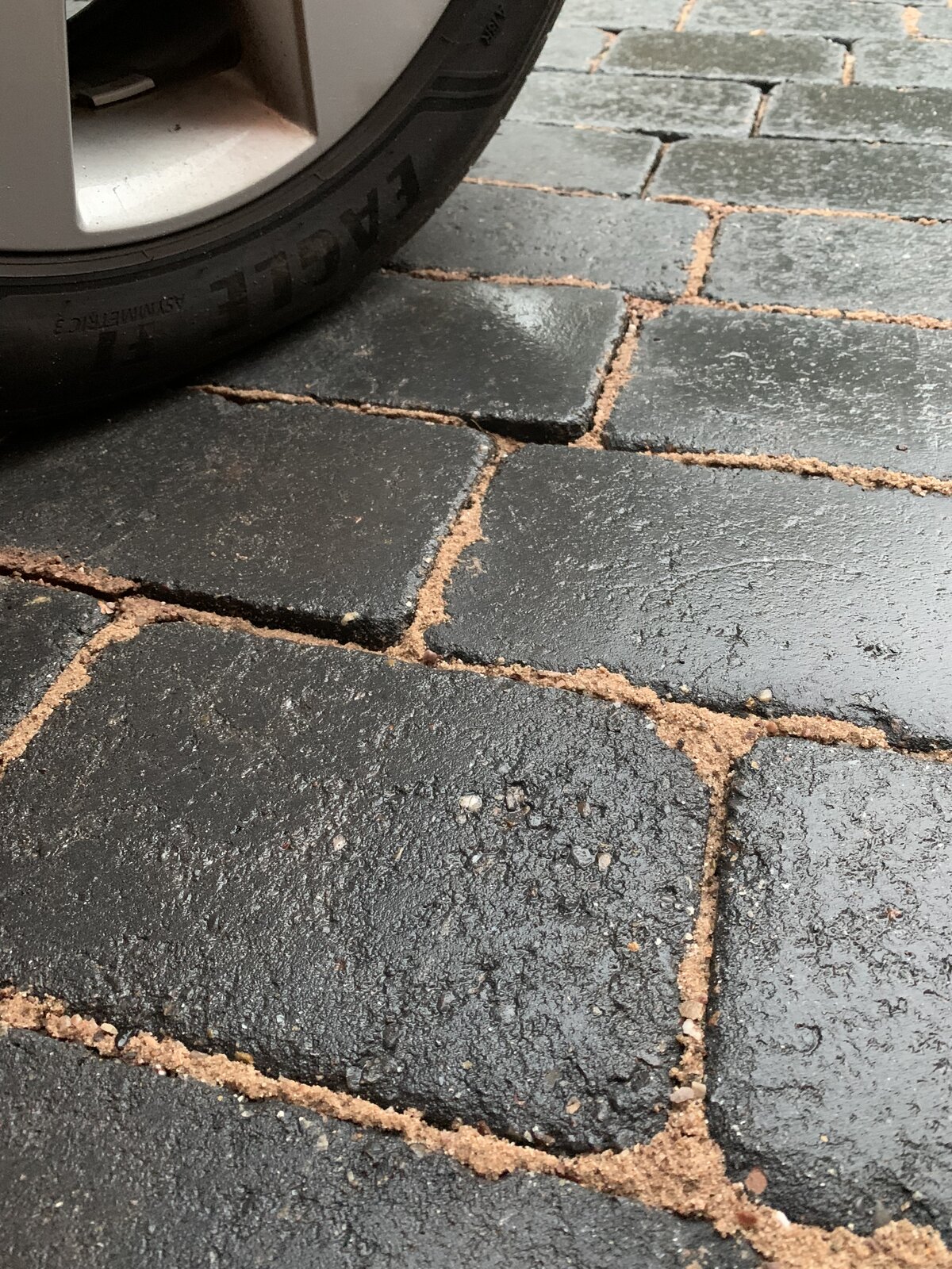

Hi- I’m going to get the contractor back but any ideas what could be happening here so that I’m better prepared?
Recently had a block paving drive extended and where I now drive, some of the blocks rock up/down slightly - this means that the sand then drops underneath so there are gaps between the blocks.
I can rock the blocks slightly with my foot which doesn’t sound right to me. Not sure if the picture shows it but where the tyre is, the blocks have been pushed down

Assuming the base has been laid properly and thick enough, there is a patch of sodden ground or base material, and the whole area of bad ground (to a suitable depth) and base should be replaced with dry stuff.
Don't just let them pack it, level it and then relay the blocks.
BTW, is that screed sand in the joints? o_O

Thanks all - it hasn’t been jetwashed - the sand between the joints (which was kiln dried) just seems to be falling down when the blocks rise up slightly. They seem a decent company so hopefully they will basically just do it all again to a better standard.

That's really the essence of whether they are a good company or not, their enthusiasm/reluctance to sort any problems out after the event ......
