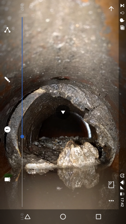

Today I had my old 3 inch waste stack removed, so a new 4 inch one could be installed and a new toilet connected up to it.
The 3 inch was connected to a 4 inch pipe at the base, so was expecting this to be quite a simple job.
However it appears as if there is an obstruction in the drain a few inches down (see picture). Any ideas what this might be, and if so, is there a way to remove it?

looks like slipped/badly made joint - £30 for set of rods and poke the obstruction out- then put a acess pipe in @ the bottom of the stack
Yup, looks like earth n stone has dropped in there through the split joint and is sitting in the pipe, can you dig that section out and make good the join before the rest of the stack is connected?

My two pee is that the join was never made, and what we can see is the old mortar flaunching that came right thro the joint because no tarred gaskin was used.
Water would have escaped and undermined the salt glaze causing the drop.
As advised above - its a dig out job.
I'd be cautious about jetting a break in a pipe before the repair or you could possibly cause further undermining. You might even lose your nozzle thro the break. I guess that its a site call.

Annoyingly the joint is under my path. Might have to get it dug up to get to it.
