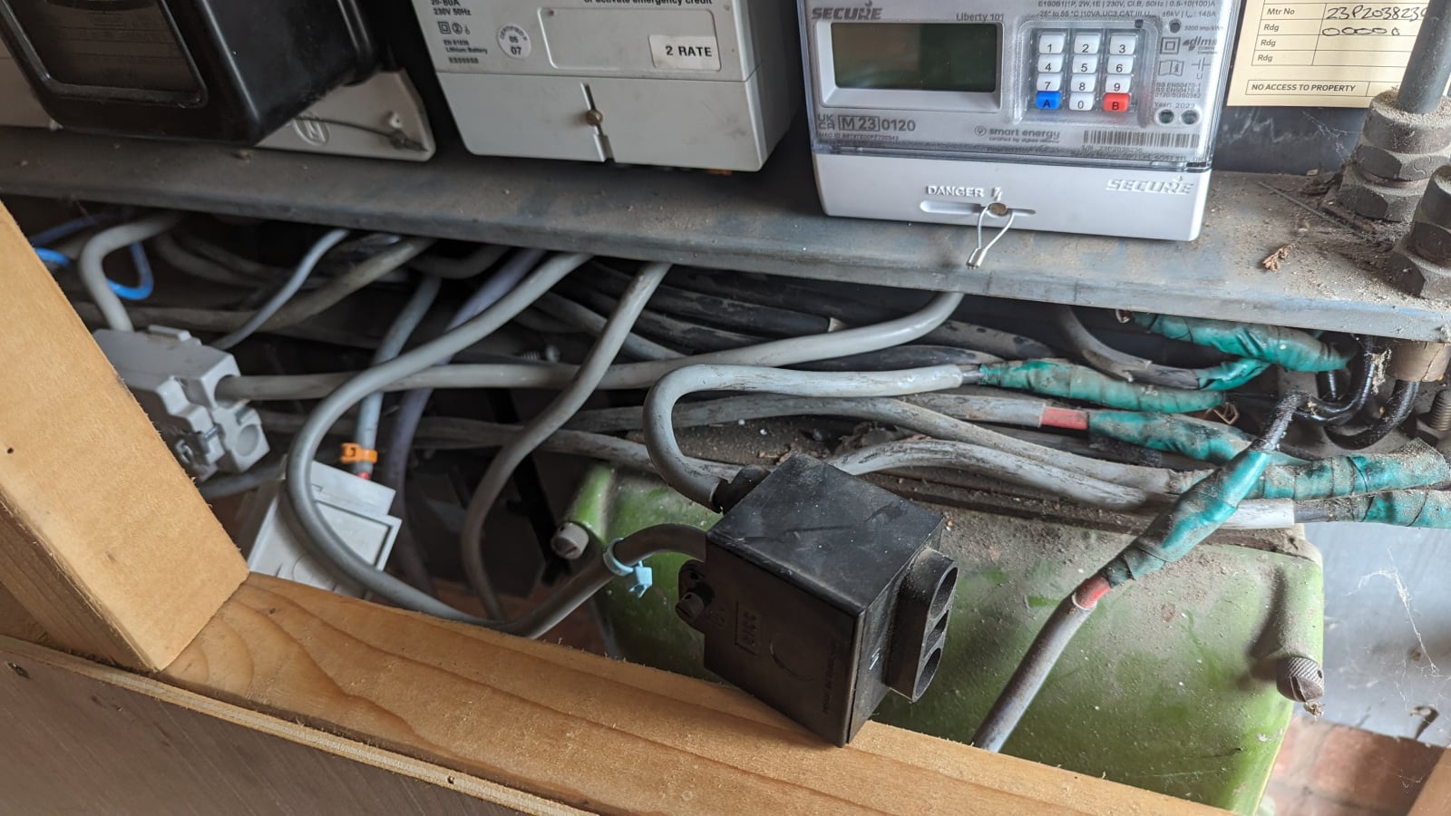

Hi everyone,
Looking for some practical advice from the sparkies on here regarding a messy communal cupboard layout that's blocking me from getting a smart meter. I'm a leaseholder in a block of 4 flats, currently stuck on an inconvenient prepayment key meter. I just want a smart meter fitted, but the physical state of the cupboard is stopping it.
Octopus Energy came out but flatly refused to touch the setup. The engineer's official notes say:"Abort Comments: No space for meter or blocks to be fitted. Bunched tails in neutral floating blocks. Multiple tenants would need to be taken off supply for the meter to be changed. Customer to contact the BNO. TECH CODE TASO13NC"

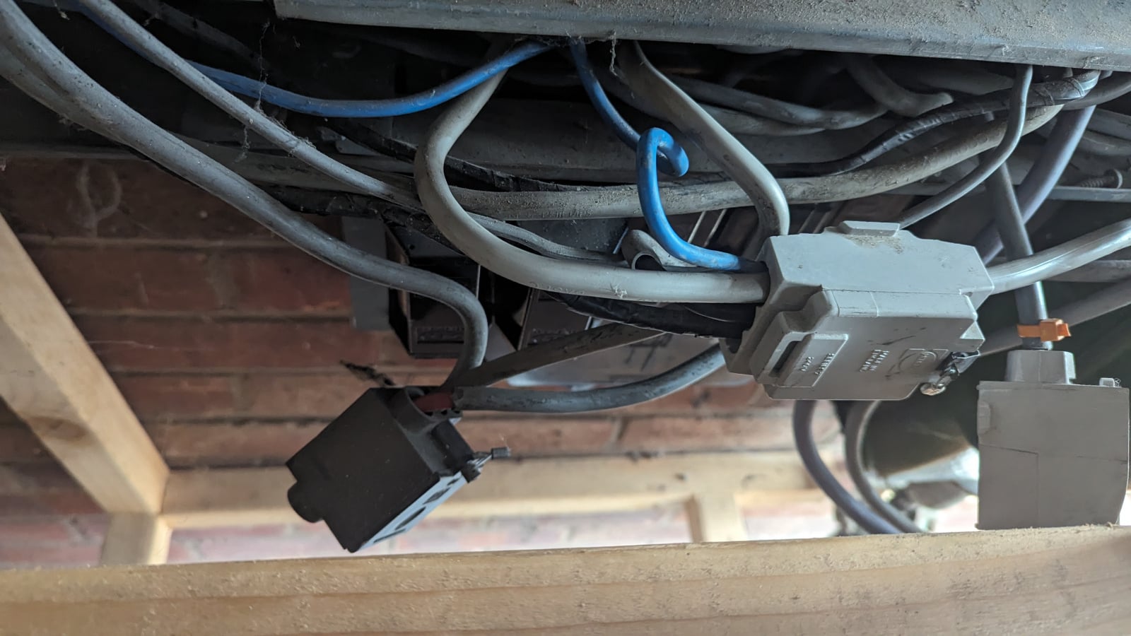

I've attached the photos of the cupboard. As you can see, the Henley blocks are completely free-floating and hanging by the cables under the meters, right past the main green cutout.
The property management company is dodging it, claiming that because there is no dedicated "landlord supply meter" for the hallway lights, they have no maintenance obligations for any of the wires.
I’m not looking for a legal fight with anyone, I just want a practical solution so I can finally get a smart meter fitted. My questions for the trade:
  1. Logistically, how does a job like this actually get fixed? Because it requires taking multiple flats off supply at the main cutout to safely mount these blocks to a backboard, can a local independent electrician request that isolation from National Grid, or does that application legally have to come from the building manager/freeholder?
  2. If the management company keeps refusing to get involved, is there any safe, compliant way for me and the other cooperative neighbours to privately hire a sparky to mount these blocks without triggering a massive grid headache?
  3. Has anyone dealt with these "floating block" deadlocks in flats before? What's the best practical route forward?

In addition to the issues you have mentioned, one might also worry about what is going under those various bits of green tape.

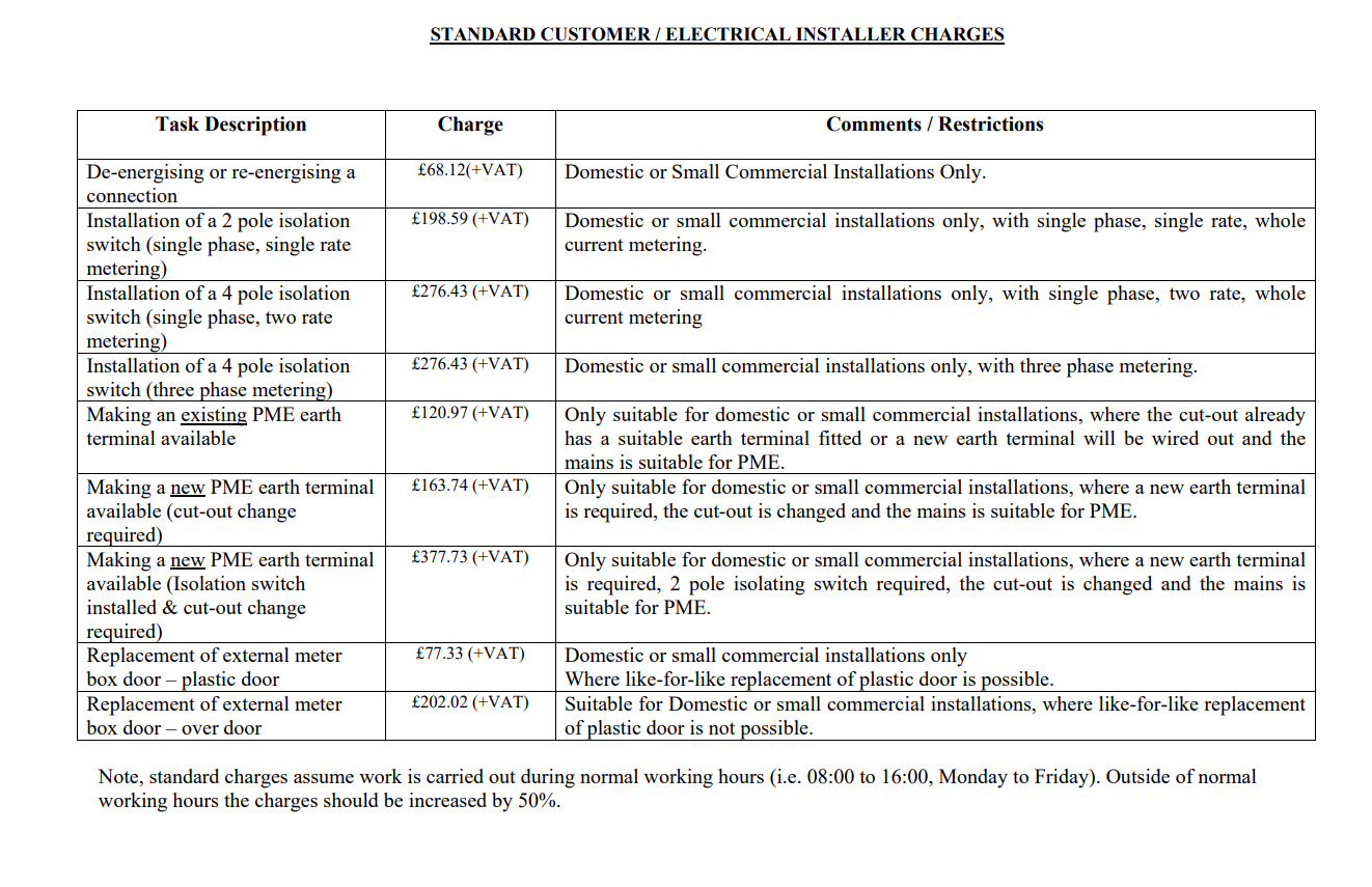

They did say they could "try" and fix it for a very large amount of money close to £1000 a few years ago but since then not much.
I was thinking, if I pay them to fit an isolator does that mean they would need to tidy it up at the same time?

Hmmm. It's obviously difficult. Looking at Octopus's 'Abort Comments', perhaps the most problematic is:
"No space for meter or blocks to be fitted. Bunched tails in neutral floating blocks."
One wouldn't really expect them to be happy with those dangling blocks (not to mention the 'green tape issue'!), but if there's no space to fix them to the board, and not enough space on the board for the meter, then it sounds as if some fundamental changes would presumably have to be implemented in the area before they (or anyone) could do anything?

It's an electrical hazard that should never have been allowed to get into that state. Gross negligence by the management company who have obviously never had any of it inspected at any time ever.
The connector blocks don't need to be fixed to a board or anything else - they shouldn't be there at all.
From the very limited photos, all of the wiring between the fuses and meters needs to be removed and completely replaced with new.
All of that timber framing / panelling in front needs to be permanently removed.
Add photos of a wider view of the whole area preferably with all the panels removed if you want further advice.
