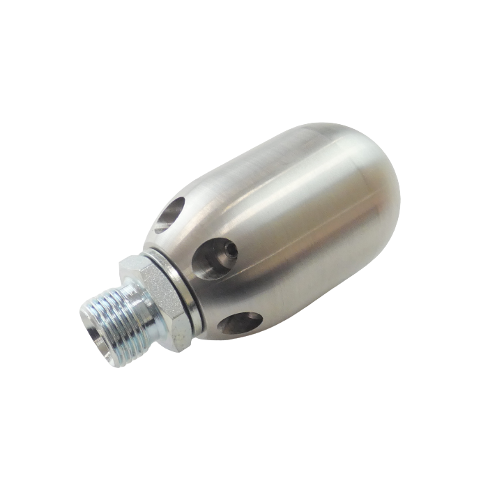

What is a Jetting bomb?Need to ascertain where the issue is before doing anything. You can plunge the Pan all day long, but if the blockage is a way downstream all the effort you're trying to create plunging the pan has long since disappeared before it even reaches where its needed. Ditto chemical, boiling water and most of the other claimed 'cures' for the issue, most of which only have any effect when the blockage is actually in the pan itself.
If Plunging the pan doesn't solve the issue, then the tried, tested and most superior solution any day of the week is mechanical force of some description to break up and dislodge whatever is blocking the pipe, and that means rods or a jetting bomb. If you're not confident doing that, get someone in who is. (Avoid anyone with A1 or Pronto in their business name, and/or in a fluorescent van though unless you've VERY deep pockets.)
Wooooooooooooooooooooooof!Dynamite will unblock it...
I do have one. I call it the thingy bob.
