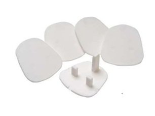

You might want to consider these as an alternative. £1 for a pack of 5 from The Range... Other suppliers are available ;)
Features​
  • Prevent children from playing with plugs
  • Includes five covers
  • Great for any home
Information​
A good way to prevent young children from playing with plug sockets, this Pack of Five Safety Socket Covers protect from fingers getting caught and causing injury. With five included in the packet, these covers are perfect for covering up prominent sockets around your home
They would be an easier way to bring the socket back into use too.
No no no and no : banned by Scottish gov and Scottish NHS some years ago. Eventually banned by England and Wales NHS and eventually not recommended by Ofsted.
Read fatally flawed dot co dot uk.
They should never ever ever be used
Apart from the risk of shock, they might pull it out and swallow it!
Really surprised from you, you're normally quite clued-up. This is now quite old
BEAMA (British Electrotechnical and Allied Manufacturers Association) has published a statement saying:
“BEAMA strongly advises against the use of socket-outlet ‘protective’ covers.”
Children cannot poke things into British sockets - they have built in automatic shutters for protection.​

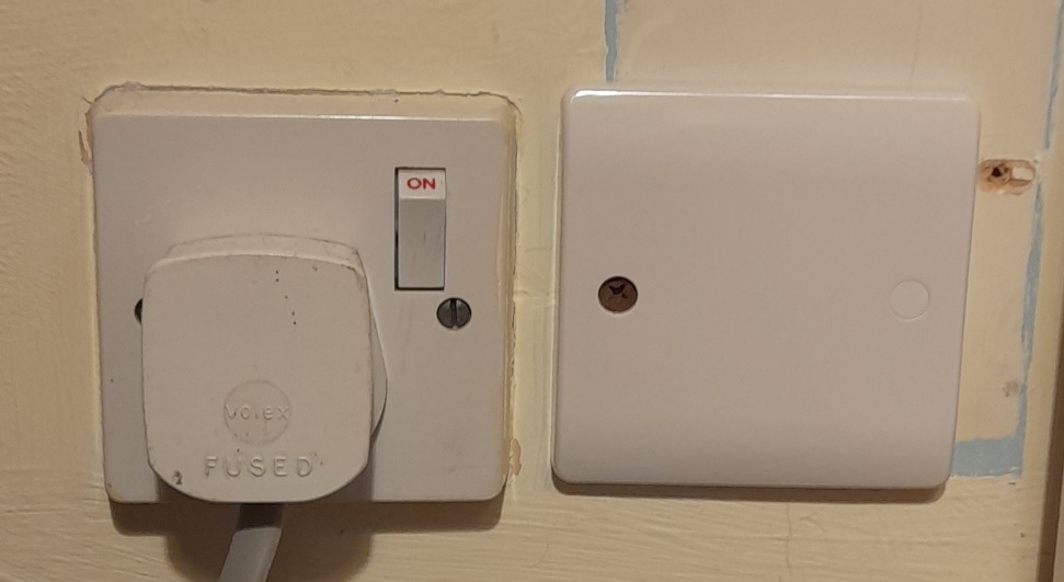

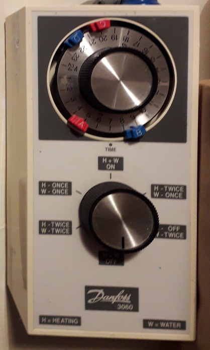

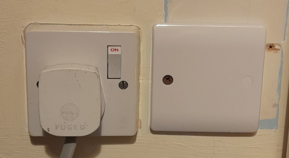

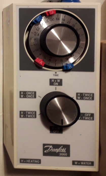

But basic rules, if not marked BS 1363 then it should not be put into a BS 1363 socket.I have fitted a faceplate with a simple block connector behind it when I wanted to remove sockets, Blanking plate.jpg actually the wires behind it are only 12 volts DC it was for the central heating programmer 1766697514148.png now replace with Nest Gen 3 but that's another story, the plate shows where wiring may run.
