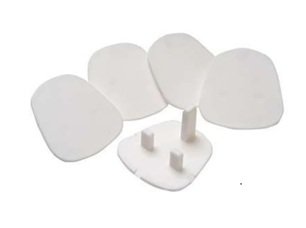

You might want to consider these as an alternative. £1 for a pack of 5 from The Range... Other suppliers are available ;)

the plug inserts maybe ok if covering up the socket so children CANNOT reach - but a lot of research says these things are dangererous , i removed all mine and stopped using
google them and see reports from various sources including which

I think not.....​
Interesting, I wonder why they are still so readily available and selling then has not been banned in the UK :unsure:
I wonders how long it would be before someone posted this
F*** no. All those things do is turn sockets into a game, and provide an easy way for kids to defeat the very good built in protection gate that seals off the live terminal
Simply turn that thing upside down and push it into the earth pin hole to open up the live, then let a child stick a finger/small metallic object in
Anyone considering use of those things needs a reality check
No one has championed the cause hard enough
And people are thick/don't know how sockets work
I have repeatedly demonstrated to a local churchs officials how easily these ****ing things cause problems by partially inserting the earth pin upside down then giving it a thump which typically pushes it right in and snaps off. Each time they go round and dispose of them but within a few months they get replaced.
