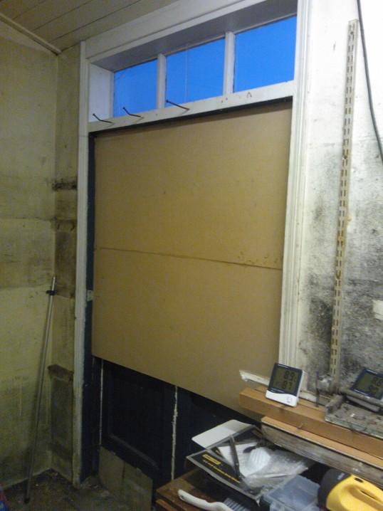

Put a couple of photo's below. First photo shows a general view of the door from inside.

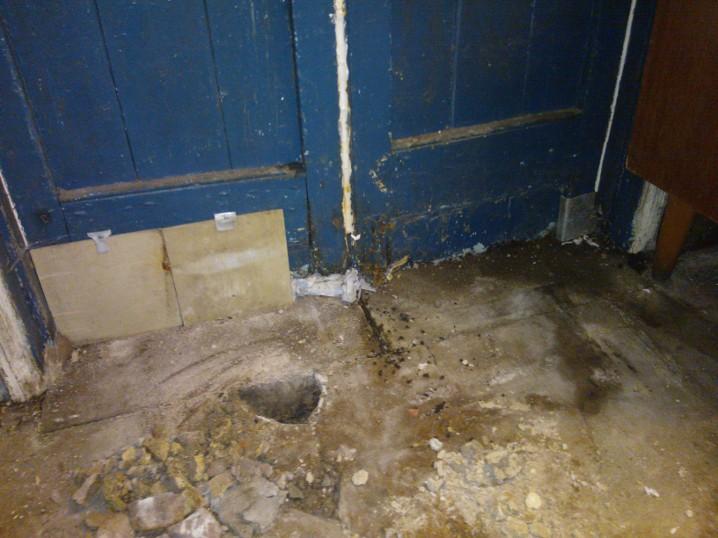

Next photo shows the bottom of the door and the two concrete blocks. So unlike a normal external doorway where you have a row of bricks at the bottom which the door frame fits in to, this door way is really just a gap between two walls, with two concrete blocks in the floor. The gap between the two blocks currently seems to be filled with soil and water comes in through here.

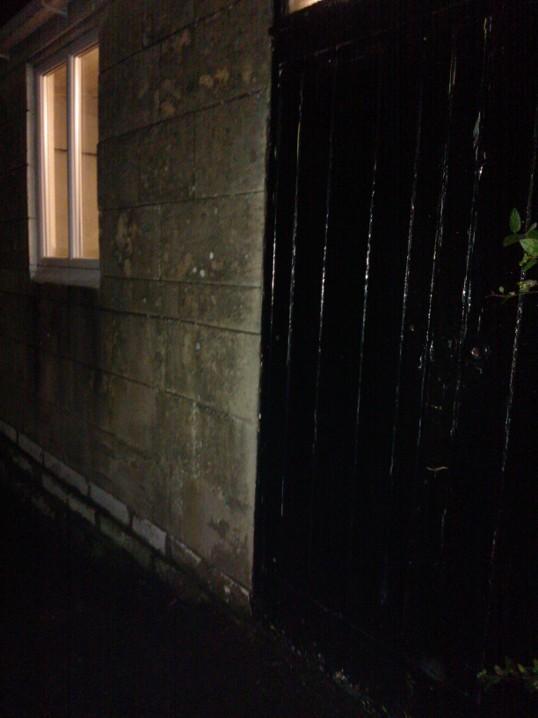

Last photo shows the door from the outside, as you can see the external ground level is the same level as the conrete blocks, so water at the moment can just come in straight under the door.
So back to the original question - should I lay bricks on the existing concrete blocks and risk possible damp getting in, or lift these and lay a bit of a foundation and build on top?
On a side note, I do plan on putting a layer of DPC in the new wall to link in with the existing DPC on either side, although not sure how beneficial that will be.
