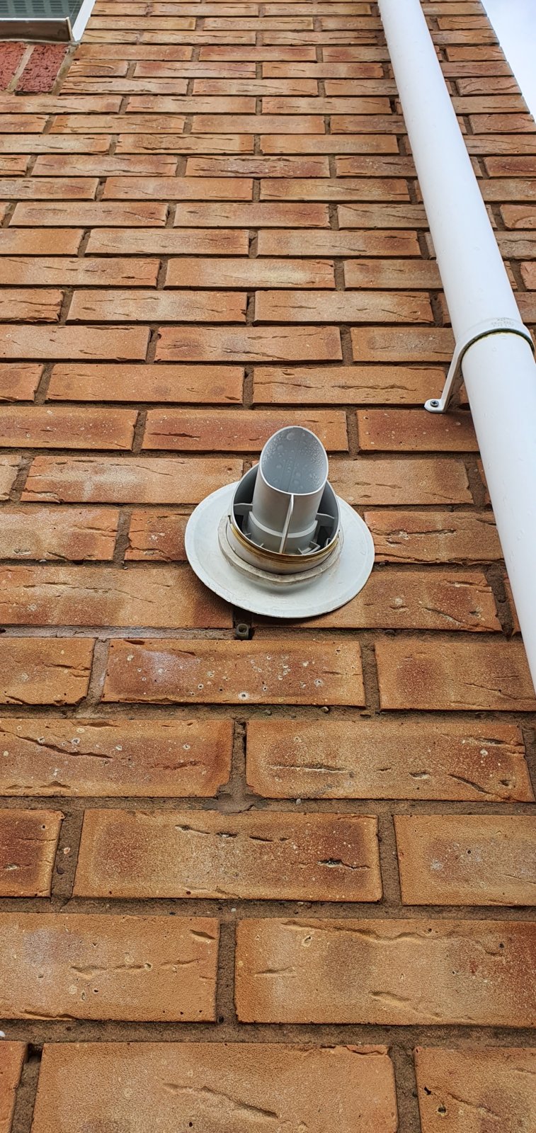

Hello all
During bad wind and rain out boiler flue lets a lot of water in which eventually drips out of the bottom of the boiler and into the washing basket sitting underneath.
It is a decent condensing type boiler which was signed off as very effiicent on its last check.
My question is can I buy any kind of hood etc to place over the flue to prevent at least some of the water returning into the boiler and leaking all over the place?
photo attached.

liam548, good evening.
OK Not really my area [Gas boilers, that is] but? the collar surrounding the flue is not hard up against the external wall especially on the left hand side? there is a large gap?
The flue itself on the image posted does not appear to be square through the wall, is it an an angle? or is is a quirk of the image?
Observation? there are a lot of various sized gaps in the mortar on that wall??
The recessed pointing may assist rain water running down the wall to get "behind" the collar??
As I recall, the gap between the flue terminal and the surrounding brick "should" be sealed with a mortar, do tou know if yours is sealed??
Ken.

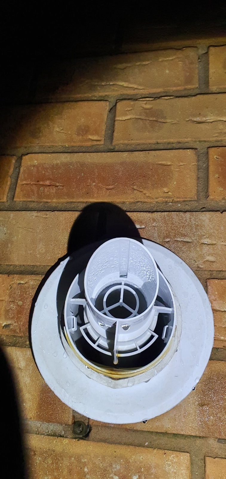

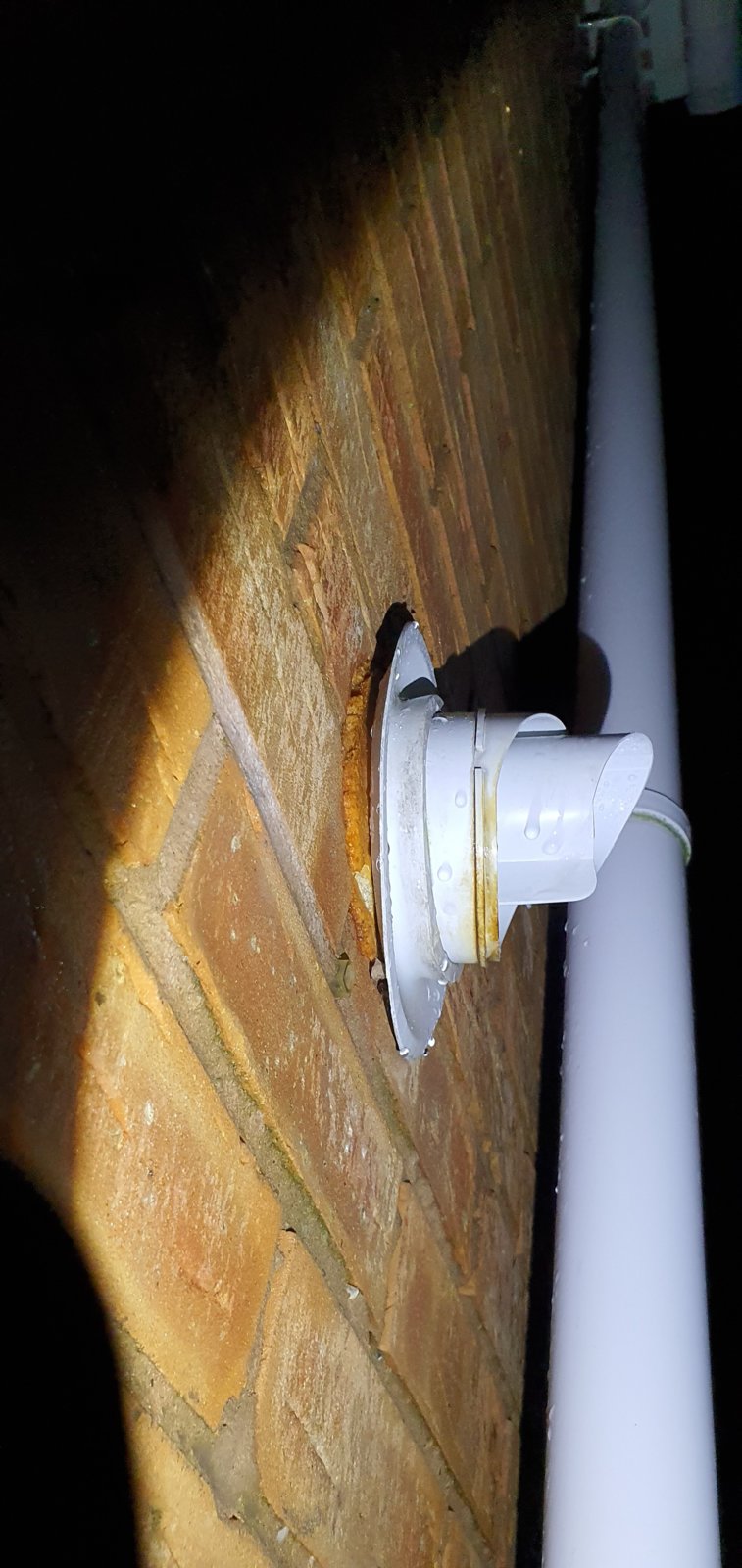

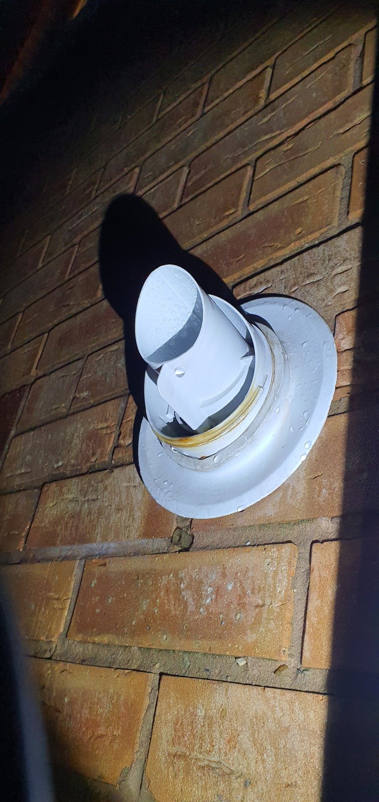

thanks for the reply Ken.
You are correct in that the flue seal isnt flush on the left, the actual recess is filled with the yellow expanding foam type. The flue also slopes slightly upwards to make the problem worse although having read online that condensing boiler flues are supposed to be like this to stop the acidic water escaping and hence it can run back inside and into the condensate pipe.
"As I recall, the gap between the flue terminal and the surrounding brick "should" be sealed with a mortar, do you know if yours is sealed??"
Ive just been outside (in yet more rain!) to get a few more photos to show you..
The end of that flue looks like it’s rusty from condensation from the products of the combustion process. I went to one the other day (similar to yours) and I have ordered a plume kit for my one. Not sure if that’s going to resolve the issue, but it’s not my money (I work in social housing).
