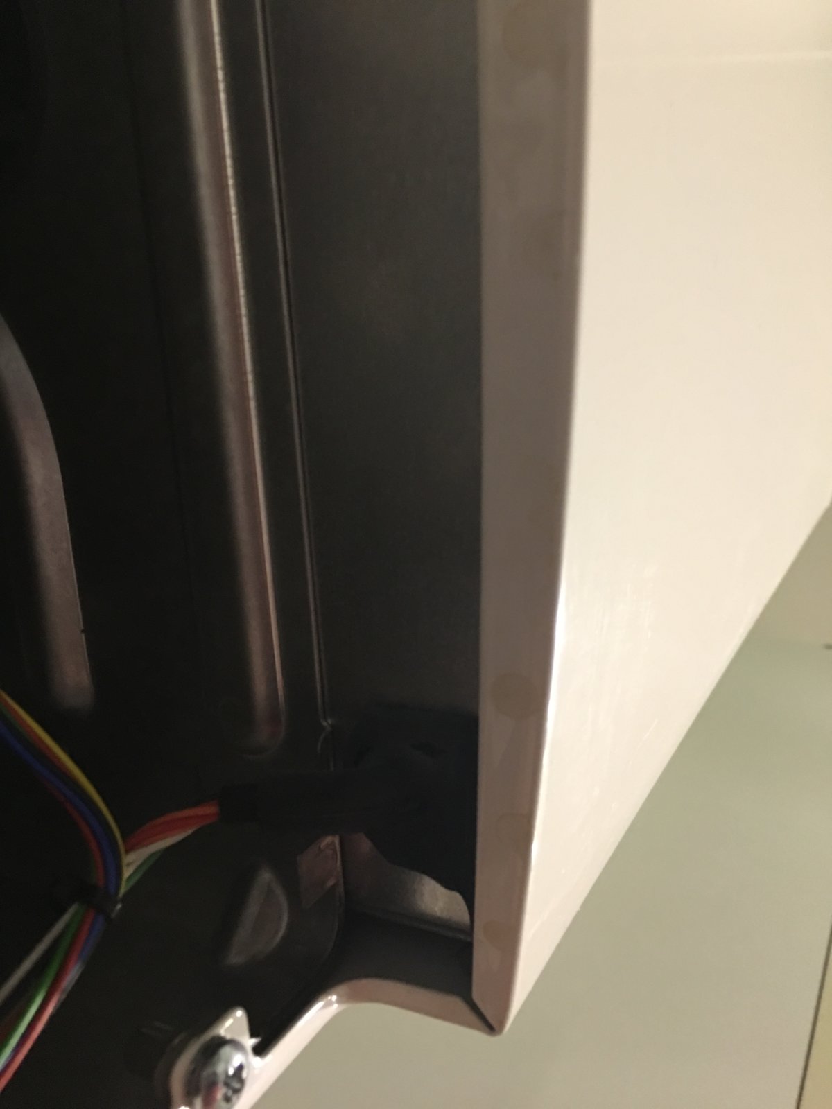

I have a worcester greenstar 28 cdi boiler that is about 4 years old and when we got home today it was showing code EA 227.
I went to turn it off and on again and discovered a small amount of water underneath the boiler (a film about the size of a fiver).
I removed the control panel hoping it was a nut that needed nipping up or something but the water was coming from the sealed bit of the boiler so I gave up, put the control panel back on and turned it on again (it's working now).
I have boiler cover so was going to call them but is there anything that it is likely to be? My GF also said it sounded really noisy this morning.
I've attached a pic of where the water was coming through (around the cabling) and you can see some stains that look like water on the bottom of the white part of the case.

that white pipe going outside from boiler where is it terminating ?

The condensate pipe? It goes in to a drain outside, no evidence of any leak from it.
But is likely blocked, anywhere from HEX to drain and is therefore competent person territory, as it is part of the flue system.

Aaah now I understand.
Is this something that should be checked /cleaned as part of the annual service?
Yes it should be checked on a decent service.
Obviously if it's your drain pipe blocked you can do it yourself, but the trap built into your boiler is certainly safety critical as stated above. That's what stops combustion gases escaping from the chamber.
