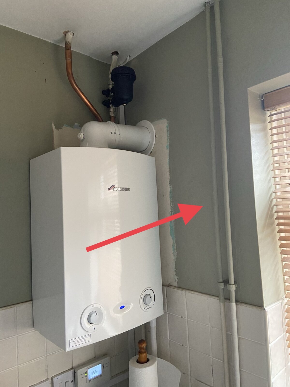

Why not have had boiler up higher and right to do away with snorkel,then filter underneath.Sorry.Already suggested

Take the PMK out at a true 45 degree then vertical. It will look a little better

As for the inside it only needs 2 pieces of board joined in an L shape rested on top of the boiler and painted to match the walls and you won't see any of it. Putting the filter under the boiler would look far worse as it has to be low enough to get the lid off.
The more I look at the more I am disappointed. If it is relocated to the front wall, raised above the tiles and the pipe work reconfigured it would become I neater job I think. However that would require the flue to be drilled again. How would the existing flue hole be covered externally?

The more I look at the more I am disappointed. If it is relocated to the from wall, raised above the tiles and the pipe work reconfigured it would become I nester job I think. However that would require the flue to be drilled again. How would the existing flue hole be covered externally?
Proper job,replace the bricks.
