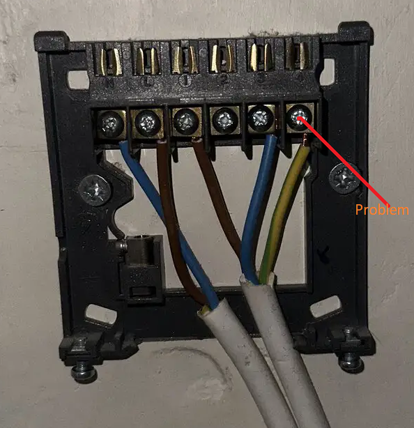

On another post today View attachment 325142 this is typical of Plumbers doing electrical work, and if you don't inspect and test, then the fault becomes yours.
As limited as my understanding may be - the only issue I see with what you have highlighted as a 'problem', is that the G/Y wire is unsleeved.
As you know, the regs aren't retrospective, and the oversleeving of G/Y, was only explicitly forbidden in Amendment 2...
514.4.2 It is no longer permissible to oversleeve the green/yellow protective conductor in a multicore cable to use it as a live conductor.
...and yet you don't list the blue S/L wire as a problem for being unsleeved, or the G/Y being cut short from the flex carrying the L and N, when it should have been neatly parked in the earth terminal.
Indeed - plus, I suppose, for the pedantic, a little bit of visible biut of copper in that wire.
Very true - but what eric illustrated (a G/Y-insulated conductor used as a live one,but without any over-sleeving) has never been compliant.
All true (and both so common at light switches) but, at last in my opinion, far less naughty/worrying than a G/Y conductor used as a live one,without any over-sleeving (which may well have been permitted when that was done).

But this is after a full stop, so it has never said you can use the bi-colour combination green-and-yellow if over sleeved with another colour and part of a multi-core cable. What Amendment 2 did was to clarify this. I have not checked with 16th Edition.
I do find clarification is a problem, as this means if read wrongly in the past, then the item is non compliant, the old does not comply coding for PIR/EICR has been dropped, and all we now have is potentially dangerous, however I would say a bi-colour combination green-and-yellow wire used for a live wire is potentially dangerous, so is not satisfactory.
